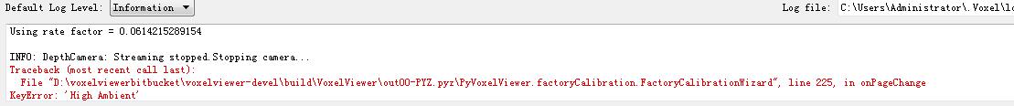

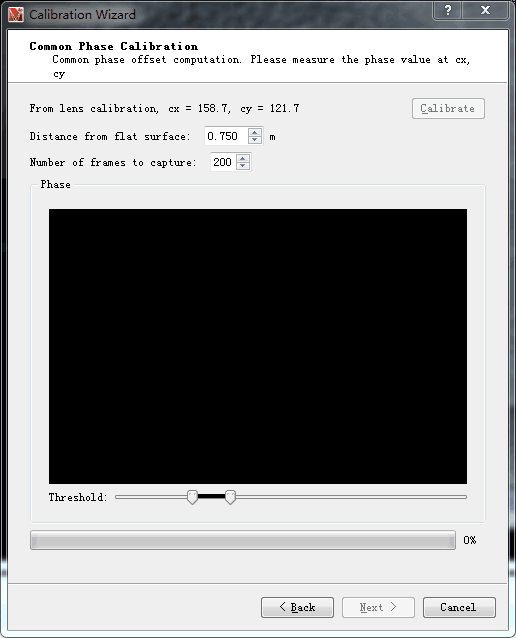

I meet a question when I calibrate my OPT8241 . When at the common phase calibration, there is a error. How to solve this problem? Thanks.

Please use "Calibration Wizard" from Camera Profiles to Calibrate the Camera. Do not use Factory Calibration Wizard
