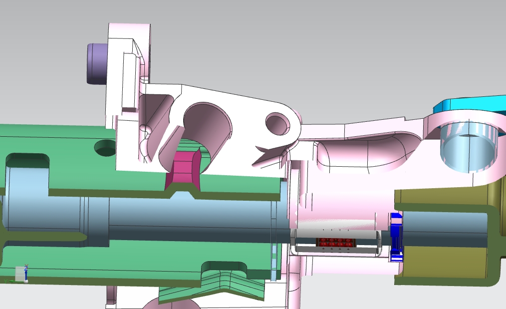

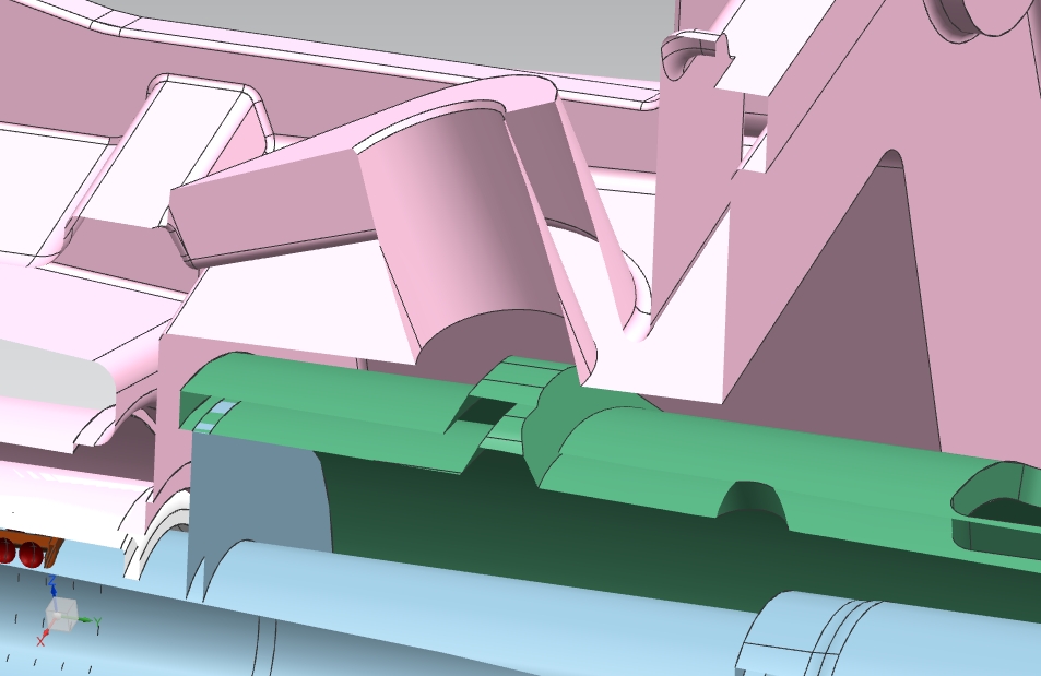

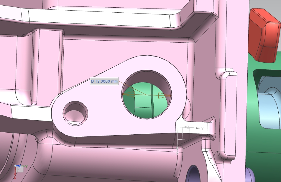

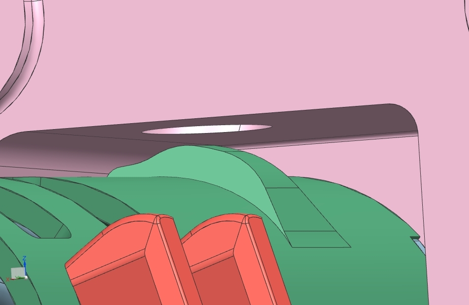

I need to sense the stainless steel target in my project, which i am doing with LDC1312. The target is is gear position sensing
which has three gears and i need to sense three positions. There is a 12mm hole through which i need to sense the movement on
the other side as the gear moves the amount of metal in front of the hole changes which will reduce the distance between target and
the hole. I am attaching the images for reference. The whole material is of stainless steel so i want to avoid the interference caused by
material in pink and want to sense only the green colored material.
Please tell me what configuration is necessary to calculate the count in register 0x00. Also i need a difference in count when the steel
is more and when it is less.
Sarang
  • Hello Sarang,
    This application looks reasonable, but there are a few details needed. I assume you plan to place the sensor into the viewing port.
    1) How far will the gear be from the sensor?
    2) How high are the gear bumps?
    3) How quickly do you need to sample?
    4) Do you need to only monitor while the shaft is rotating or do you need to know when the teeth are aligned with the sensor?
    It looks like a 10.5mm diameter active area sensor (this gives you edge clearance on the sensor so that the sensor PCB can fit into the tube) with 330pF sensor cap should work quite well. Using 0.125mm trace/space rules will allow 19 turns, and with a 2layer, 1mm thick PCB you should have a pretty good sensor for this application.

  • Hello Chris
    The shift in gear will move the green portion which acts as a shaft to the gear so there are
    three gears the movement will be approx 45 degrees(for first to third gear). For the queries:
    1. The sensor will be fitted in the pink hole at the end sensing only the shaft(in green).
    2. The bumps are approx 6.5 to 7millimeter.
    3. The sampling should be done as the gear changes so as far as i am concerned with the
        timing it will require in between 1 to 15 msec(or should be updated as gear position changes).
    4. I only need to sense the shaft positions.

  • Hi Sarang,
    Please clarify when you say that the sensor will be at the end of the whole. Will the sensor be at the end closest to the shaft? What is the expected distance from the sensor to the shaft? How high do the gear teeth protrude above the shaft?

  • Hello Chris,
    Yes the sensor will be close to the shaft, the distance of shaft from sensor will be 1.5mm for the green shaped dome and
    the plain surface of shaft is 3.45mm. Also i have discussed with our PCB team few queries are there:
    1. The 19 turns on the coil are per layer or adding up both layers.
    2. how much should be the sensing area on the 10.5 diameter coil.
    3. 0.125mm trace/spacing - how does it fit in 10.5mm diameter? as 0.125*2=0.25
        19/0.25 = 76.
    I have tried the measurements on webench with 19 turns per layer it requires a diameter of 15mm.
    Sarang.

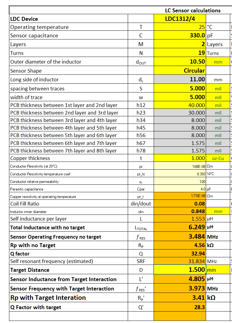

  • Hello Sarang,
    It is 19 turns per layer. The outer diameter of the outermost turn is 10.5mm; this should allow you create a 11.5mm diameter PCB which will fit into a 12mm hole. A 0.125mm trace/space is the same as 5mil.
    The webench sensor designer wants to optimize the sensor to have an inner diameter of 30% of the outer diameter; this produces the highest Q sensor, but for many applications it is not a necessary optimization. I have used the LDC tools spreadsheet to calculate your sensor as:
    ChrisO

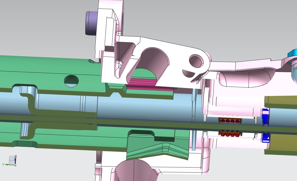

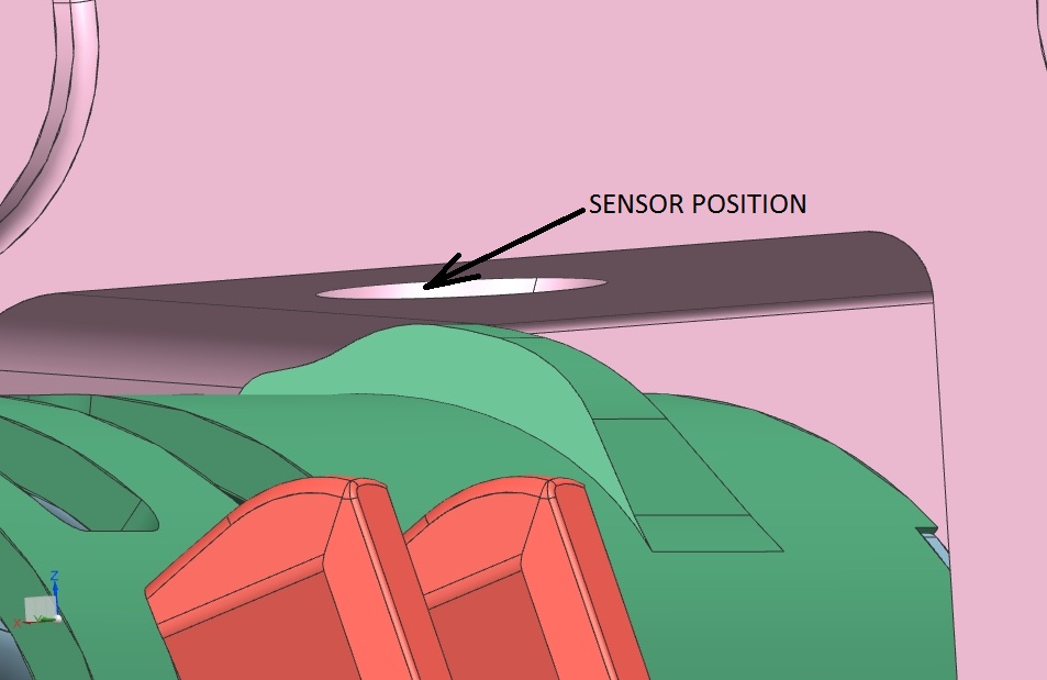

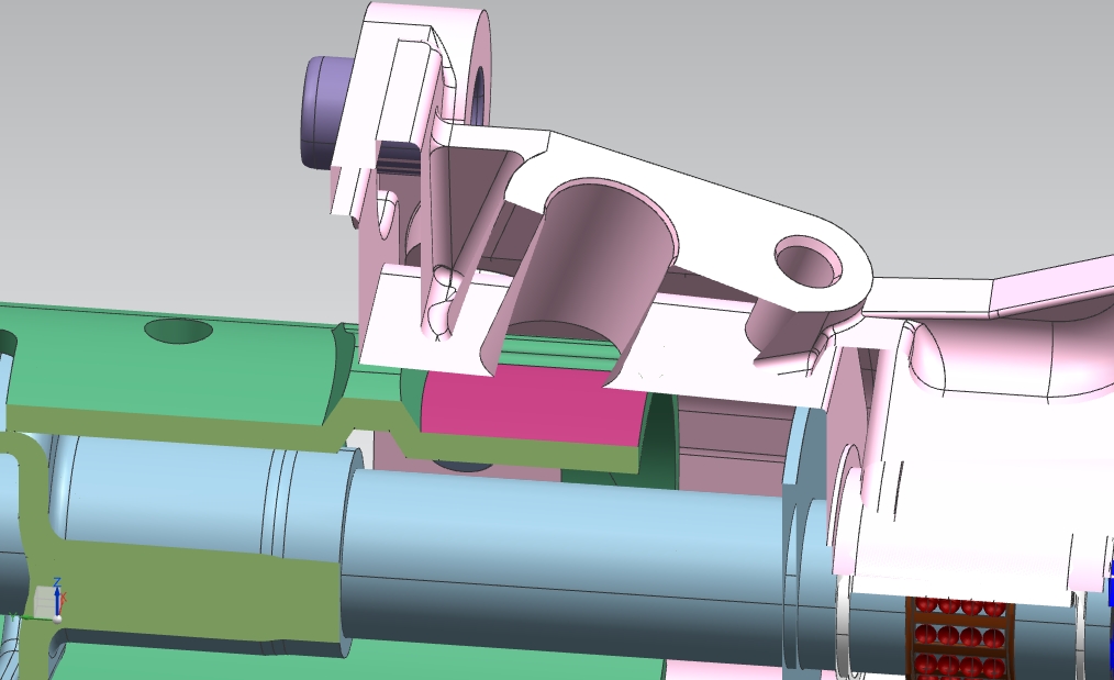

  • Hello Chris
    I am attaching the reference images for sensor position and what positions are to be sensed, when the shaft moves the respective
    purple colored area will be in front of the inductor. The inductor is place horizontally with respect to the drill hole, so the winding are facing
    the sensing area.
    The different sensing positions are as follows:
    Sarang
  • Hi Sarang,
    While LDC can use either wire wound or PCB inductors, I would recommend a flat spiral PCB sensor if possible. In general, wire wound inductors have larger unit-to-unit variations higher inductance, and lower SRF.
    It looks like a PCB inductor is viable for your design.
    ChrisO
