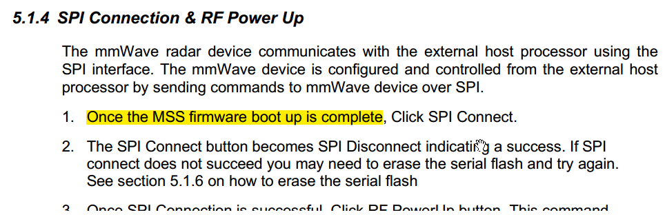

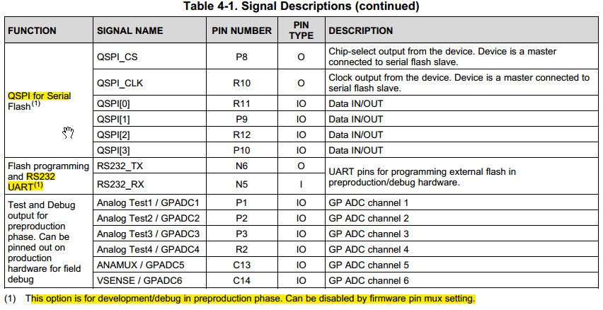

    The RS232 port of AWR1243 must be used??
    Q2:
    the firmware is download by RS232 port,how can it be disabled by firmware pin mux setting?

    1. The reference you posted 5.1.4 SPI Connection & RF Setup is in reference to our RadarStudio GUI tool which is a radar performance GUI meant to run with our evaluation boards. Radar Studio assumes that the radar device on the target evaluation board has been set into "debug" boot mode.
    2. From the AWR1243 datasheet, the device currently supports three different boot modes:
    For development purposes, the UART image loading is useful for quickly loading a newly build image set directly onto the RadarSS MasterSS memory. But right now we only support this with our evaluation kits and Radar Studio.
    For customer custom board usage the Flashing Mode and the Functional Mode work together
    • Flashing mode enables the use of the TI Uniflash software to flash a new RadarSS image and MasterSS into QSPI boot memory
    • Functional mode loads the images out of the attached QSPI boot memory

    I will find out where the pinmux control is documented to allow for you to disable the RS232 pins.
    Pinmux control is determined by the AWR1243 firmware included in the DFP. Please reference the DFP AWR1xx_Radar_Interface_Control document for a description of all available interfaces on the AWR1243. This is included in the Device Firmware Package (DFP) here: http://www.ti.com/tool/mmwave-dfp
