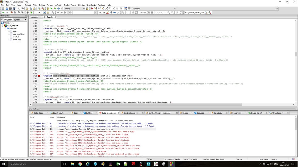

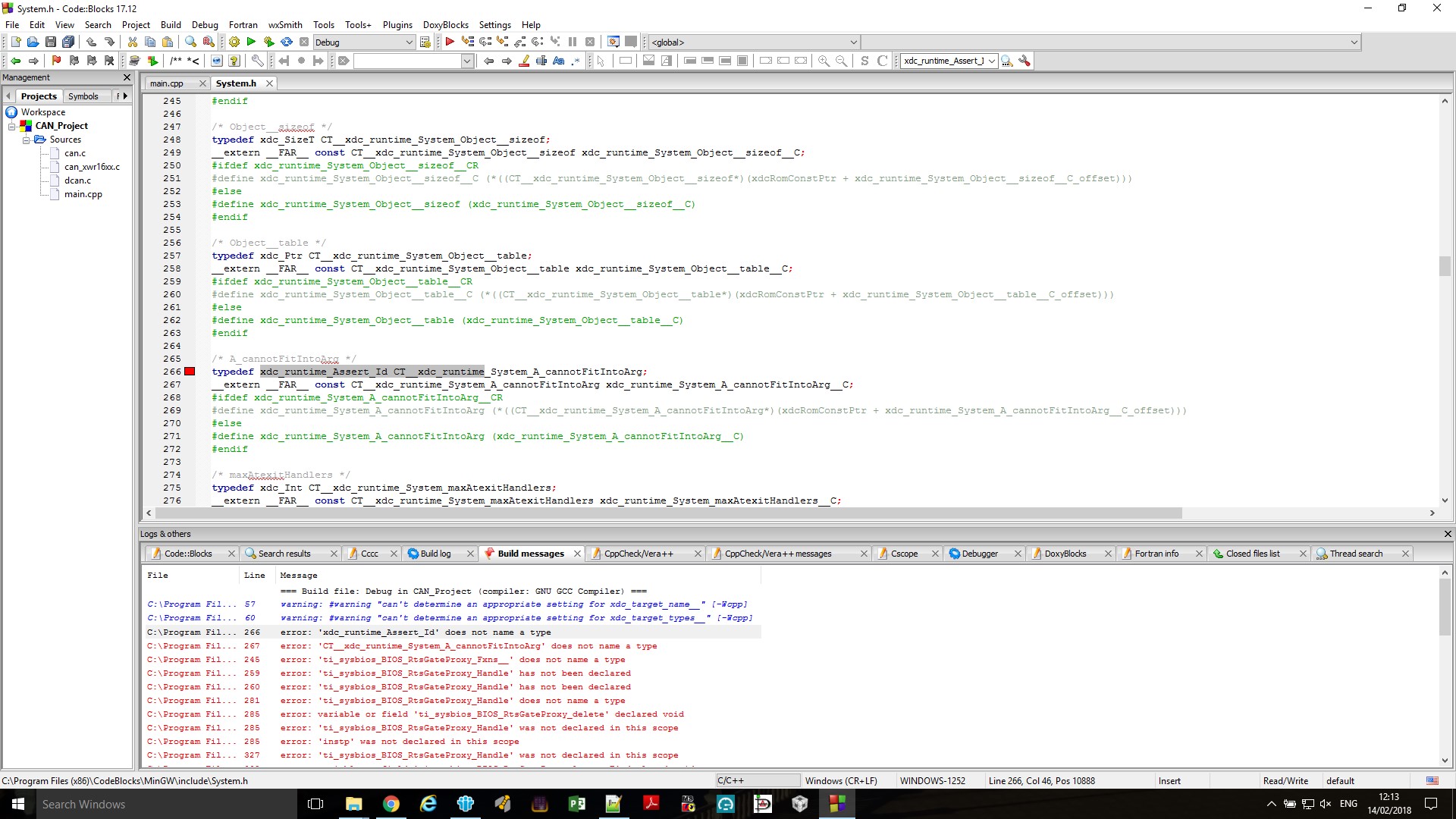

    At the moment I am trying to do the debugging of the file main.c ( ti\mmwave_sdk_01_01_00_02\packages\ti\drivers\can\test\common\main.c) to use the CAN protocol. Since my laptop goes continually  in crush with the CCS I am using a lighter C/C++ compiler called Code-Blocks. I imported all the TI libraries BIOS-XDC etc etc into this tool.
    Now going to debug the main.c  I have the following problems with the library system.h (see below)
    Could you help me for that?
    BR,
    Fabrizio
  • Hello Fabrizio,
    Do you have the right version of the XDC tools installed (xdctools_3_50_00_10_core)? The error could be due to mismatch in the XDC tool version.
    Please install the xdctools_3_50_00_10_core .
