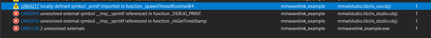

  • Hi Kaushal,
    This x64 lib should be working.
    However, I supposed that this x64 mmwlstudio.lib is built under Visual Studio 2010, and I only purchased Visual Studio 2017(I have VS2010 evaluation version installed, but it can't support x64 build).
    Then I configured my project as x64 version under VS2017. I met following problems.
    I did some searching on Google. I didn't understand why. But it seems to be due to different VS version.
    I am not sure you guys can help me with this. If possible, please. Otherwise, I will continue to find solution from internet.
    Feng

  • Hi Kaushal,
    Not yet!
    I had VS2017 installed. If I configure the project as x64 and then build it, it will report an error as following.
    I supposed that  the origin project is built under VS2010. And if I build it under VS2017, it will report this kind of error.
    I found no solution to solve this so far.
    Feng
