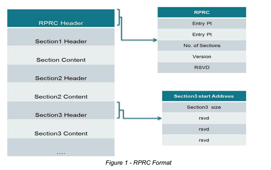

   My customer is studying AWR1642 bin format to develop their second boot loader. They analyzed the bin file xwr16xx_mmw_demo.bin under C:\ti\mmwave_sdk_01_01_00_02\packages\ti\demo\xwr16xx\mmw and have some questions about the RPRC header.
    In Image creator user guide, we find the EPRC header and section header format as below figure.
In the content of xwr16xx_mmw_demo.bin, you can find the RPRC header for 0x00000080. The RPRC header is 24 bytes, and there is section 1 header from 0x00000098, but the content of this header is zeros for section start address and section size. Customer is confused with it. Could you help to check?
