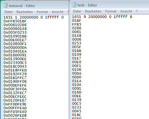

  • I am also saving data in a wrong format. I am using the following command:
    saveData(0x20000000,0,"C:\\Users\\Carlos.Chaves\\Desktop\\testsave3.dat",0x1FFFFF,IOMEMORY_HEX,false)
    However when I save data by using the option in the Tools menu i get the hexadecimal data formatted in groups of 16 bits, while when I use the script command they come in 32:
    Since the options to choose for the formating are IOMEMORY_COFF, IOMEMORY_FLOAT, IOMEMORY_HEX, IOMEMORY_INT,  IOMEMORY_LONG I cant format the data as I want. Is there any other formatting word available?. Also there are only 127 available commands for the scripting console of CCS. Are there more commands available to use?
  • Hi Carlos,
    If you are looking to save the data in a different format then I'd recommend using an external editor with this functionality.
