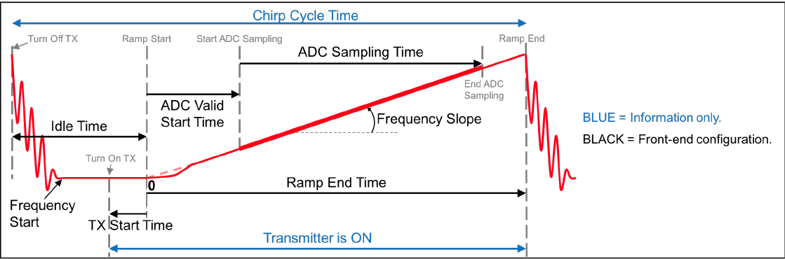

IWR1642: Decrease Chirp BW by decreasing "ADC Valid Start Time" parameter
Part Number: IWR1642
Other Parts Discussed in Thread: IWR1443,
My current configurations for the IWR1443 and IWR1642 has the same value
for the "ADC Valid Start Time" parameter which is 7 micro seconds.
Is it possible to decrease this value to zero or to a number close to zero in order
to decrease the Tx BW?
according to the following diagram it should decrease it:
