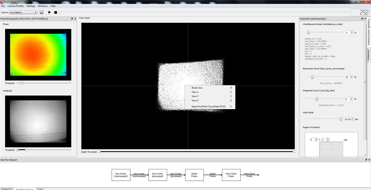

Q2. How to get the single frame cloud through using  the Voxel Viewer Software?

  • Hi Mickey,
    1) There is an option to export the point cloud as a pcd in VoxelViewer.
    2) For getting a single frame point cloud, pause the stream and right click on the point cloud. There is an option to export to point cloud:
    3) The .dat/.bin files contain the phase/amplitude/ambient/flags/depth/other file types. These are binary files containing data of all the frames. THe data type depends on the type of data. For example, for amplitude/phase, the data type is uint16, while for ambient/flags, the data type is uint8. In each of the case, the data is stored in a column-major order, for each of the frames present in the vxl. You can use this to get the correct depth and amplitude resolution.

  • Yes, the customer can get a single frame point cloud using the explanation given earlier.
    The link you shared shows how to extract the files. The customer can write a small code for using the bin file or Extract it using ExtractionOfCSVFromVoxelViewer.zip.
    Alternatively, they can use the C++ release of the VoxelSDK source code and retrieve all the data:
