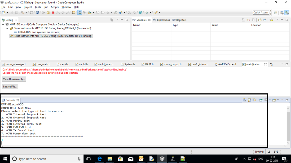

    with integrating CANFD code into demo code. so I want to go back to standalone CANFD debug code provided in "C:\ti\mmwave_sdk_01_01_00_02\packages\ti\drivers\canfd\test\xwr16xx" and test CAN communication alone .but it seems testselection is zero in " canfd\test\xwr16xx\main.c" .I want to change the testselection
    and regenerate "xwr16xx_canfd_mss.xer4f".

    I have seen those posts already.following information is needed as I mentioned in previous post already.main.c file in
    "C:\ti\mmwave_sdk_01_01_00_02\packages\ti\drivers\canfd\test\xwr16xx" testselection variable value is 0 by default.
    I want to change testselection to a valid value in program and regenerate "xwr16xx_canfd_mss.xer4f" file .
    ->I want to know how to recompile ,which make file to recompile (python ..etc needed) to this?
    (or) without recompiling can I give testselection value dynamically?
    please see attached screenshot as well.
  • Hello Krishna,
    Please refer to the user guide in the "MMWAVE-SDK" and refer for section "4.4.3 Building demo" . Please make sure all the dependent tools are installed before building the driver or demo .
    You can then hard-code the testselection =4 , to perform external CAN communication.
    Raghu

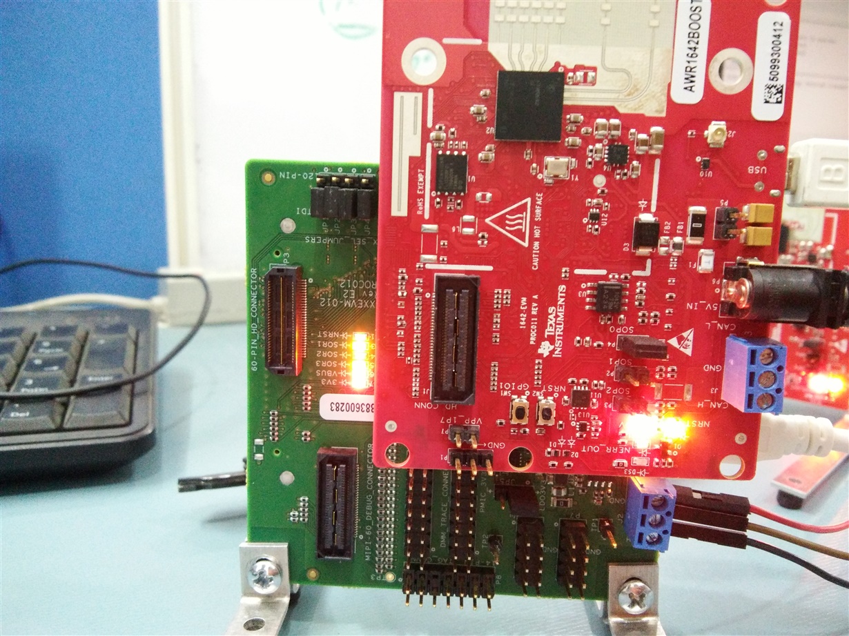

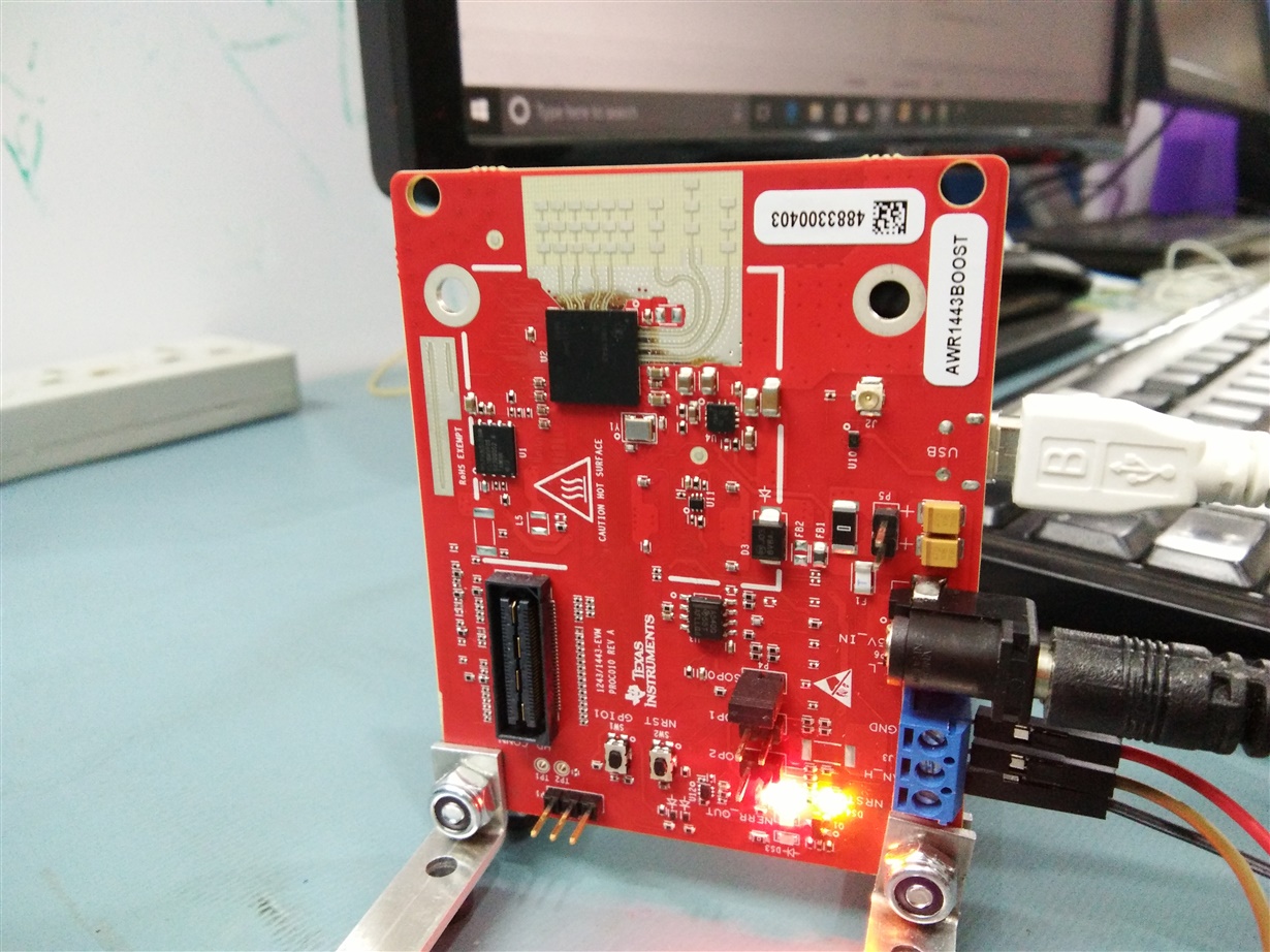

  • Hello Raghu,
    I have changed my test setup to DCAN interface since I have only awr1443 board in receiver side.
    sender side: awr1642 is connected to dev pack and all required ECO changes are done to access CAN2 connector on devpack(DCAN)
    and executing ti\driver\can test code for "awr16xx.xer4f".we have verified CANTX is happening at sender side(waveform on high and low lines in oscilloscope).
    Receiver side: awr1443 board running with "awr14xx.xer4f" .but there is no breakpoint being hit in receiver side DCAN0,DCAN1 ISR.testselection is 0 in receiver side.
    ->Is it correct to place receiver board also in debug mode to test the received data from sender.(or) we have to flash binary in receiver side?
    ->we have placed both boards (SOP 0 JUMPER IS connected ,SOP1,SOP2 are open on both side).Attached setup pictures below.
    PTKRISHNA.

  • Hi Raghu,
    As First step,I have ensured all ECO changes are done on both sides(sender :awr1642 DCAN, Receiver :awr1443).Then Tested with can drv test code for awr16xx provided under ti folder.Able to see voltage changes on CAN pins through oscilloscope.
    On receiver side ,After loading can drv test code provided in ti,I have done additional changes like added new test selection "5" which does all initializations (similar to what dcantrasmittest(),dcanparitytest() ),sets TLV to DCAN mode and waits for check of "grxDoneFlag" to be true.(if it is true I am reading dcanrx array).
    probably this is what it is done in dcanappcallback() already .
