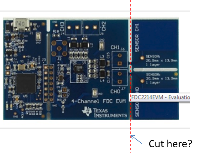

     I was also wondering if the distance between the the tank and the sensor matters.
    Finally if I am attaching a cage lid would it be advisable to cut off the small sensor pad from the dev board?..see fig
    cheers
    Hendrik
  • Hi Hendrik,
    Yes you can cut the board there and then use the exposed holes on J4-J7 points to connect your sensor. However I will emphasize an important point. If the cage/sensor is all one piece (electrically all shorted together) then you should only connect it to one of the inputs (INxA or INxB) to avoid shorting out the FDC driver. This will be a single ended connection similar to the one shown on the front page of the FDC2214 datasheet as well as how the FDC2214EVM comes by default before removing the breakoff section.
