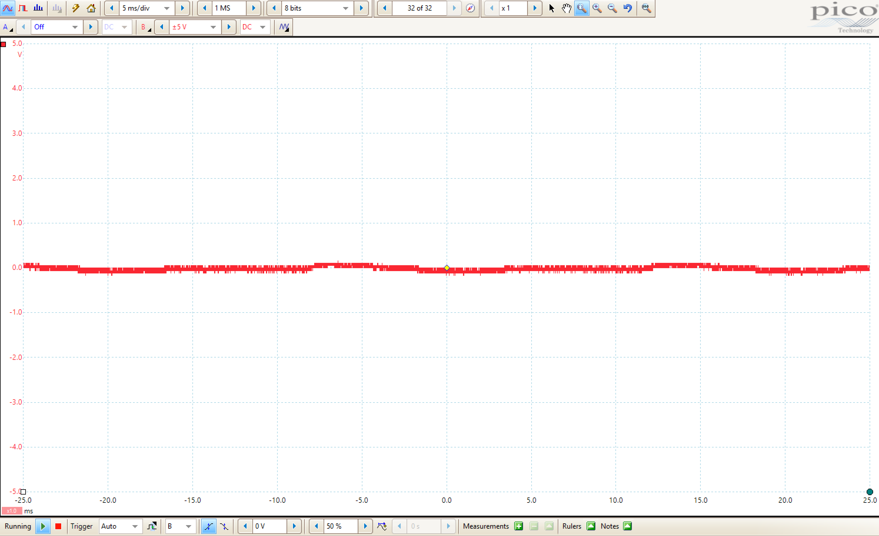

Then I started to test on AFE4404  breakout board that I ordered from a manufacturing company with SFH7050. I have a couple of issues with the hardware.
  1. Only one TX1 worked.
  2. ADC_RDY on AFE4404 breakout board did not generate pulsatile signal at 100 Hz. There was literally nothing coming from ADC_RDY.
I have attached all screenshots for signals from TX1, TX2, TX3 on AFE breakout board and the pulsatile signal (100Hz)  from ADC_RDY on HR3 development kit and AFE breakout board, respectively.
 Fig1 : TX1 (blue signal - Green LED) vs TX2 (red signal - Red LED)
Fig 2: TX1 (blue signal - Green LED) vs TX3  (red signal - Infrared LED)
Fig 3: ADC_RDY signal from HR3 (Development kit) - Direct measurement on ADC_RDY pin on HR3.
Fig 4: ADC_RDY signal from the AFE breakout board - Direct measurement on ADC_RDY pin on breakout board.

  • Hello Vinh,
    Welcome to TI E2E forum.
    The board schematics of the HR3 development kit and the break out board schematics look the same.
    Can you please clarify if they are the same or different?
    Also based on the schematics, it seems like INM is shorted to 3.3V and also TX2, TX3, RESET and CLK seem to be shorted to GND.
    From the AFE + SFH custom board, do you notice the SFH7050 LEDs turn on after configuring the AFE?

  • Hi Vinh,
    Can you check the presence of the diode on TX2,TX3 and ADC_RDY pins?
    Prabin
  • Hi Prabin,
    I currently do not have the diode on TX2, Tx3 and ADC_RDY pins.
    Is the presence of diode just only for protection purpose ? I am not quite sure how presence of diode would be working in this case.
    Vinh Thuan Tran
  • Hi Vinh,
    I was referring to the ESD protection diodes that are inside the AFE4404.
    So you just have to verify the presence of the diodes on above mentioned pins.
    Prabin
  • HI Prabin,
    I am still unsure about the presence of the diodes inside AFE4404.
    Can you give me more details or instructions about it ?
    Vinh
  • Hi Vinh,
    Most of the pins in an IC have internal ESD diodes.
    We can use this information to verify that the device is soldered correctly by measuring the voltage across these diodes.
    You can use multimeter in diode mode , connect the positive terminal to ground of the board.
    Now if you connect the negative terminal to above mentioned pins you should see a voltage ( 0.4 to 0.7V). If you don't see the voltage that means these pins are not connected to board and you have to re-solder the device.
