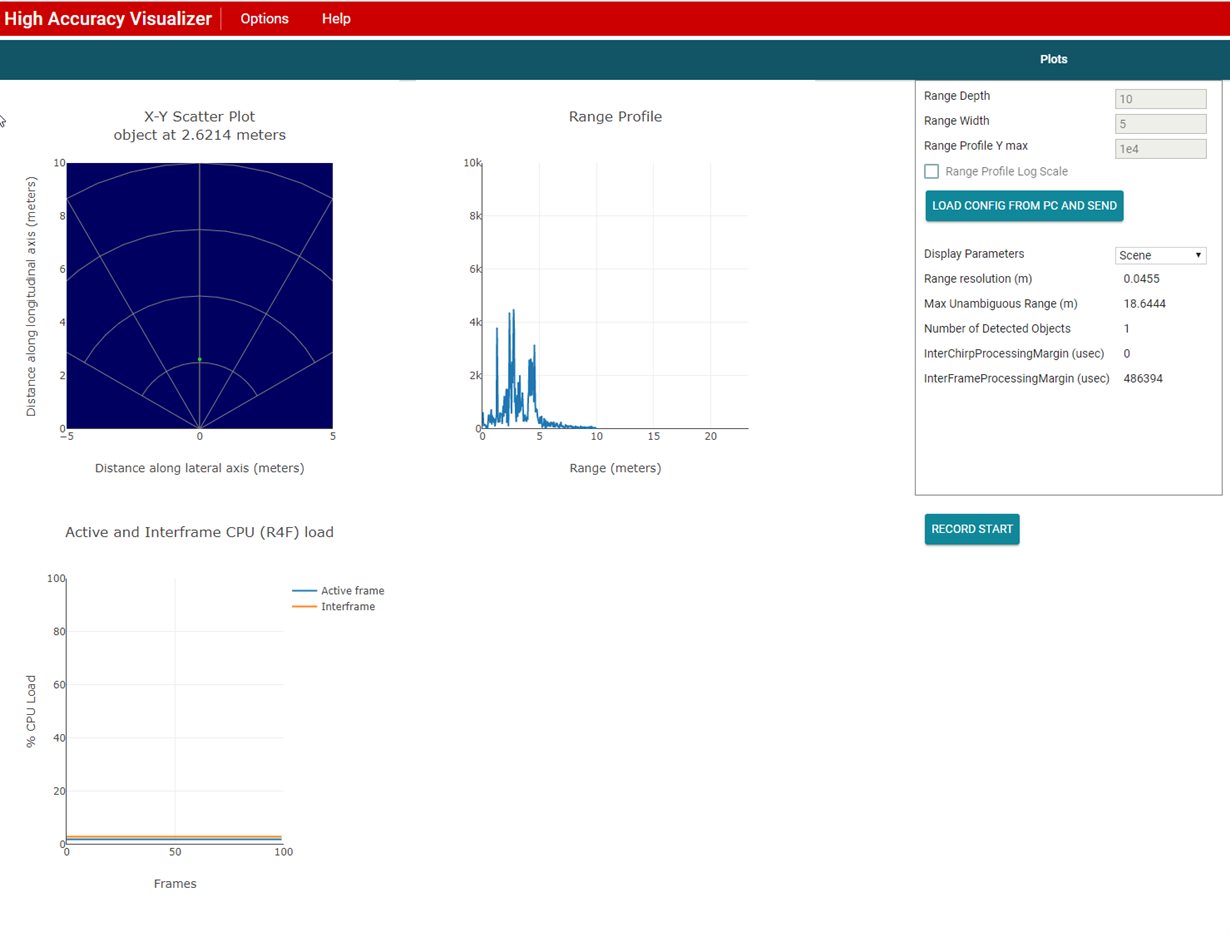

Our IWR1443BOOST works perfectly.  Large portions of the mmWave Demo visualizer documentation SWRU529A discuss the Configure tab.  Where is this tab on the Visualizer?   Thanks, Peter
  • Hi Peter,
    I'm glad you were able to get it working! The Visualizer you are using is the High Accuracy Visualizer and not the Standard mmWave Visualizer. For your application I'd recommend sticking with the High Accuracy Visualizer and making whatever configuration changes you want to the chirp config.
    Let us know what you are trying to config and we can help you do it through the chirp config or otherwise.
    Cheers,
    Akash
  • Hello Peter,
    If you scroll up so you can see the mmWave Demo Visualizer red banner. You should have a left "Configure" and a right "Plots" tab.
    Your picture shows the plots portion. There are two methods to load the configuration, for testing, you would adjust the parameters
    from the configure tab, send the config to mmwave device (bottom left button ). Then scrolling to the top, select plots. Adjust your plot options, when it works take a reference picture AND..... go back to the Configure tab, and Save Config to PC.
    The second way to do the loading, goto the Plots tab, depress Load Config from PC and Send. Hopefully you get the outcome expected.

  • We are trying to look ahead with our hardware design using the high accuracy lab as a starter.  We cannot see data on AR_RS232_TX and RX using a scope with the visualizer on high accuracy.  Does it go into the XDS110 on another port such as SPI or SCI?  The AR_BSS_LOGGER has scope activity so we suspect that is where the visualizer data is going into the XDS110 to the PC.
    Where is this CONFIG data go into the IWR1443 for the high accuracy lab ?
    We thought that we could see data on AR_RS232TX at 921600 for DATA and AR_RS232RX 115200 for CONFIG.  Are the AR_RS232RXTX ports used at all in the high accuracy lab visualizer.
    Is the TMDSEMU110-U a good XDS100 device to use for our production board?
    You mention tabs to see the CONFIG  page on the Visualizer.  Sorry, but we cannot find it on the red banner (below).  Akash mentioned that we would not see the Config tab with the high accuracy lab project.
    Thanks, Peter
  • Hi Peter,
    The CLI command port communication is through AR_RS232_TX and RX. You can try open a tera term and send command line by line, you'll clearly see those lines are toggling.
    The Data is sending through AR_MSS_LOGGER pin.
    XDS110 used on our BOOST EVM can be as a reference design.
    Yes, visualizer of high accuracy only has plots panel.
