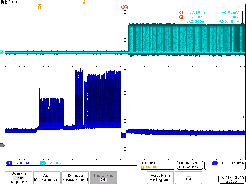

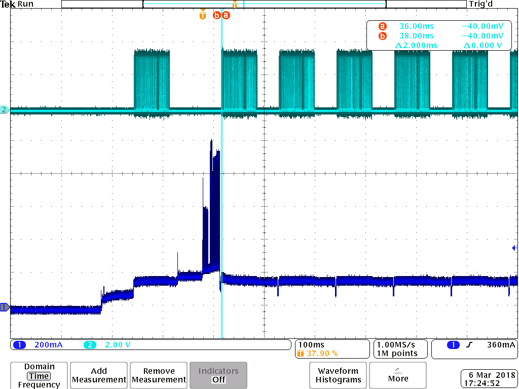

  • Jitendra,
    Since I only have the MSS and BSS binaries (found in mmwave_dfp_01_00_00_01\firmware), my debug possibilities are quite limited.
    I did some measurements with an oscilloscope, see below.
    The blue curve is the current consumption during the startup of the IWR1443 chip.
    The cyan curve is the QSPI communication with the external flash
    The high current consumption, that starts at the trigger point (T), I guess comes from the calibration of the chip (done in MMWL_rfInit). The calibration seems to go on for a while, but it is quite obvious that the chip is restarted during this calibration/verification since the QSPI communication shows that the SW is read from the flash.
    The other oscilloscope plot is a zoomed version of the first one, centered at the position where the chip seems to reboot. Here you can see that the SW load starts approx 3 ms after the last spike in the current consumption.
    I also verified the supply on all rails and couldn't see any voltage drops, that could explain the restart of the chip.
    What else except the voltage drops could explain the restarts?
    Watchdog Reset?
    Fatal exception Reset?
    What I also think is a little strange, is that when the chip has restarted once it seems to go into a reset loop, with a reset every 125 ms.
    BR,
    Haakan

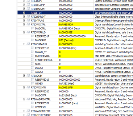

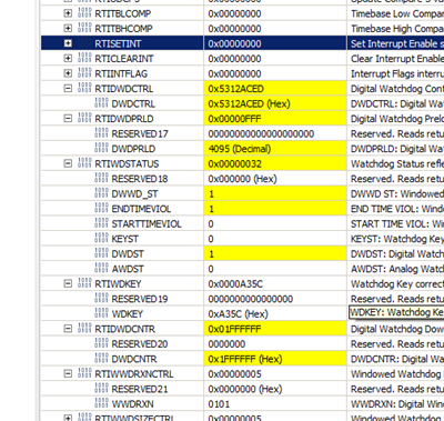

  • Jitendra,
    I have already tried this, but it didn't make any difference. The IWR1443 is restarted even if all calibrations are disabled.
    I have also downloaded the (mmwave_dfp_01_00_00_01) binaries in in one of our EVM's and the IWR1443 goes into a reset loop when power is turned on.
    My guess is that you have enabled the watchdog in the MSS software (with a timeout of approx 40ms). It seems like the watchdog only is trigged when you communicate with the IWR1443 (MSS) and therefore the IWR goes into this reset loop.
    Does this make sense?
    View of registers in debugger (EVM connected) => Watchdog is enabled with timeout approx 36ms...
    Another view (EVM connected) => The watchdog has timed out...
