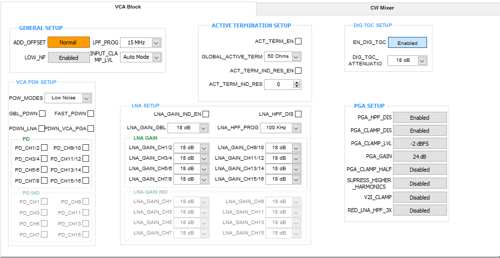

They evaluated AFE5818EVM with TSW1400EVM.
Their configurations are as follows.
[Q]

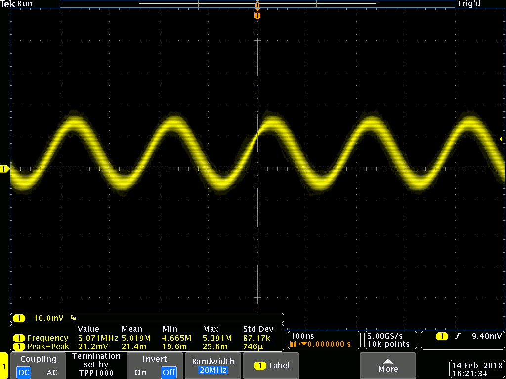

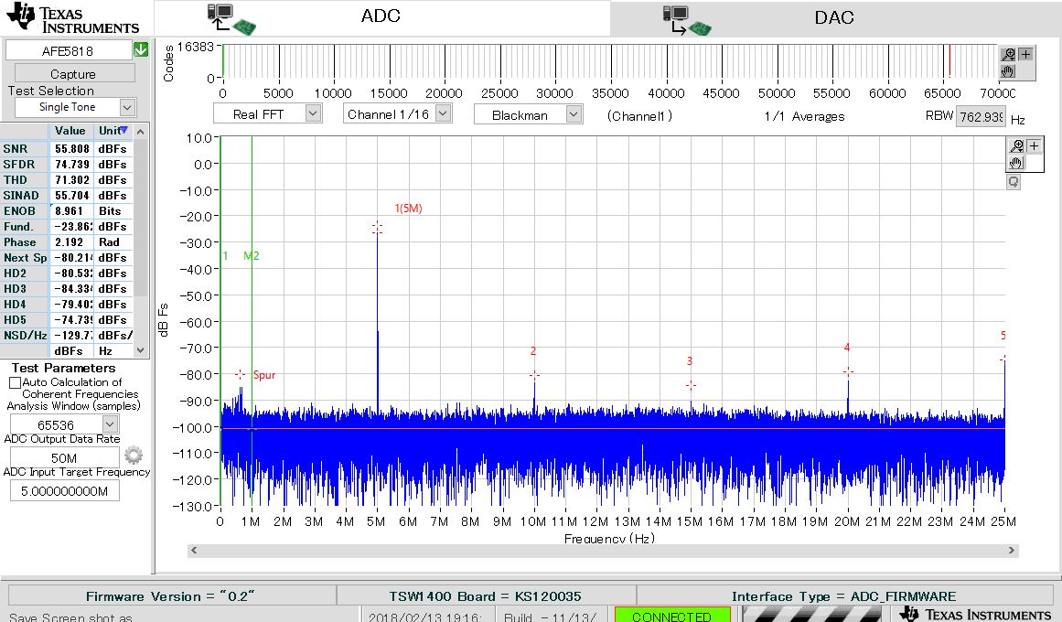

We can not understand that why the output fundamental value is -23.862dBFS.
Please tell me how to calculate the output power from input power and the setting.
[Test Condition]
AFE5818EVM INP1(J6) : 5MHz, -50dBm CW Input
AFE5818EVM GUI : Set init.cfg (..\HMC-DAQ GUI\Scripts\AFE5818\init.cfg)
[Test Result]
Fund.=-23.862dBFS
