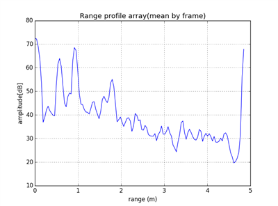

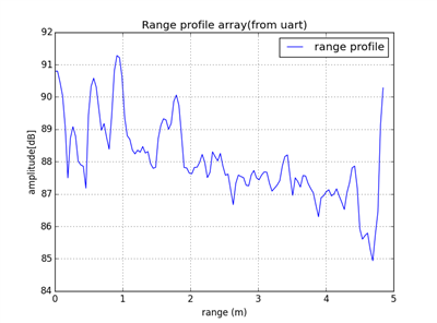

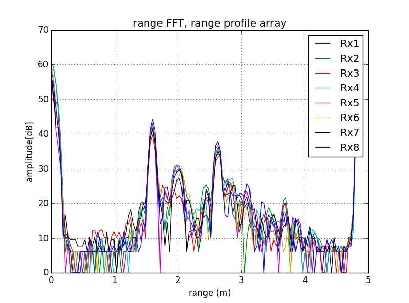

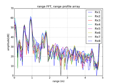

I got the data of range FFT and plot the data per antenna like the graph "range FFT" below:
the mean value of the antenna  plotted like "Range profile array (mean by frame)"
compare the level of "Range profile array (mean by frame)"  and "range profile form Uart", the whole shape of the graph is similar but the delta of max and min value is so different.

rangeProfile is the 0doppler array of 2D-FFT. But i think it should be same value of (peakvalue - noisefloor), anyone can tell me why it is so difference?
or give me a formula to calculate the rangeProfile from 1D-FFT?

  • Why are there diffrence between amplitude value of 1D-FFT and amplitude value of 2D-FFT in 0 doppler ??
    Both data is obtained from UART port. It will be same value, right ??.
    We guess one of the reason is from window function when calculate 2D-FFT.

  • Hi lin,
    It seems that you're asking about algorithmic issues of the 1D and 2D FFT processing. The Doxygen documentation provides a description of the processing steps, and the code provides the lower level of detail. It is possible that the difference is simply a matter of scaling, as the demo strives to be computationally efficient over algorithmically intuitive. To find the cause of the difference you are looking for will require digging into the code, possibly setting breakpoints and looking at various values at each step.
