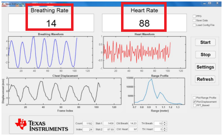

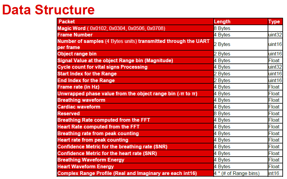

Q1: I got the data by running this Lab, but no value like Magic word was found in the acquired data. The magic word will be discarded when acquiring data? In other words, does the acquired data be stored from Frame Number(4 byte)?
Q2: Does Breathing rate and Heart rate on GUI use the value of "Breathing rate from peak counting" and "Heart rate from peak counting" in Data Structure?
Q3: If the acquired data starts from Frame Number, "Breathing rate from peak counting" and "Heart rate from peak counting" had the following values.
How is this value converted to Breathing rate and Heart rate on GUI?
Breathing rate from peak counting = 00 80 BB 41
Heart rate from peak counting = 00 90 8D 42

    I understand that Magic word is not included in the output packet in the current version Lab. Is my understanding correct?
    Could you tell me the specific calculation method of the breathing rate and heart rate which displayed on the GUI from each parameter of Vital Signs Output Stats?
    H.U
  • Hi H.U.
    This is correct Magic word is not included here.

    I can understand that the Breathing Rate and Heart Rate using the output data defined in the following data structure, Can you disclose this calculation method with the document?

    Apologies for the delay. The estimation algorithm is discussed on pages 8 - 10 of the Developer's Guide (dev.ti.com/.../ and the calculation is performed in the blocked called Spectral Estimation.
    Please make sure you have the latest version from the TI Resource Explorer as a new version just went live on Monday.
