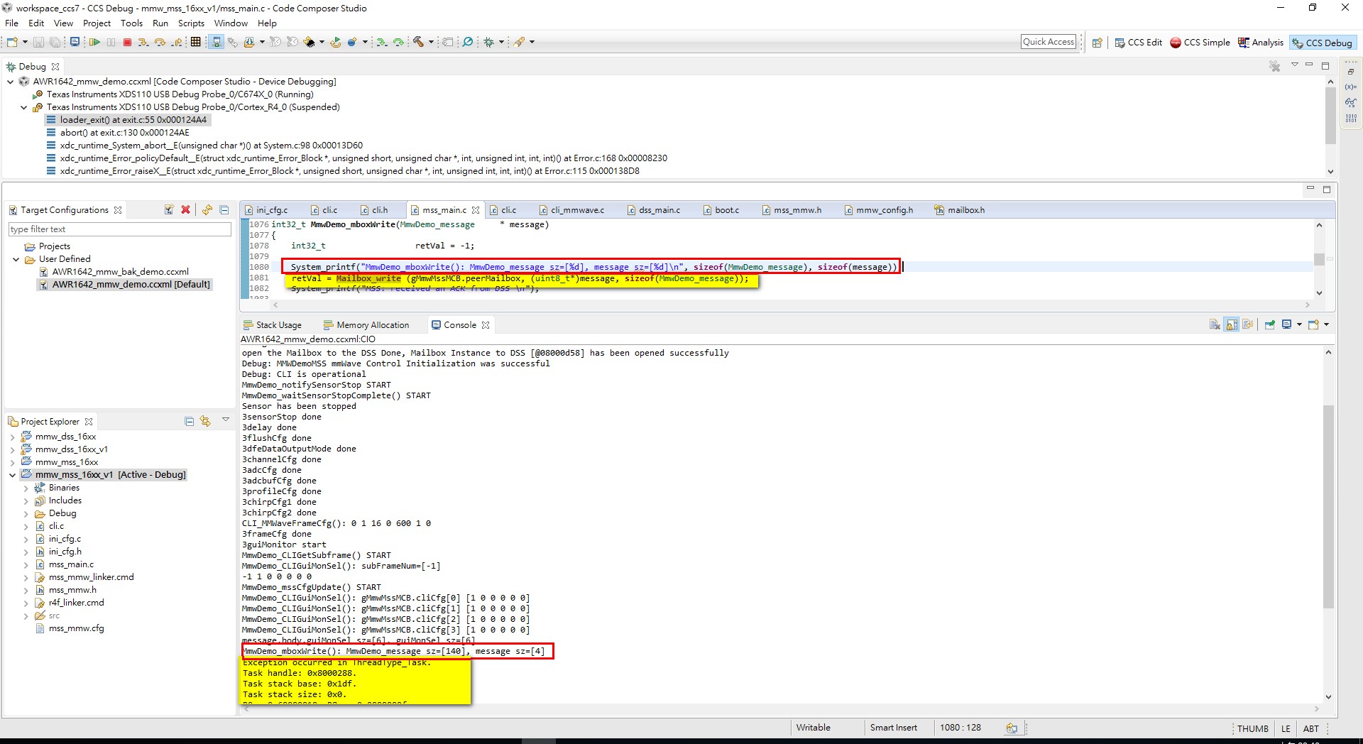

I am trying to do a project using AWR1642 board on Windows platform. I want to be able to configure the board using code so i can have same configuration settings and need not to reconfigure it every time i power up the board.
I modify code in path sdk\packages\ti\demo\xwr16xx\mmw and set config like below:

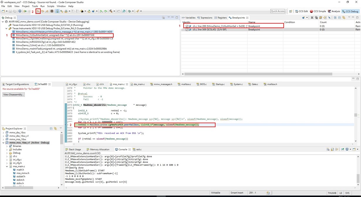

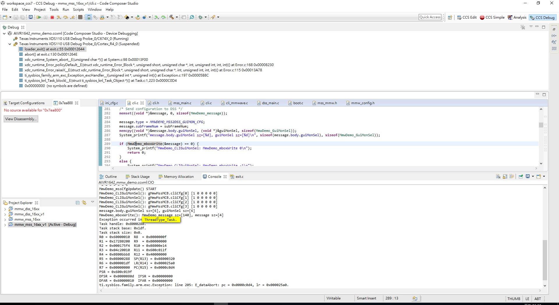

and The AWR1642 crashed on command guiMonitor. the crashed raised by MmwDemo_mboxWrite(). crashed happen as below. Hope you can help me to check this problem. thank you.
    Can you please let us know what application you plan to develop with AWR1642? This will help us better answer your questions.
    Please let us know which version of mmWave SDK you are using and what are the changes you have made to the default files
    thank you
    Cesar
  • Hi Cesar,
    I am using mmwDemo in mmwave_sdk_01_01_00_02. I want to be able to configure the board with default configuration settings and need not to reconfigure it every time i power up the board.
    refer the modification as

        MmwDemo_CfgWithCmdString ( 1, iniCfgCmds.sensorStop         			);
        System_printf ("3sensorStop done\n");
        for (c = 1 ; c <= 50000000 ; c++); //this delay ensures the sensor stops
        System_printf ("3delay done\n");
        MmwDemo_CfgWithCmdString ( 1, iniCfgCmds.flushCfg           			);
        System_printf ("3flushCfg done\n");
        MmwDemo_CfgWithCmdString ( 2, iniCfgCmds.dfeDataOutputMode  			);
        System_printf ("3dfeDataOutputMode done\n");
        MmwDemo_CfgWithCmdString ( 4, iniCfgCmds.channelCfg         			);
        System_printf ("3channelCfg done\n");
        MmwDemo_CfgWithCmdString ( 3, iniCfgCmds.adcCfg             			);
        System_printf ("3adcCfg done\n");
        MmwDemo_CfgWithCmdString ( 6, iniCfgCmds.adcbufCfg          			);
        System_printf ("3adcbufCfg done\n");
        MmwDemo_CfgWithCmdString (15, iniCfgCmds.profileCfg         			);
        System_printf ("3profileCfg done\n");
        MmwDemo_CfgWithCmdString ( 9, iniCfgCmds.chirpCfg1          			);
        System_printf ("3chirpCfg1 done\n");
        MmwDemo_CfgWithCmdString ( 9, iniCfgCmds.chirpCfg2          			);
        System_printf ("3chirpCfg2 done\n");
        MmwDemo_CfgWithCmdString ( 8, iniCfgCmds.frameCfg           			);
        System_printf ("3frameCfg done\n");
        System_printf ("3guiMonitor start\n");
        MmwDemo_CfgWithCmdString ( 8, iniCfgCmds.guiMonitor         			);
        System_printf ("3guiMonitor done\n");
        MmwDemo_CfgWithCmdString ( 9, iniCfgCmds.cfarCfgRange       			);
        System_printf ("3cfarCfgRange done\n");
        MmwDemo_CfgWithCmdString ( 9, iniCfgCmds.cfarCfgDoppler     			);
        System_printf ("3cfarCfgDoppler done\n");
        MmwDemo_CfgWithCmdString ( 7, iniCfgCmds.peakGrouping       			);
        System_printf ("3peakGrouping done\n");
        MmwDemo_CfgWithCmdString ( 4, iniCfgCmds.multiObjBeamForming			);
        System_printf ("3multiObjBeamForming done\n");
        MmwDemo_CfgWithCmdString ( 3, iniCfgCmds.clutterRemoval					);
        System_printf ("3clutterRemoval done\n");
        MmwDemo_CfgWithCmdString ( 6, iniCfgCmds.calibDcRangeSig				);
        System_printf ("3calibDcRangeSig done\n");
        MmwDemo_CfgWithCmdString ( 3, iniCfgCmds.extendedMaxVelocity			);
        System_printf ("3extendedMaxVelocity done\n");
        MmwDemo_CfgWithCmdString (18, iniCfgCmds.compRangeBiasAndRxChanPhase	);
        System_printf ("3compRangeBiasAndRxChanPhase done\n");
        MmwDemo_CfgWithCmdString ( 4, iniCfgCmds.measureRangeBiasAndRxChanPhase	);
        System_printf ("3measureRangeBiasAndRxChanPhase done\n");
        MmwDemo_CfgWithCmdString ( 1, iniCfgCmds.sensorStart        			);
        System_printf ("3sensorStart done\n");
        return;

    int32_t MmwDemo_CLIGuiMonSel (int32_t argc, char* argv[])
        MmwDemo_GuiMonSel   guiMonSel;
        MmwDemo_message     message;
        int8_t              subFrameNum;
        if(MmwDemo_CLIGetSubframe(argc, argv, 8, &subFrameNum) < 0)
            return -1;
        System_printf ("MmwDemo_CLIGuiMonSel(): subFrameNum=[%d]\n", subFrameNum);
        /* Initialize the guiMonSel configuration: */
        memset ((void *)&guiMonSel, 0, sizeof(MmwDemo_GuiMonSel));
        /* Populate configuration: */
        System_printf("%d %d %d %d %d %d %d\n", atoi(argv[1]), atoi(argv[2]), atoi(argv[3]), atoi(argv[4]), atoi(argv[5]), atoi(argv[6]), atoi(argv[7]));
        guiMonSel.detectedObjects           = atoi (argv[2]);
        guiMonSel.logMagRange               = atoi (argv[3]);
        guiMonSel.noiseProfile              = atoi (argv[4]);
        guiMonSel.rangeAzimuthHeatMap       = atoi (argv[5]);
        guiMonSel.rangeDopplerHeatMap       = atoi (argv[6]);
        guiMonSel.statsInfo                 = atoi (argv[7]);
        /* Save Configuration to use later */
        //memcpy((void *)&gMmwMssMCB.cfg.guiMonSel, (void *)&guiMonSel, sizeof(MmwDemo_GuiMonSel));
        MmwDemo_mssCfgUpdate((void *)&guiMonSel, offsetof(MmwDemo_CliCfg_t, guiMonSel), sizeof(MmwDemo_GuiMonSel), subFrameNum);
        System_printf ("MmwDemo_CLIGuiMonSel(): gMmwMssMCB.cliCfg[0] [%d %d %d %d %d %d]\n",
                       gMmwMssMCB.cliCfg[0].guiMonSel.detectedObjects,
                       gMmwMssMCB.cliCfg[0].guiMonSel.logMagRange,
                       gMmwMssMCB.cliCfg[0].guiMonSel.noiseProfile,
                       gMmwMssMCB.cliCfg[0].guiMonSel.rangeAzimuthHeatMap,
                       gMmwMssMCB.cliCfg[0].guiMonSel.rangeDopplerHeatMap,
                       gMmwMssMCB.cliCfg[0].guiMonSel.statsInfo);
        System_printf ("MmwDemo_CLIGuiMonSel(): gMmwMssMCB.cliCfg[1] [%d %d %d %d %d %d]\n",

        /* Send configuration to DSS */
        memset((void *)&message, 0, sizeof(MmwDemo_message));
        message.type = MMWDEMO_MSS2DSS_GUIMON_CFG;
        message.subFrameNum = subFrameNum;
        memcpy((void *)&message.body.guiMonSel, (void *)&guiMonSel, sizeof(MmwDemo_GuiMonSel));
        System_printf("message.body.guiMonSel sz=[%d], guiMonSel sz=[%d]\n", sizeof(message.body.guiMonSel), sizeof(MmwDemo_GuiMonSel));
        if (MmwDemo_mboxWrite(&message) == 0) {
            System_printf("MmwDemo_CLIGuiMonSel: MmwDemo_mboxWrite 0\n");
            return 0;
        else {
            System_printf("MmwDemo_CLIGuiMonSel: MmwDemo_mboxWrite -1\n");
            return -1;

    You can see the config commands are successful until guiMonitor -1 1 0 0 0 0 0
    Please guide me how to fix this.

  • Hi Sir,
    I just found one thing. If I set Breakpoint before MmwDemo_mboxWrite() and make sure stepInto Mailbox_write(). It works!! MSS receive ACK from DSS. Otherwise, the AWR1642 crashed if I run application directly. Is it because the work time by Mailbox_write() is not enough to deal with? How to avoid this error happen? Hope you can help me to check this problem. thank you.
    Zoe
  • Basically what you are trying to do is bypass CLI. Unfortunately, the way CLI is integrated into the demo, commands that are sent from the UART not only trigger communication with DSS (theC674 DSP) but also cause the sequence MMWave API calls to configure the BSS, running calibration, etc. All of this must be maintained if CLI is not used.
    A simpler way to do this is to just block copy the desired sequence of CLI commands into your UART terminal program (e.g. Tera-Term). If this chokes, you will need to edit the "Transmit delay", increasing the msec/char and msec/line delays until it works.
    If you still desire to embed your configuration into the demo, then you will need to trace each command from the CLI handler to DSS, noting what APIs are called and what configuration structures are updated. Then duplicate this without CLI. If it crashes (as you have shown above) then something isn't happening in the right order, or possibly not allowing each command to complete before starting the next.
