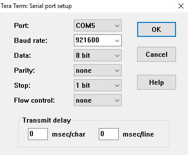

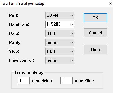

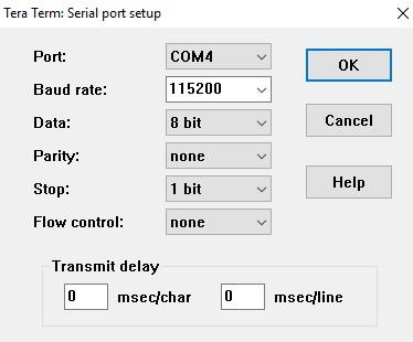

    3) Open 2 sessions of TeraTerm: one for Application/User port and one for Data Port (in my case COM4 and COM5, respectively).
    4) Set the ports as follows (No other settings have been made, is it right?):

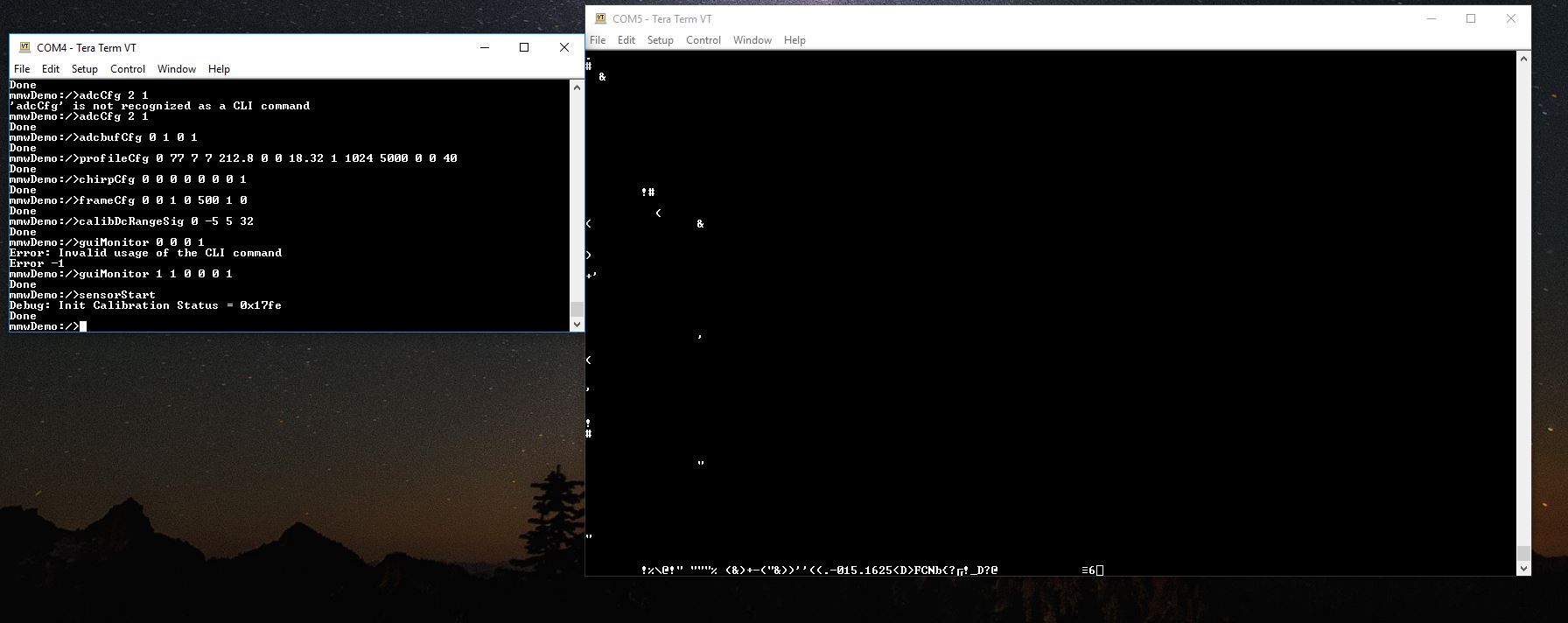

    6) After the last command, the COM5 terminal starts to "move", but the visualized symbols are not the same as discussed in the thread you suggested to read.
    Please, could you help me to understand where is the error?
    For sake of completeness, this is what I see after "SensorStart:
  • Davide,
    The setting of COM port is correct. The data showing up on COM 5 means it's working. The reason you can't see the expected data and all output seems garbled is that the output data is in binary format, not ASCII. You need to save the output and read in a binary format.
    Visualizer uses java code to read the UART output data. Other tools can be used as well. For example matlab.
    Hope this helps.
    Michelle

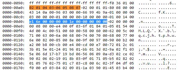

  • Dear Michelle,
    I have extracted the Data from the device and visualized. Thanks.
    However, a quite large discrepancy between the received data and the real one is present.

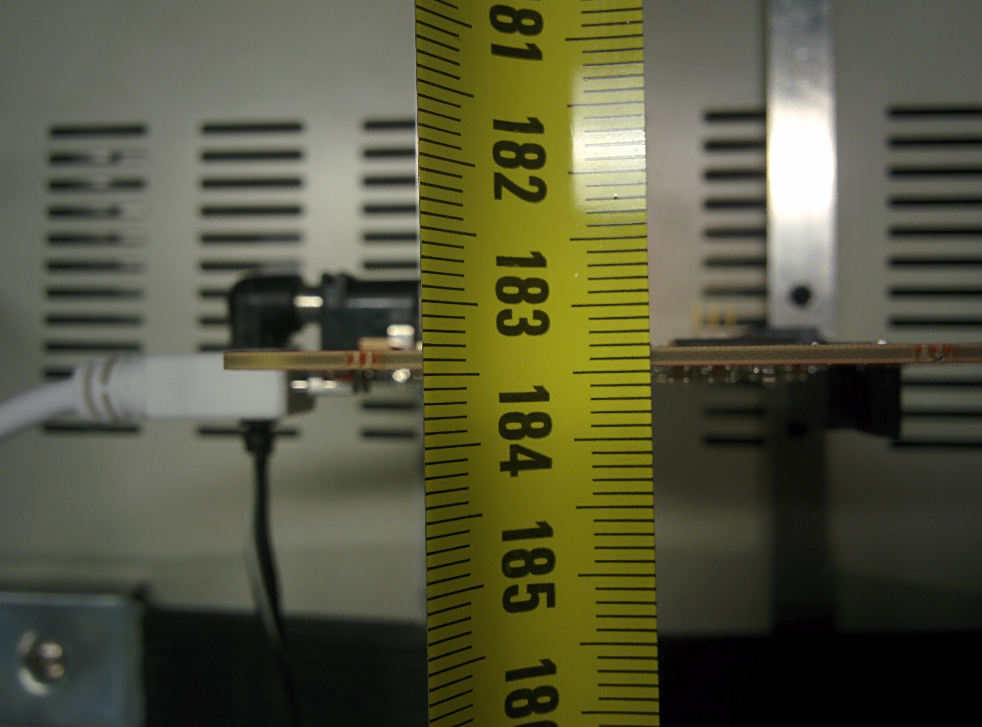

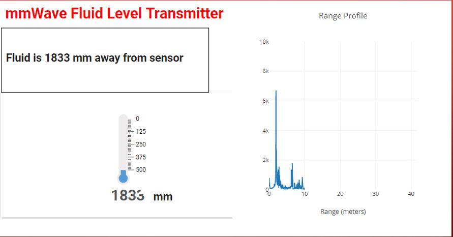

    In the following I show you the measurement setup, web application results and extracted data:
    1) REAL DISTANCE = 1.833mm
    2) FLUID LEVEL VISUALIZER = 1.833 mm (OK!)
    3) EXTRACTED DATA = 1.902mm (WRONG!)
    Qformat = 0x14 -> decimal = 20
    Range est low 16 bits = 6ee1 -> decimal = 28385
    Range est high 16 bits = 001e -> decimal = 30
    DISTANCE FROM DATA = (28385+30*65536)/(2^20)=1902 mm
    Please, could you help me to understand where about 7cm came from?
    Many thanks,
    Davide
  • Michelle,
    probably I have found the solution in the code of the GUI interface "mmWave_Fluid Level Transmitter".
    The code in mmw_HighAccu.js is slighly different in the two interfaces, i.e. High Accuracy Visualizer and Fluid Level transmitter.
    The difference is located in the segment of code written by Akash (I suppose) al line 690 of Fluid Level transmitter:
                  //Akash
                   templateObj.$.ti_widget_plot1.restyle(update, [0]);
                   } else if (Params.use_restyle==2) {
                   templateObj.$.ti_widget_plot1.data[0].x = math.zeros(x_coord.length).valueOf();// [WL: 0;
                   templateObj.$.ti_widget_plot1.data[0].y = x_coord;
                   //templateObj.$.ti_widget_plot1.data[0].marker.color = peakValLog;
                   //templateObj.$.ti_widget_plot1.data[0].marker.color = '#00FF00'; //#1BC81B';
                   var new_x_coord = x_coord - .0696
                   x_coordPrev = ((x_coordPrev)*.8 + (new_x_coord)*.2);
                   var x_coordLast = x_coordPrev * 1000;
                   var title_s = 'Fluid is ' + math.round(x_coordLast*1)/1 + '' + ' mm away from sensor';
                   templateObj.$.ti_widget_plot1.layout.title = title_s;
                   templateObj.$.ti_widget_plot1.redraw();
                   templateObj.$.ti_widget_label_reading.label = title_s;
                   templateObj.$.ti_tile_thermometer1.value = x_coordLast;
    In bolded font, I have found my 7 cm! You guys have applied a sort or correction factor to the distance. Is it right?
    The quest is now WHY?
    Please, could you confirm or not my conclusions?
    I think that it would be very interesting for the community because I did not find any discussion about this in TI documents.
    Many thanks,
    Davide
  • Davide,
    Your finding is right on. There is always an offset of what radar measures vs. the actual distance. In SDK1.1 mmw demo, a range bias offset cli command is implemented, but it's not available in high accuracy lab (both level sensing and high accuracy lab has the same binary). In mmw demo, the offset is measured and subtracted in mss code but in level sensing it's done in visualizer.
    For your information, the cli commands used in mmw demo is measureRangeBiasAndRxChanPhase and compRangeBiasAndRxChanPhase.
    I think the question from this thread is solved. Please confirm. Feel free to ask question if there's any.
    Michelle
