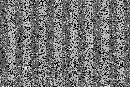

About opt9221 3D_ToF imaging problems:
I try to configure opt9221 in DVP mode. And I have some question:
The firmware is loaded successfully, and the version number is read correctly. The OPT9221 initialization register configuration is completed. The OPT9221 operates at 9% integration time, the modulation frequency is 48Mhz, and the output mode is DVP mode, blk_size = blk_blank_size = 1280.However, the image is not displayed correctly.
What causes this problem?
Below is the image I collected:
