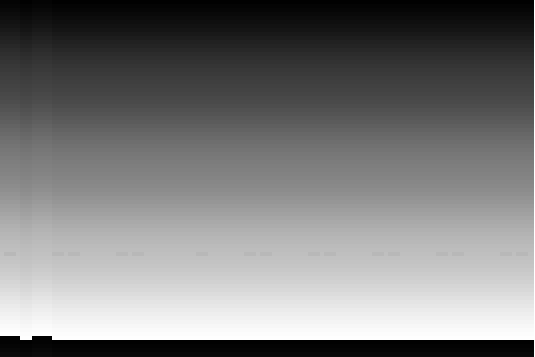

I try to configure opt9221 in DVP mode. And I have some question:
The firmware is loaded successfully, and the version number is read correctly. The OPT9221 initialization register configuration is completed. The OPT9221 operates at 9% integration time, the modulation frequency is 48Mhz, and the output mode is DVP mode, blk_size = blk_blank_size = 1280.However, the image is not displayed correctly.
What causes this problem?
Below is the image I collected:
  • if set phy_test_enable = 1 image is :
  • this Group by 8 (default) output data:
    0,0,0,0,0,0,0,0,0,0,0,0,0,0,0,0
    EC,5,71,1,D4,4,CF,C,CF,C,32,C,F5,B,5A,C
    EC,9,13,2,30,B,CD,F,A5,3,5A,4,F6,3,A5,3
    Why both amplitude and ambient are zero
  • Please check your illumination to make sure it is transmitting; and check to make sure object is not too near to cause saturation.
    Also try run mac test and report the result.
    What are your other modulation related settings? mod_mx, mod_nx, mod_psx, etc., where 'x' is 1 or 2.
    -Larry

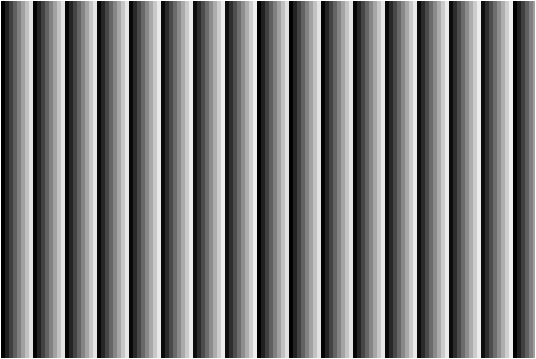

  • Hi LarryLi,
    After I set mac_test_enable = 1, the image is
  • CMOS is not imaging, with the phone flash direct exposure to the lens without any reaction;
    No other modulation related settings,and with reference to the OPT9221 initialization sequence you provided.
    Other registers are not set, are the default value.So we are not sure whether it is a hardware problem or a software problem.

    3, if phy_test_enable = 1, the output data is 0,0,1,2, ..., 255,0,1,2, ... 255, ... The data looks correct, but if phy_test_enable = 0, the output data is

    3、 Data is output from 9221 when phy_test_enable = 1? OPT8241 control the register in addition to the TG register, but also other configuration?
    >> When phy_test_enable = 1, OPT9221 outputs a pattern directly to DVP and OPT8241 data is ignored.  TG registers are physically on OPT8241, such as PLL settings.
