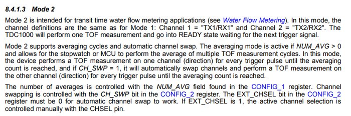

  • Sorry, I mixed up the NUM_AVG setting with the NUM_ELEMENTS on the GUI graph tab. NUM_AVG is only used in Mode 2 and it lets the TDC1000 know how many measurements to take in one direction before switching directions.
    The full description is easily searchable in the datasheet:
  • So NUM_AVG of TDC 1000 has to be synced with multi averaging of TDC 7200 to get the proper results.
