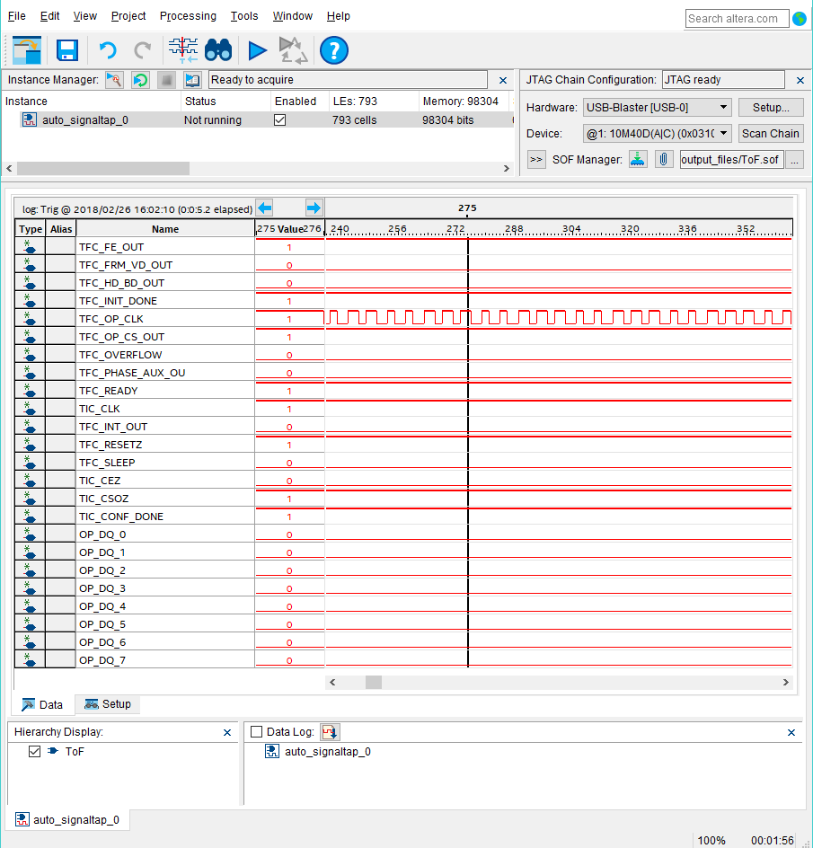

Hi TI,
I have done initialisation
And Int_out pin shows that everything is Ok. I have check all flags in "Register 63h", and everything is ok. Set up pins read/overflow/sleep in 1/0/0 as here
And reg=80h  set to 0h (tg_dis) through I2C. I see clock(OP_CLK in 24MHZ, next pic) in my FPGA  and continiuos FE_OUT in high level, but haven't any output data. There no any changes in FRM_VD/HD_BD/OP_CS.

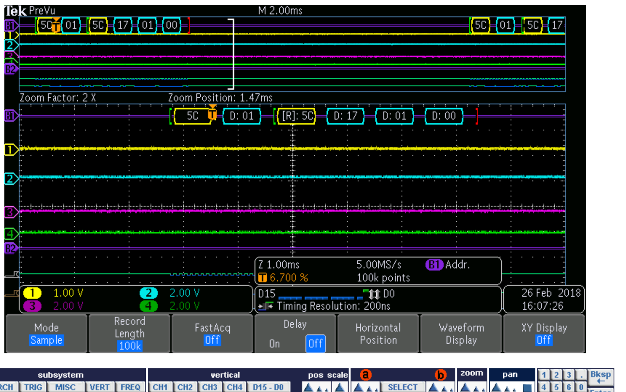

  • Viktor,
    Please check I2C register 'minor', which is DE register 0x01, bit [4:0] and see what it reads.  If it reads 30, then try the below register sequence to start-up streaming:

  • Larry,
    I have got anser from 'minor' DE register wich is 0x17, should I continue with it?
  • 0x17 = 23.  So it looks like you're using a slightly older OPT9221 firmware.   While i don't think your issue is necessarily related to using an older firmware, please download the latest from here, which is v0.30.  Please also download and use the latest Voxel Viewer 0.9.10.
    Please still try run Mac test and provide other settings. Do you have a *.conf" file or register dump, so I can see your register settings?
  • Thank for you reply.
    my next steps:
    1. Update to lastest version using *.tie file. I'm not sure that I can use Voxel Viewer now, because we made our own board with OPT9221 -> FPGA -> DP8386 Ethernet, thus I wrote own drivers.
    2. Dump all registers after update.
    3. I will make Mac test, but have you some description about result what I have to see and where? Because I'm not found detailed description in manual, only few words in register description.
  • Your PHY test looks correct for column. MAC test will show colored ramp also in the ambient map.
