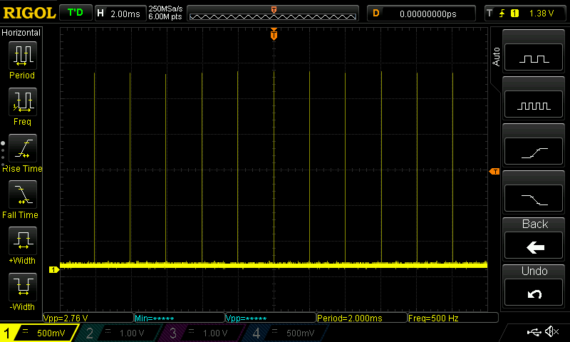

As expected, the ADC data ready pin signal shows the 500Hz frequency.

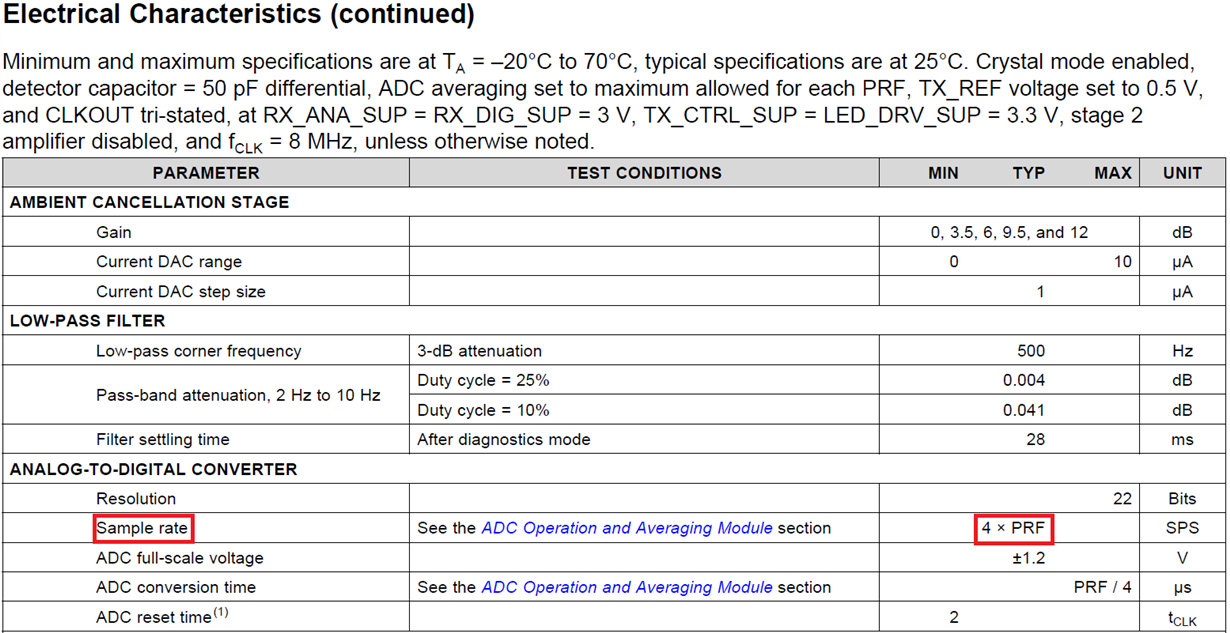

Is the PRF (Pulse repetition frequency) value identical to the sampling frequency (Fs) when calculating the frequency of "LED2-ALED2VAL" samples?
Or, as described in the datasheet, is Fs == 4 x PRF or Fs = NUMAV[7:0] x PRF? I wish to double check.
3. Lastly, if
Fs == 4 x PRF
why is 4 multiplied?

    2) PRF is the sampling frequency.
    3) Since in one PRF cycle, ADC converts the output of 4 phases ( LED2, ALED2, LED1, ALED1). The rate of ADC conversion is 4*PRF.
    But as long as you are looking at only one phase at a time, the sampling frequency (Fs) = PRF, as that phase is converted only once in a PRF cycle.

    - I read all 6 data registers of AFE4403 (LED2VAL, ALED2VAL, LED1VAL, ALED1VAL, LED2-ALED2VAL, LED1-ALED1VAL) when the data ready pin is triggered.
    - I buffer those 6 data in an integer array. I store total 1,536 (256 reading * 6 data).
    - The timing values (LED2STC, LED2ENDC, and more) are the same from the AFE4403EVM FW SRCv2.3 code.
    - The PRF is set to 500 Hz
    If I read all 6 data after the data ready pin is triggered, am I looking all the phases (LED2 sample phase, Ambient sample phase, LED1 sample phase, Ambient sample phase, LED2 convert phase, Ambient convert phases, LED1 convert phase)?

  • Hi David,
    In a given PRF sample there are 4 active phases . They are LED2, ALED2, LED1 and ALED1. For each of those 4 phases there are individual sampling window and ADC conversion window ( i.e. 4 sampling pulses and 4 ADC conversion pulses).
    Since ADC ( single ADC is inside the chip ) is used 4 times in a PRF, the output of ADC = 4 * PRF. But sampling/ conversion of a phases ( either LED2 or ALED2 or LED2 or ALED1) happens only once in a PRF, the sampling frequency is same as PRF.
    So while taking the FFT the sampling frequency will be PRF.
