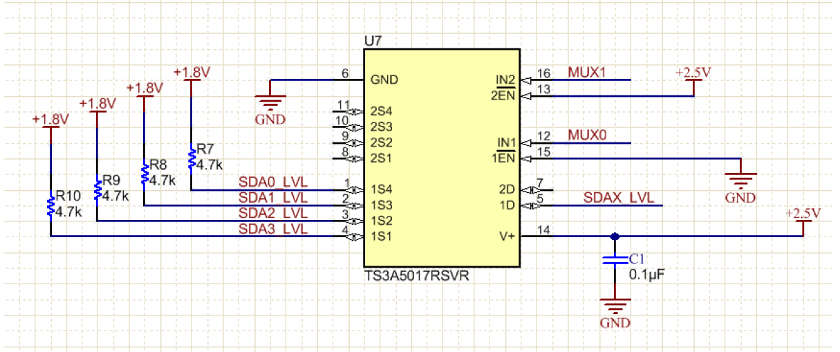

I'm planning to use multiple LDC2114.
Because they all have the same I2C address, I plan to proceed like this:
  • On startup all LDC2114s are disabled, by disconnecting Vcc using FETs
  • Then one after the other LDC2114 will be enabled, configured by writing the config registers via I2C and disabled.
  • After all LDC2114s are configured, all LDC2114 will be enabled and I2C communication won't be used anymore
  • Out-Pins of LDC2114 will be used.
Will the registers of LDC2114 be set to default after a reset?
