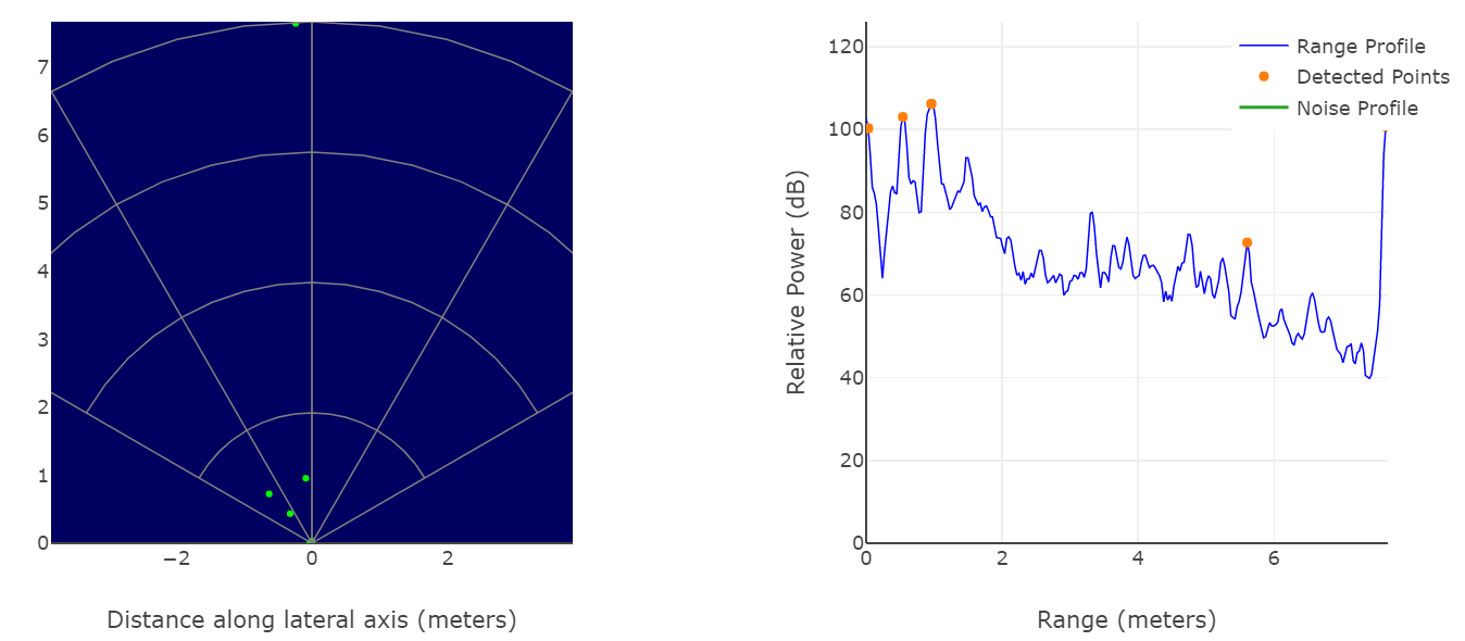

I am working on a simple object detection using IWR1642. I was able to read the data port for the received data from IWR1642 EVM.
The data I receive on the Data port, I have parsed ( using python) and formatted as per  - https://e2e.ti.com/cfs-file/__key/communityserver-discussions-components-files/1023/4201.DataStructure_5F00_table.pdf
The data starts with the 8 byte magic word which I am able to receive and parse correctly. In the same way I have read the other bytes and the data doesn't match with the detected objects in mmWave Visualiser.
I am attaching the data received by my program( python) and a picture of the detected objects ( XY PLot and Range for zero doppler) in mmWave Visualiser.
The visualiser shows 4 detected objects at ( -0.302,0.434) , (-0.62,0.725),(-0.843,0.955) ...
My program shows 5 detected objects bu the coordinates do not match with the ones in Visualiser
What is the format of the co-ordinates and am I missing something here?

  • Hello Anup,
    The issue may come from the fact the document you refer to above is related to the SDK 1.0.0 version when you may be using the latest SDK, 1.1.0, which follows a slightly different structure for the UART data. Please refer to the mmWave Demo Doxygen documentation: file C:\ti\mmwave_sdk_01_01_00_02\packages\ti\demo\xwr16xx\mmw\docs\doxygen\html\index.html and under the header "Output information sent to host".
    François.

  • Hi Anup,
    Please move to the SDK 1.1. Not only it fixes a number of known problems, but it adds some very useful new features such as the sensor calibration.
    If a data structure contains a integer value V in Qn format, it corresponds to a real value of V / 2^n.
