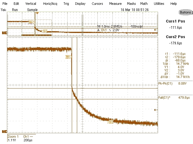

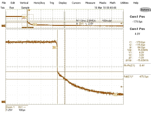

    I have verified that the PGA450-Q1 itself is not maintaining/holding any capacitive charge that would cause the VPWR ramp-down rate to be >=1V/ms. I used the PGA450-Q1EVM-S at a supply voltage of 8V to run this test instead of using the fullscale PGA450-Q1EVM to mitigate potential effects of supporting hardware components.
    Without any capacitance at VPWR and the power supply connected directly to VPWR, a mechanical disconnect of the supply itself yields a ramp-down of 64us from 4-3V (critical ramp-down region) at VPWR. When connecting the supply through the reverse battery protection diode (D2), there is no significant impact on the ramp-down rate without capacitance.
    Supply at VPWR:
    Supply at EVM-S J2 connector:
    With the supply still connected to J2 through the diode D2 to VPWR, I then added capacitance in parallel to the VPWR pin. Using standard decouple capacitor values of 0.01uF, 0.1uF, and 1uF, the maximum allowable capacitance was found to be <1uF to enable a 1V/1ms ramp-down on this setup:
    0.01uF at VPWR = 30us (GOOD)
    0.1uF at VPWR = 294us (GOOD)
    1uF at VPWR = 3ms (VIOLATION)

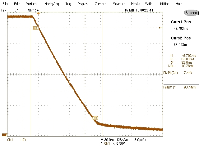

    A mechanical disconnect of the supply voltage was required because the bench supply itself has a slow-ramp down rate of 1V/12ms. Perhaps your high-side supply has a slow ramp-down rate in isolation. Here are two examples of the activity at VPWR when using the Output On/Off button feature of my power supply instead of physically disconnecting the supply (no difference at 4 to 3V ramp-down):
    VPWR when supply at VPWR (Cap 0.1uF)
    VPWR when supply at J2 connector through D2 (Cap 0.1uF)
    If you are unable to remove/reduce the 10uF capacitor at VPWR, or your itself supply is not at fault, then you can also consider adding a switch to float or ground the bleed-resistor. Effectively, you would need to use a GPIO (either from the PGA450 or external MCU) to drive/close a low-side nFET switch just prior to or simultaneously to shut-down of the pMOS so that the bleed resistor is not constantly sinking current during standard operation.
    I assume your pFET is switching fast enough to prevent a slow disconnect between your supply and PGA450-Q1. If not, this could also have an impact on the ramp-down rate.
