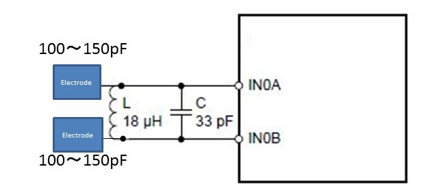

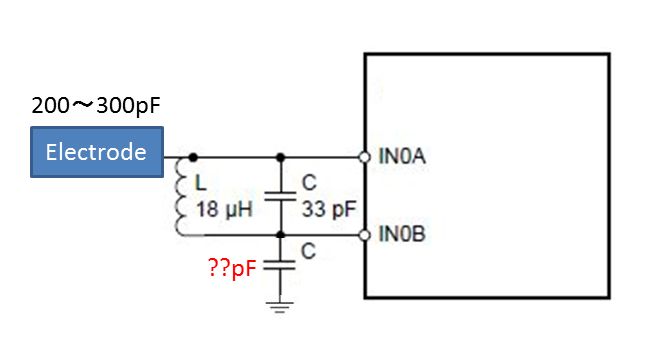

     Does your comment "balance it by adding a capacitor to IN0B and GND" mean following figure?
    How size of capacitor(pF) should I try to add??
    Several dozen or hundred pF??
     Does your comment "splitting the electrode in half and connecting on half to IN0A and the other to IN0B" mean following figure?
    If I split in half size, does the amount of capacitor value be half?
    If I have a misunderstanding, could you make it correct?

  • Hi ttd,
    Yes, you are correct.
    For the first configuration, the C from IN0B to GND should be around the same value as your nominal electrode capacitance.
    For the second configuration, the electrodes capacitance should be halved.
