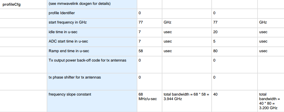

    My second doubt is in profielCfg the values after frequency parameters, are default as shown in sdk user guide-
    But in my above cfg parameter list(profileCfg 0 77 267 7 57.14 0 0 70 1 240 4884 0 0 30), values are found from mmwave demo gui app. Which are correct?

    On your second question, the values supplied in the mmWave Sensor Configuration commands (profileCfg, frameCfg, chirpCfg etc) depend upon the desired scene  parameters such as max range, max velocity, range resolution, velocity resolution, RCS of the object etc. The values given in the sdk user guide are as you said, the default values. The values you see in the configuration from mmwave demo gui, are based on the desired scene parameters selected in the GUI. Both values are correct. I would recommend you to go through the following app note to understand how the scene parameters are translated to chirp parameters:
    Programming Chirp Parameters in TI Radar Devices
    We also have the mmWave Sensing Estimator tool which takes the application level parameters (such as range, velocity etc) as input and generates the corresponding profile and frame configuration parameters which are then plugged into the above commands to configure the sensor for the desired scene configurations.
