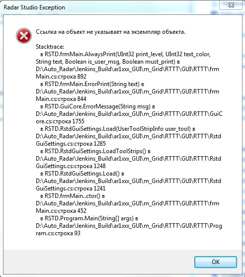

When I start Radar studio I see an error and the program does not start

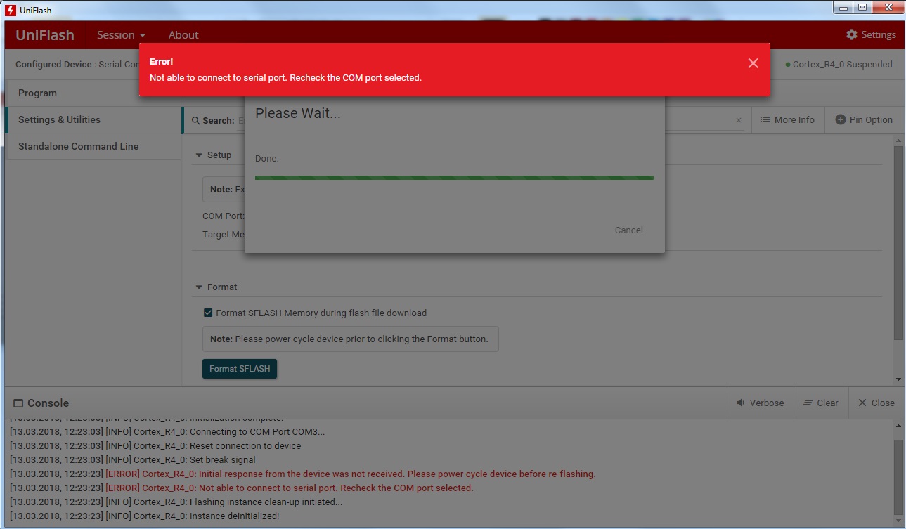

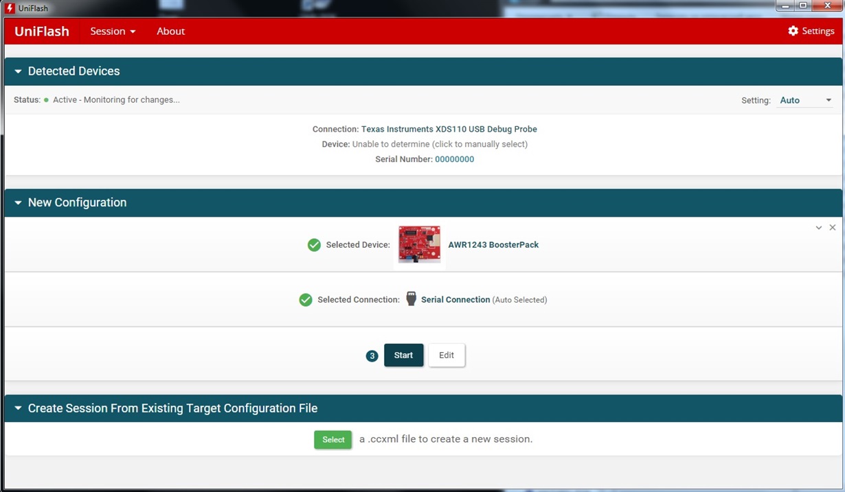

When I start Uniflash then I see the XDS110 device
When formatting SFLASH I see an error. Jumpers in position 101

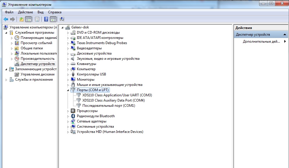

    Can you please share the COM ports you see from the Device Manager on your PC?

  • Hi, Cesar.
    COM ports:

    Which version of the Matlab Runtime Engine did you install? You need to have version 8.5.1 (32-bit) installed. You can download this version from this page: www.mathworks.com/.../matlab-runtime.html
    When open Uniflash, what are the steps that you take? I would recommend using the "New Configuration" option and select "mmWave" from the category and then select "AWR1243" and then select "Start".
    From your Device Manger, you will need to find out which COM port corresponds to the Application/User UART port.
    Using this COM port number, you will enter it in UniFlash. Navigate to the "Settings and Utilities" section located on the left side of the UniFlash tool. Under the setup area, enter in the COM port number you identified earlier.
    From a hardware standpoint, ensure that jumpers are placed on SOP2 and SOP0 when attempting to flash the EVM. These jumpers need to be placed before powering up the device. And once the device is flashed, remove SOP0 so that the EVM can load your application from flash.

  • Hi, Kyle.
    One problem is solved. I turned off the power before installing the jumper.
    I was able to install the firmware on the device.
    The problem with Radar Studio has remained.
    I have Matlab Runtime Engine version 8.5.1 (32-bit)

    I reinstalled MatLab Run Time on your link, but it did not help. Radar Studio does not start.

  • Kyle,
    Rafar Studio is run on another PC without the mmwave-devpack. I do not know why it does not start on my PC.
    Andrey
  • Andrey,
    It appears then that we have resolved this issue since you are able to get it to work on a different PC. Let us know if you have any additional questions otherwise this thread will be considered resolved.
