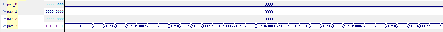

  3. Value Rollover -> I have included some graphics below.  My first test had different starting and increment values but I could not make sense of what was coming across the line, so I simplified to have one channel I values increment and all the rest be zero.  When I receive the data the RX3 I channel increments by 1 but it restarts back at 0 after reaching a count of 7.
  4. Random Values -> I have attached a chipscope plot data after shift register, and a hex editor view of data collected (hex editor data is packed RX0-3 I, RX0-3 Q).  Again RX0-2 I/Q are all zeros but RX3 Q seems to be a random starting value and it random toggles to a different value.

    3) Value Rollover -> I have included some graphics below. My first test had different starting and increment values but I could not make sense of what was coming across the line, so I simplified to have one channel I values increment and all the rest be zero. When I receive the data the RX3 I channel increments by 1 but it restarts back at 0 after reaching a count of 7.
    4) Random Values -> I have attached a chipscope plot data after shift register, and a hex editor view of data collected (hex editor data is packed RX0-3 I, RX0-3 Q). Again RX0-2 I/Q are all zeros but RX3 Q seems to be a random starting value and it random toggles to a different value.
    <TI> The TestApttern Gen Timing is set to a very high sampling rate which the LVDS cannot handle. The data rate should be kept much lesser than the LVDS output rate so that all the data can be transferred out before it gets over written. In your example you are setting 200Msps with complex 4 channels. ie will give a data rate of 25600 Mbits/sec. But the LVDS rate (4 lanes) is only 600*4=2400Mbits/sec. So you need to reduce the sampling clock rate.
