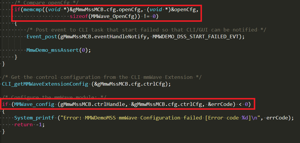

If I send the cmd(StartCommandLine), it will hardcode the configuration(pre-set).
It's success for the first time.
But it will fail for second time.
I see the error is from MmwDemo_mssDataPathConfig.
--CLI_getMMWaveExtensionOpenConfig (&gMmwMssMCB.cfg.openCfg);
--CLI_getMMWaveExtensionOpenConfig (&openCfg);
When they'are different, it will be error.
If I want to use my CLI.
How can I to avoid the error?

    Yes,I define a new CLI command.
    The new CLI command can load the radar configuration which I set in hardware.
    It's OK in the first time. AWR1642 will use the command.
    But it's fail in the second time.
    Compare openCfg will fail in mms_main.c(line:1297;sdk:1.1.0.2)
    Configure the mmWave module will also fail in mss_main.c(line:1311)

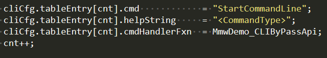

    Below,it's my new CLi command.

    static int32_t MmwDemo_CLIByPassApi (int32_t argc, char* argv[])
    /* Sanity Check: Minimum argument check */
    if (argc != 2)
    CLI_write ("Error: Invalid usage of the CLI command\n");
    return -1;

    Jui Yang
  • You don't mention how it fails. If it fails because of a memory allocation error or MMWave error, then you haven't completely undone what the first configuration performed.  If it fails because of a bad configuration, then you should compare the contents of gMmwMssMCB after the first and second tries.
