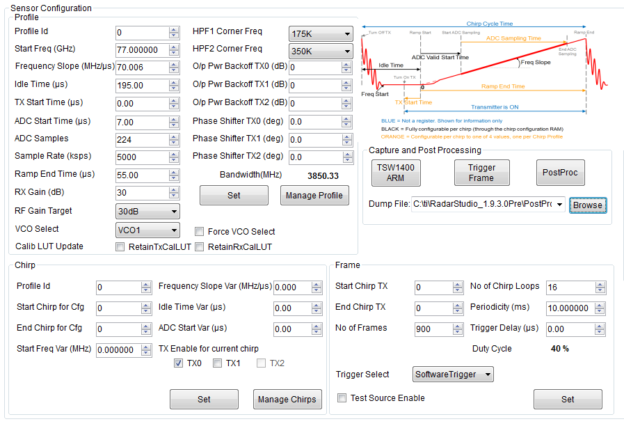

I'm capturing samples using TSW1400 and Radar studio. I'm wondering the min/max value for the number of frames and chirps, and the periodicity of a frame.
I saw a thread that the total frame time should not exceed 10 seconds. But it seems the number of chirp also plays a roll.
For example, the following setup is NOT working
No of frames = 900, Periodicity = 10ms (total time = 9s <10s), no of chirp = 16    =====> no sample captured
Changing the number of chirp solves the issue.
No of frames = 900, Periodicity = 10ms (total time = 9s <10s), no of chirp = 20    =====> sample captured
Is there a document telling the secret?
