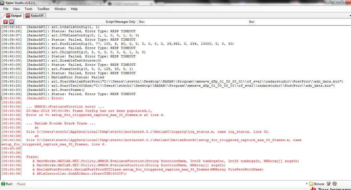

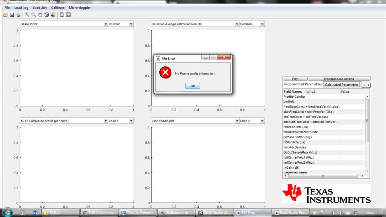

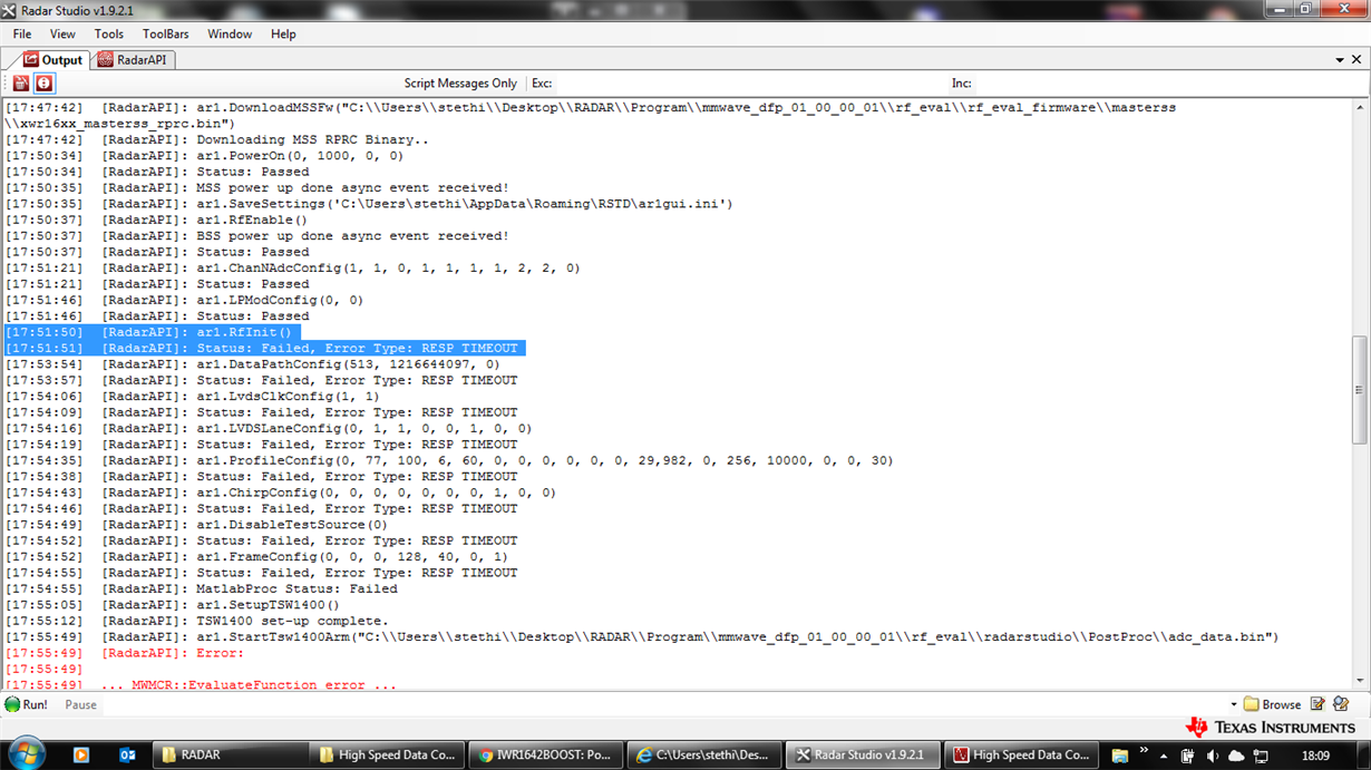

Hi TI Team,
I have an IWR1624 and mmWave Dev-Pack. I use Radar Studio to observe the Radar EVM behavior but when I boot up Post Processing, I get :
Here is the display console when I config Radar Studio :
I installed :
Matlab RunTime Engin
mmWave_dpf_01_00_00_01
FTDI Drivers
HSDC Pro
So, I have 2 questions :
What is the problem ?
What is the fonction mmWave Dev-Pack in particular ?
Thank you in advance for your assistance.
Clément.
    Depending on the mmwave programming, the LVDS outputs which are captured on the TSW1400 are then sent for post processing.   There are a lot of buttons to click, on the Connection, Static Config, Data Config, and Sensor Config tabs.  (a - please try to use this example, place a 12oz aluminum beverage can, full of water or soda, 3 meters to the left of the center of the EVM, 3 meters from the EVM.

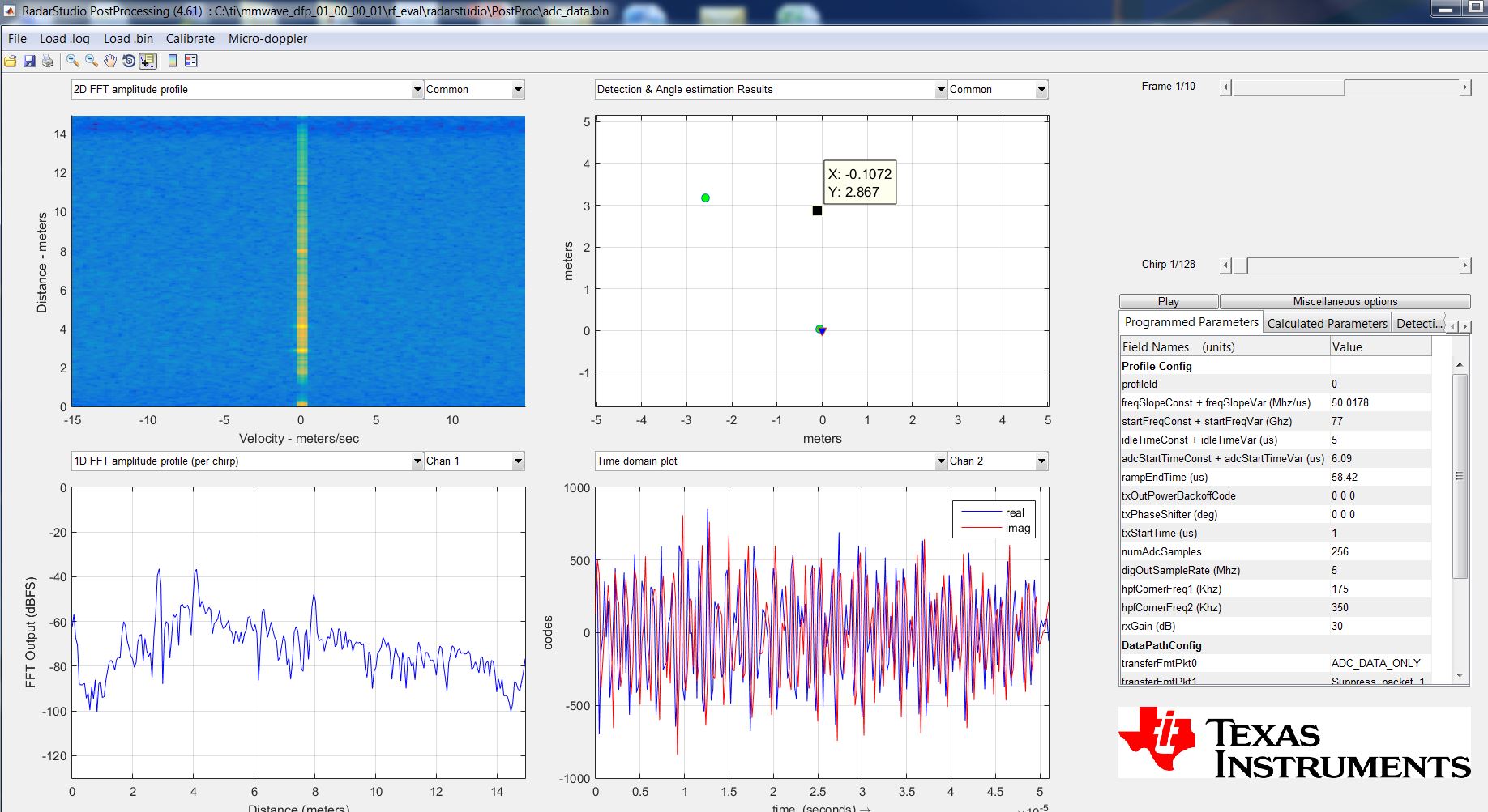

    We will start with a known configuration, this works for me.
    The Devpack allows the BP/LP control of the mmwave EVM.   Please see the EVM schematic page 10.
    SOP control, MCU_nRST, Control UART flashing if used, SPI command interface.
    The Devpack with the blue cable to the mmwave EVM, transfers the LVDS data to the TSW1400.
    In my example I have a radar target, 3 meters to the left of the center, 3 meters from the radar  sensor.

    I don't have the TSW1400 device. Can I used Post Processing ?
    I followed your configuration but it's not work...
  • When I click on "RfInit", there are a lot of errors :
    In the radar studio, you can use the EVM and Devpack for configuration.
    However to evaluate the Radar Rx for Post Processing, you also need the TSW1400.
    Only needs the EVM and software:
    Alternately, you can use the mmwave SDK, data capture demo, to collect the Radar Rx data.
    Alternately, you can use the mmwave SDK, demo, and the PC-Visualizer to see the detected objects and other displays.
