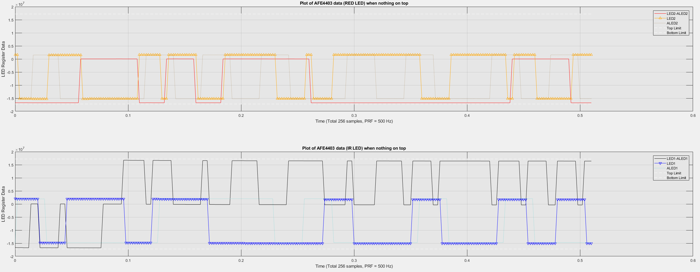

These are my 3 cases.

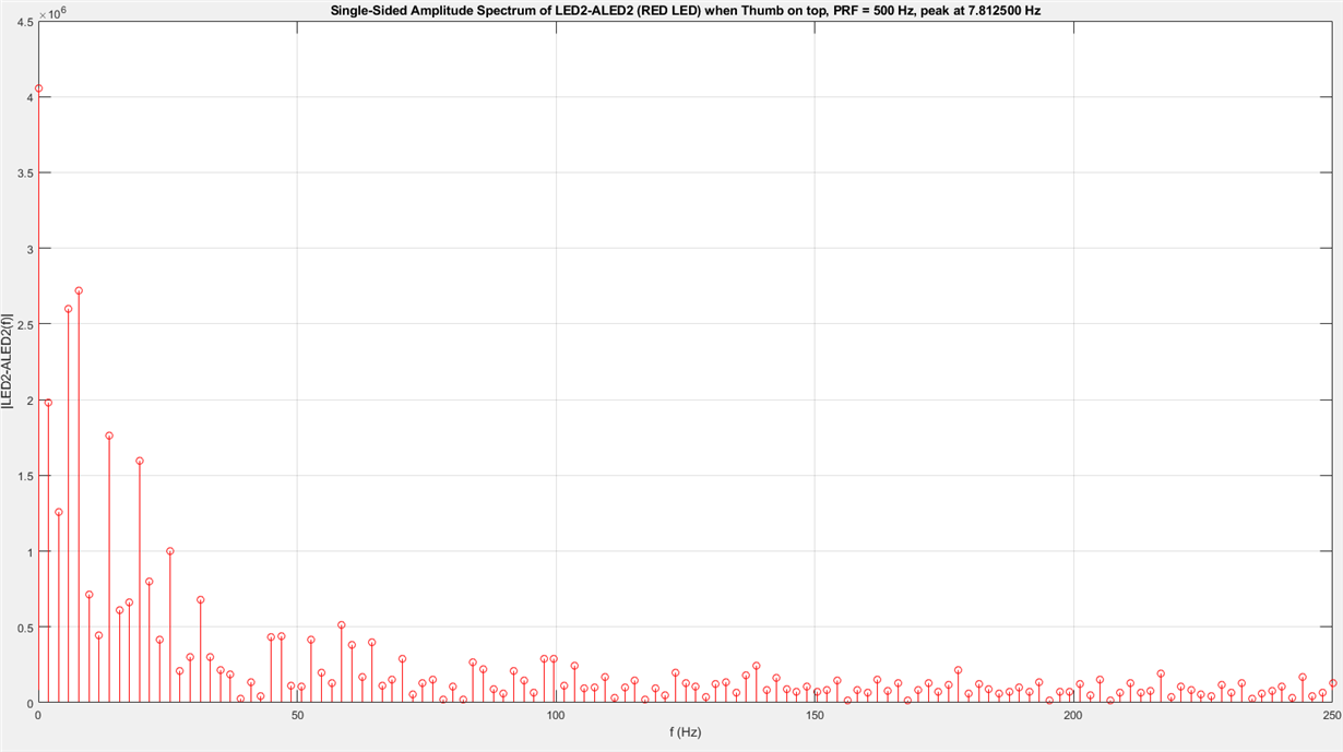

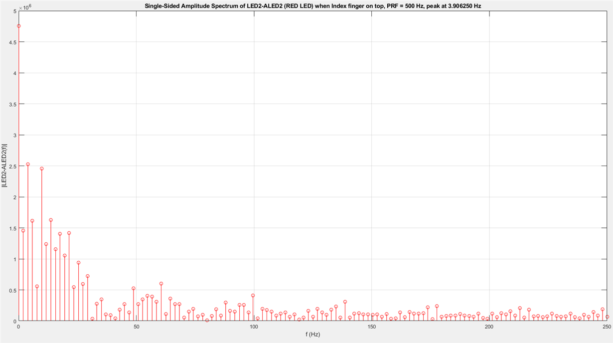

1. Place nothing on top of SPH7050
2. Place my thumb on SPH7050
3. Place my index finger on SPH7050

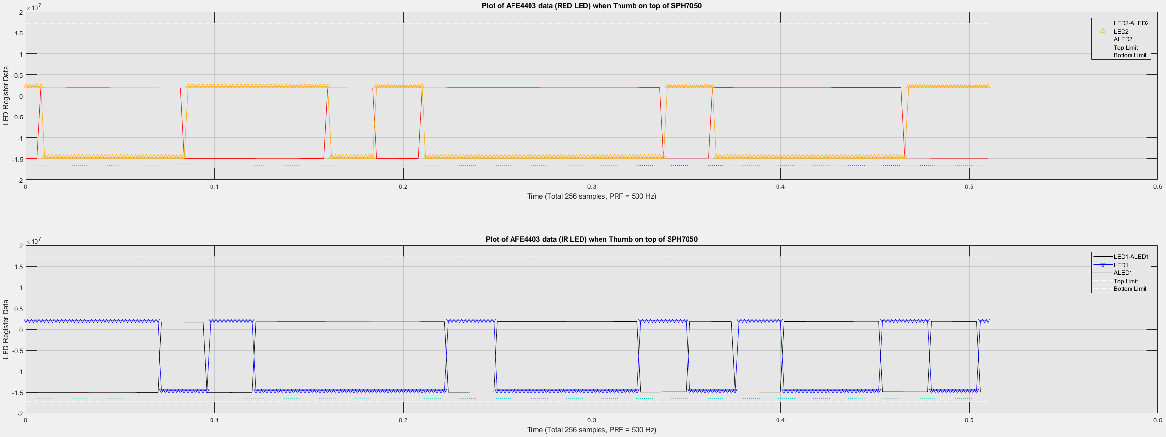

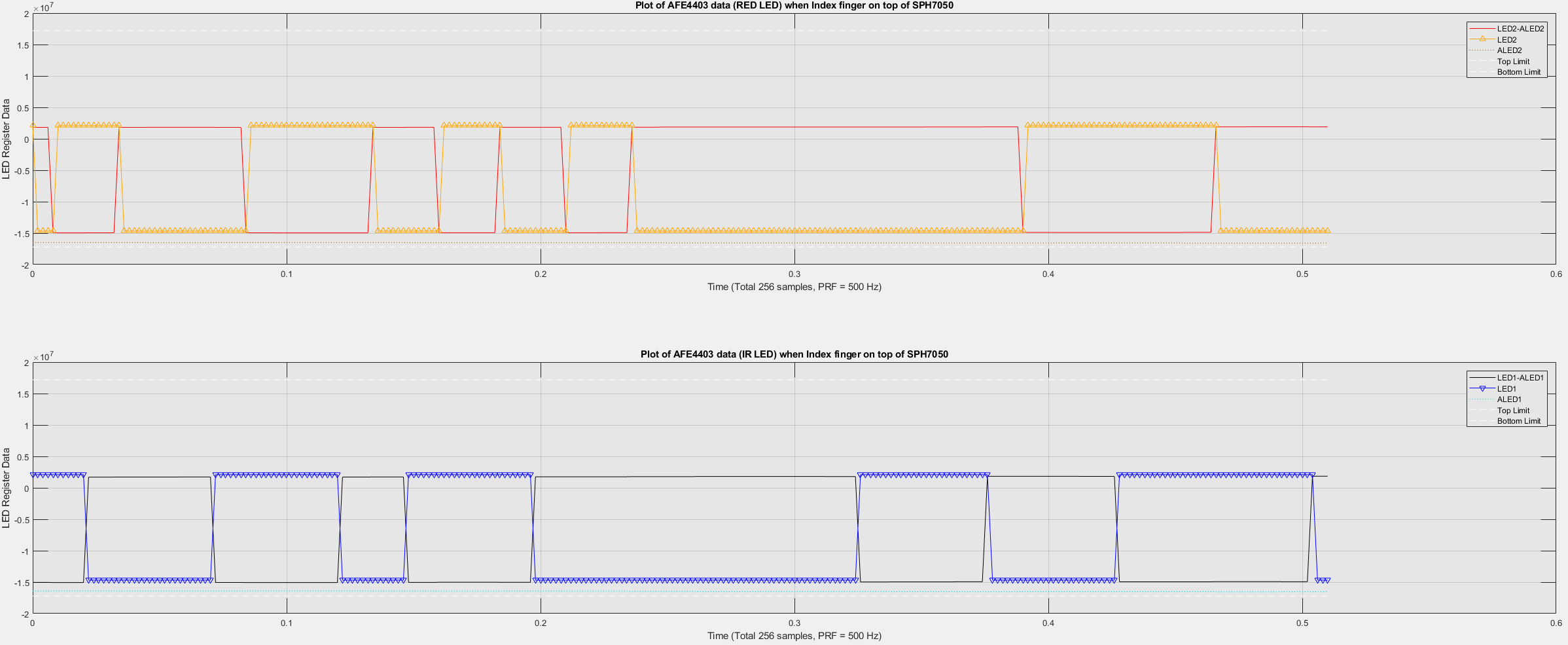

As you see, regardless of what finger is placed, the pattern seems almost identical when using SPH7050's Red LED.
Most importantly, each data repeats;
For instance LED2-ALED2 repeats
0x001B C719   0x001B C719   0x001B C719   0x001B C719   0xFF1B C719   0xFF1B C719   0xFF1B C719   0xFF1B C719...
-16422688	-16422688	-16422688	-16422688	-16391939	-16391939	-16391939	-16391939	-16391939	-16391939	-16391939	-16391939	-16391939	-16391939	-16391939	-16391939	-16391939	-16400942	-16400942	-16400942	-16400942	-16400942	-16400942	-16400942	-16400942	-16400942	-16400942	-16400942	-16400942	-16400942	-16407192	-16407192	-16407192	-16407192	-16407192	-16407192	-16407192	-16407192	-16407192	-16407192	-16407192	-16407192	-16391931	-16391931	-16391931	-16391931	-16391931	-16391931	-16391931	-16391931	-16391931	-16391931	-16391931	-16391931	-16391931	-16394655	-16394655	-16394655	-16394655	-16394655	-16394655	-16394655	-16394655	-16394655	-16394655	-16394655	-16394655	-16418420	-16418420	-16418420	-16418420	-16418420	-16418420	-16418420	-16418420	-16418420	-16418420	-16418420	-16418420	-16418420	-16441471	-16441471	-16441471	-16441471	-16441471	-16441471	-16441471	-16441471	-16441471	-16441471	-16441471	-16441471	-16436692	-16436692	-16436692	-16436692	-16436692	-16436692	-16436692	-16436692	-16436692	-16436692	-16436692	-16436692	-16436692	-16442813	-16442813	-16442813	-16442813	-16442813	-16442813	-16442813	-16442813	-16442813	-16442813	-16442813	-16442813	-16442813	-16466784	-16466784	-16466784	-16466784	-16466784	-16466784	-16466784	-16466784	-16466784	-16466784	-16466784	-16466784	-16466784	-16491990	-16491990	-16491990	-16491990	-16491990	-16491990	-16491990	-16491990	-16491990	-16491990	-16491990	-16491990	-16491990	-16485076	-16485076	-16485076	-16485076	-16485076	-16485076	-16485076	-16485076	-16485076	-16485076	-16485076	-16485076	-16483876	-16483876	-16483876	-16483876	-16483876	-16483876	-16483876	-16483876	-16483876	-16483876	-16483876	-16483876	-16483876	-16495422	-16495422	-16495422	-16495422	-16495422	-16495422	-16495422	-16495422	-16495422	-16495422	-16495422	-16495422	-16495422	-16517956	-16517956	-16517956	-16517956	-16517956	-16517956	-16517956	-16517956	-16517956	-16517956	-16517956	-16517956	-16517956	-16510605	-16510605	-16510605	-16510605	-16510605	-16510605	-16510605	-16510605	-16510605	-16510605	-16510605	-16510605	-16510605	-16504867	-16504867	-16504867	-16504867	-16504867	-16504867	-16504867	-16504867	-16504867	-16504867	-16504867	-16504867	-16512637	-16512637	-16512637	-16512637	-16512637	-16512637	-16512637	-16512637	-16512637	-16512637	-16512637	-16512637	-16512637	-16534308	-16534308	-16534308	-16534308	-16534308	-16534308	-16534308	-16534308	-16534308	-16534308	-16534308	-16534308	-16534308	-16528452	-16528452	-16528452	-16528452	-16528452	-16528452	-16528452	-16528452	-16528452	-16528452
-16500736	-16500736	-16500736	-16500736	-16500736	-16500736	-16500736	-16500736	-16500736	-16500736	-16500736	-16505311	-16505311	-16505311	-16505311	-16505311	-16505311	-16505311	-16505311	-16505311	-16505311	-16505311	-16505311	-16521631	-16521631	-16521631	-16521631	-16521631	-16521631	-16521631	-16521631	-16521631	-16521631	-16521631	-16521631	-16521631	-16508676	-16508676	-16508676	-16508676	-16508676	-16508676	-16508676	-16508676	-16508676	-16508676	-16508676	-16508676	-16508676	-16499446	-16499446	-16499446	-16499446	-16499446	-16499446	-16499446	-16499446	-16499446	-16499446	-16499446	-16499446	-16502151	-16502151	-16502151	-16502151	-16502151	-16502151	-16502151	-16502151	-16502151	-16502151	-16502151	-16502151	-16502151	-16520646	-16520646	-16520646	-16520646	-16520646	-16520646	-16520646	-16520646	-16520646	-16520646	-16520646	-16520646	-16519738	-16519738	-16519738	-16519738	-16519738	-16519738	-16519738	-16519738	-16519738	-16519738	-16519738	-16519738	-16519738	-16517975	-16517975	-16517975	-16517975	-16517975	-16517975	-16517975	-16517975	-16517975	-16517975	-16517975	-16517975	-16517975	-16529387	-16529387	-16529387	-16529387	-16529387	-16529387	-16529387	-16529387	-16529387	-16529387	-16529387	-16529387	-16529387	-16556467	-16556467	-16556467	-16556467	-16556467	-16556467	-16556467	-16556467	-16556467	-16556467	-16556467	-16556467	-16558997	-16558997	-16558997	-16558997	-16558997	-16558997	-16558997	-16558997	-16558997	-16558997	-16558997	-16558997	-16558997	-16549447	-16549447	-16549447	-16549447	-16549447	-16549447	-16549447	-16549447	-16549447	-16549447	-16549447	-16549447	-16549447	-16553484	-16553484	-16553484	-16553484	-16553484	-16553484	-16553484	-16553484	-16553484	-16553484	-16553484	-16553484	-16553484	-16574756	-16574756	-16574756	-16574756	-16574756	-16574756	-16574756	-16574756	-16574756	-16574756	-16574756	-16574756	-16574756	-16579831	-16579831	-16579831	-16579831	-16579831	-16579831	-16579831	-16579831	-16579831	-16579831	-16579831	-16579831	-16566609	-16566609	-16566609	-16566609	-16566609	-16566609	-16566609	-16566609	-16566609	-16566609	-16566609	-16566609	-16566609	-16566180	-16566180	-16566180	-16566180	-16566180	-16566180	-16566180	-16566180	-16566180	-16566180	-16566180	-16566180	-16566180	-16586358	-16586358	-16586358	-16586358	-16586358	-16586358	-16586358	-16586358	-16586358	-16586358	-16586358	-16586358	-16586358	-16594258	-16594258	-16594258	-16594258	-16594258	-16594258	-16594258	-16594258	-16594258	-16594258	-16594258	-16594258	-16594258	-16576397	-16576397	-16576397
2096921	2096921	2096921	2096921	2096921	2096921	2096921	2096921	2096921	2096921	2096921	-14680295	-14680295	-14680295	-14680295	-14680295	-14680295	-14680295	-14680295	-14680295	-14680295	-14680295	-14680295	-14680295	-14680295	-14680295	-14680295	-14680295	-14680295	-14680295	-14680295	-14680295	-14680295	-14680295	-14680295	-14680295	2096921	2096921	2096921	2096921	2096921	2096921	2096921	2096921	2096921	2096921	2096921	2096921	2096921	2096921	2096921	2096921	2096921	2096921	2096921	2096921	2096921	2096921	2096921	2096921	2096921	-14680295	-14680295	-14680295	-14680295	-14680295	-14680295	-14680295	-14680295	-14680295	-14680295	-14680295	-14680295	-14680295	2096921	2096921	2096921	2096921	2096921	2096921	2096921	2096921	2096921	2096921	2096921	2096921	2096921	2096921	2096921	2096921	2096921	2096921	2096921	2096921	2096921	2096921	2096921	2096921	2096921	-14680295	-14680295	-14680295	-14680295	-14680295	-14680295	-14680295	-14680295	-14680295	-14680295	-14680295	-14680295	-14680295	-14680295	-14680295	-14680295	-14680295	-14680295	-14680295	-14680295	-14680295	-14680295	-14680295	-14680295	-14680295	-14680295	-14680295	-14680295	-14680295	-14680295	-14680295	-14680295	-14680295	-14680295	-14680295	-14680295	-14680295	-14680295	-14680295	-14680295	-14680295	-14680295	-14680295	-14680295	-14680295	-14680295	-14680295	-14680295	-14680295	-14680295	-14680295	-14680295	-14680295	-14680295	-14680295	-14680295	-14680295	-14680295	-14680295	-14680295	-14680295	-14680295	-14680295	-14680295	2096921	2096921	2096921	2096921	2096921	2096921	2096921	2096921	2096921	2096921	2096921	2096921	2096921	2096921	2096921	2096921	2096921	2096921	2096921	2096921	2096921	2096921	2096921	2096921	2096921	2096921	-14680295	-14680295	-14680295	-14680295	-14680295	-14680295	-14680295	-14680295	-14680295	-14680295	-14680295	-14680295	-14680295	-14680295	-14680295	-14680295	-14680295	-14680295	-14680295	-14680295	-14680295	-14680295	-14680295	-14680295	-14680295	2096921	2096921	2096921	2096921	2096921	2096921	2096921	2096921	2096921	2096921	2096921	2096921	2096921	2096921	2096921	2096921	2096921	2096921	2096921	2096921	2096921	2096921	2096921	2096921	2096921	2096921	2096921	2096921	2096921	2096921	2096921	2096921	2096921	2096921	2096921	2096921	2096921	2096921	2096921	-14680295	-14680295	-14680295
-15034823	-15034823	-15034823	-15034823	-15065572	-15065572	-15065572	-15065572	-15065572	-15065572	-15065572	1711644	1711644	1711644	1711644	1711644	1711644	1720647	1720647	1720647	1720647	1720647	1720647	1720647	1720647	1720647	1720647	1720647	1720647	1726897	1726897	1726897	1726897	1726897	1726897	1726897	-15050319	-15050319	-15050319	-15050319	-15050319	-15050319	-15065580	-15065580	-15065580	-15065580	-15065580	-15065580	-15065580	-15065580	-15065580	-15065580	-15065580	-15065580	-15065580	-15062856	-15062856	-15062856	-15062856	-15062856	-15062856	1714360	1714360	1714360	1714360	1714360	1714360	1738125	1738125	1738125	1738125	1738125	1738125	1738125	-15039091	-15039091	-15039091	-15039091	-15039091	-15039091	-15016040	-15016040	-15016040	-15016040	-15016040	-15016040	-15016040	-15016040	-15016040	-15016040	-15016040	-15016040	-15020819	-15020819	-15020819	-15020819	-15020819	-15020819	-15020819	1756397	1756397	1756397	1756397	1756397	1756397	1762518	1762518	1762518	1762518	1762518	1762518	1762518	1762518	1762518	1762518	1762518	1762518	1762518	1786489	1786489	1786489	1786489	1786489	1786489	1786489	1786489	1786489	1786489	1786489	1786489	1786489	1811695	1811695	1811695	1811695	1811695	1811695	1811695	1811695	1811695	1811695	1811695	1811695	1804781	1804781	1804781	1804781	1804781	1804781	1804781	1804781	1804781	1804781	1804781	1804781	1804781	1803581	1803581	1803581	1803581	1803581	1803581	1803581	-14973635	-14973635	-14973635	-14973635	-14973635	-14973635	-14962089	-14962089	-14962089	-14962089	-14962089	-14962089	-14962089	-14962089	-14962089	-14962089	-14962089	-14962089	-14962089	-14939555	-14939555	-14939555	-14939555	-14939555	-14939555	1837661	1837661	1837661	1837661	1837661	1837661	1837661	1830310	1830310	1830310	1830310	1830310	1830310	1830310	1830310	1830310	1830310	1830310	1830310	1824572	1824572	1824572	1824572	1824572	1824572	1824572	-14952644	-14952644	-14952644	-14952644	-14952644	-14952644	-14944874	-14944874	-14944874	-14944874	-14944874	-14944874	-14944874	-14944874	-14944874	-14944874	-14944874	-14944874	-14944874	-14923203	-14923203	-14923203	-14923203	-14923203	-14923203	-14923203	-14923203	-14923203	-14923203	-14923203	-14923203	-14923203	-14929059	-14929059	-14929059	-14929059	-14929059	-14929059	1848157	1848157	1848157	1848157
2096921	-14680295	-14680295	-14680295	-14680295	2096921	2096921	2096921	2096921	2096921	2096921	2096921	2096921	2096921	2096921	2096921	2096921	2096921	-14680295	-14680295	-14680295	-14680295	-14680295	-14680295	-14680295	-14680295	-14680295	-14680295	-14680295	-14680295	-14680295	-14680295	-14680295	-14680295	-14680295	-14680295	-14680295	-14680295	-14680295	-14680295	-14680295	-14680295	-14680295	2096921	2096921	2096921	2096921	2096921	2096921	2096921	2096921	2096921	2096921	2096921	2096921	2096921	2096921	2096921	2096921	2096921	2096921	2096921	2096921	2096921	2096921	2096921	2096921	2096921	-14680295	-14680295	-14680295	-14680295	-14680295	-14680295	-14680295	-14680295	-14680295	-14680295	-14680295	-14680295	-14680295	2096921	2096921	2096921	2096921	2096921	2096921	2096921	2096921	2096921	2096921	2096921	2096921	-14680295	-14680295	-14680295	-14680295	-14680295	-14680295	-14680295	-14680295	-14680295	-14680295	-14680295	-14680295	-14680295	2096921	2096921	2096921	2096921	2096921	2096921	2096921	2096921	2096921	2096921	2096921	2096921	2096921	-14680295	-14680295	-14680295	-14680295	-14680295	-14680295	-14680295	-14680295	-14680295	-14680295	-14680295	-14680295	-14680295	-14680295	-14680295	-14680295	-14680295	-14680295	-14680295	-14680295	-14680295	-14680295	-14680295	-14680295	-14680295	-14680295	-14680295	-14680295	-14680295	-14680295	-14680295	-14680295	-14680295	-14680295	-14680295	-14680295	-14680295	-14680295	-14680295	-14680295	-14680295	-14680295	-14680295	-14680295	-14680295	-14680295	-14680295	-14680295	-14680295	-14680295	-14680295	-14680295	-14680295	-14680295	-14680295	-14680295	-14680295	-14680295	-14680295	-14680295	-14680295	-14680295	-14680295	-14680295	-14680295	-14680295	-14680295	-14680295	-14680295	-14680295	-14680295	-14680295	-14680295	-14680295	-14680295	-14680295	-14680295	2096921	2096921	2096921	2096921	2096921	2096921	2096921	2096921	2096921	2096921	2096921	2096921	2096921	2096921	2096921	2096921	2096921	2096921	2096921	2096921	2096921	2096921	2096921	2096921	2096921	2096921	2096921	2096921	2096921	2096921	2096921	2096921	2096921	2096921	2096921	2096921	2096921	2096921	-14680295	-14680295	-14680295	-14680295	-14680295	-14680295	-14680295	-14680295	-14680295	-14680295	-14680295	-14680295	-14680295	-14680295	-14680295	-14680295	-14680295	-14680295	-14680295	-14680295	-14680295	-14680295
1820441	1820441	1820441	1820441	-14956775	-14956775	-14956775	-14956775	-14956775	-14956775	-14956775	-14952200	-14952200	-14952200	-14952200	-14952200	-14952200	1825016	1825016	1825016	1825016	1825016	1825016	1841336	1841336	1841336	1841336	1841336	1841336	1841336	1841336	1841336	1841336	1841336	1841336	1841336	1828381	1828381	1828381	1828381	1828381	1828381	-14948835	-14948835	-14948835	-14948835	-14948835	-14948835	-14958065	-14958065	-14958065	-14958065	-14958065	-14958065	-14958065	-14958065	-14958065	-14958065	-14958065	-14958065	-14958065	-14955360	-14955360	-14955360	-14955360	-14955360	-14955360	1821856	1821856	1821856	1821856	1821856	1821856	1821856	1840351	1840351	1840351	1840351	1840351	1840351	-14936865	-14936865	-14936865	-14936865	-14936865	-14936865	-14937773	-14937773	-14937773	-14937773	-14937773	-14937773	1839443	1839443	1839443	1839443	1839443	1839443	1839443	1837680	1837680	1837680	1837680	1837680	1837680	-14939536	-14939536	-14939536	-14939536	-14939536	-14939536	-14939536	-14928124	-14928124	-14928124	-14928124	-14928124	-14928124	1849092	1849092	1849092	1849092	1849092	1849092	1876172	1876172	1876172	1876172	1876172	1876172	1876172	1876172	1876172	1876172	1876172	1876172	1876172	1878702	1878702	1878702	1878702	1878702	1878702	1878702	1878702	1878702	1878702	1878702	1878702	1878702	1869152	1869152	1869152	1869152	1869152	1869152	1869152	1869152	1869152	1869152	1869152	1869152	1869152	1873189	1873189	1873189	1873189	1873189	1873189	1873189	1873189	1873189	1873189	1873189	1873189	1873189	1894461	1894461	1894461	1894461	1894461	1894461	1894461	1894461	1894461	1894461	1894461	1894461	1899536	1899536	1899536	1899536	1899536	1899536	1899536	-14877680	-14877680	-14877680	-14877680	-14877680	-14877680	-14890902	-14890902	-14890902	-14890902	-14890902	-14890902	-14890902	-14890902	-14890902	-14890902	-14890902	-14890902	-14890902	-14891331	-14891331	-14891331	-14891331	-14891331	-14891331	-14891331	-14891331	-14891331	-14891331	-14891331	-14891331	-14891331	-14871153	-14871153	-14871153	-14871153	-14871153	-14871153	1906063	1906063	1906063	1906063	1906063	1906063	1906063	1913963	1913963	1913963	1913963	1913963	1913963	1913963	1913963	1913963	1913963	1913963	1913963	1896102	1896102	1896102	1896102
I have uploaded the data file. Also, each data are near the limit (2^24 or -2^24).
Is my sensor saturated? Should I change the settings for TIAGAIN and TIA_AMB_GAIN?
  • Hi David,
    Looking at the waveforms for the RED, it seems to be saturated at -1.2V.
    Have you connected cathode of photodiode to INP pin of AFE?
    You can remove the saturation by lowering the LED current and TIA_GAIN.
    Prabin.
  • Thanks, Prabin.
    Prabin Yadav said:
    it seems to be saturated at -1.2V. You can remove the saturation by lowering the LED current and TIA_GAIN.
    Thanks for pointing that out.
    Can you help me find the section in the datasheet where it explains the relationship between LED current, TIA_GAIN, and saturation?
    I wish to know why this module has become saturated at -1.2V, not to 1.2V.
    Well, I really wish to check this connection. But this custom module I bought doesn't have any test points or have a way to probe each INP pin (ball grid) and the cathode pin.
    I'm sorry that I cannot check this.

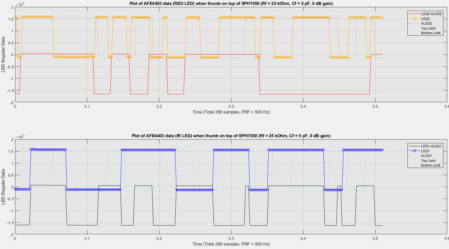

  • Prabin Yadav said:
    Yes, you can write lower values to those register to avoid the saturation.
    You can even lower the Rf, LED_RANGE.

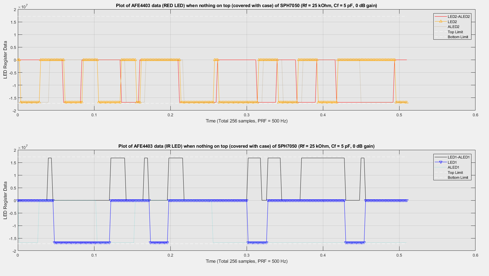

    Hi, Prabin. I changed the values as shown below;
    TIAGAIN - RF_LED1 = 25 k Ohm
    TIAGAIN - CF_LED1 = 5 pF
    TIAGAIN - stg2gain1= 0dB (stage2 enabled)
    TIA_AMB_GAIN - RF_LED2 = 25 k Ohm
    TIA_AMB_GAIN - CF_LED2 = 5 pF
    TIA_AMB_GAIN - stg2gain2= 0dB (stage2 enabled)
    TIA_AMB_GAIN - ambdac = 5uA
    LEDCNTRL - LED range = 01
    LEDCNTRL - LED1 = 0x04
    LEDCNTRL - LED2 = 0x04
    -1520733	-1520733	-1520733	-1520733	-1574915	-1574915	-1574915	-1574915	-1574915	-1574915	-1574915	-1574915	-1574915	-1574915	15202301	15202301	15202301	15155087	15155087	15155087	15155087	15155087	15155087	15155087	15155087	15155087	15155087	-1622129	-1622129	-1622129	-1678904	-1678904	-1678904	-1678904	-1678904	-1678904	-1678904	-1678904	-1678904	-1678904	-1678904	-1678904	-1640871	-1640871	-1640871	-1640871	-1640871	-1640871	-1640871	-1640871	-1640871	-1640871	15136345	15136345	15136345	15167478	15167478	15167478	15167478	15167478	15167478	15167478	15167478	15167478	-1609738	-1609738	-1609738	-1621870	-1621870	-1621870	-1621870	-1621870	-1621870	-1621870	-1621870	-1621870	-1621870	-1621870	-1621870	-1621870	-1676506	-1676506	-1676506	-1676506	-1676506	-1676506	-1676506	-1676506	-1676506	-1676506	15100710	15100710	15100710	15131341	15131341	15131341	15131341	15131341	15131341	15131341	15131341	15131341	-1645875	-1645875	-1645875	-1645875	-1608420	-1608420	-1608420	-1608420	-1608420	-1608420	-1608420	-1608420	-1608420	15168796	15168796	15168796	15167447	15167447	15167447	15167447	15167447	15167447	15167447	15167447	15167447	15167447	15167447	15167447	15167447	15107929	15107929	15107929	15107929	15107929	15107929	15107929	15107929	15107929	15107929	15107929	15107929	15107929	15124840	15124840	15124840	15124840	15124840	15124840	15124840	15124840	15124840	15124840	15124840	15124840	15124840	15168001	15168001	15168001	15168001	15168001	15168001	15168001	15168001	15168001	15168001	-1609215	-1609215	-1609215	-1602177	-1602177	-1602177	-1602177	-1602177	-1602177	-1602177	-1602177	-1602177	15175039	15175039	15175039	15114281	15114281	15114281	15114281	15114281	15114281	15114281	15114281	15114281	15114281	15114281	15114281	15114281	15116136	15116136	15116136	15116136	15116136	15116136	15116136	15116136	15116136	15116136	-1661080	-1661080	-1661080	-1611940	-1611940	-1611940	-1611940	-1611940	-1611940	-1611940	-1611940	-1611940	-1611940	15165276	15165276	15165276	15178941	15178941	15178941	15178941	15178941	15178941	15178941	15178941	15178941	15178941	-1598275	-1598275	-1598275	-1656964	-1656964	-1656964	-1656964	-1656964	-1656964	-1656964	-1656964	-1656964	-1656964	-1656964	-1656964	-1656964	-1670373	-1670373	-1670373	-1670373	-1670373	-1670373	-1670373	-1670373	-1670373
    15538431	15538431	15538431	15538431	15538431	15538431	15538431	15538431	15538431	15538431	15538431	15537490	15537490	15537490	15537490	15537490	15537490	15537490	15537490	15537490	15537490	15537490	15537490	15537490	15476761	15476761	15476761	15476761	15476761	15476761	15476761	15476761	15476761	-1300455	-1300455	-1300455	-1299428	-1299428	-1299428	-1299428	-1299428	-1299428	-1299428	-1299428	-1299428	-1299428	-1299428	-1299428	-1299428	-1244987	-1244987	-1244987	-1244987	-1244987	-1244987	-1244987	-1244987	-1244987	15532229	15532229	15532229	15538531	15538531	15538531	15538531	15538531	15538531	15538531	15538531	15538531	15538531	-1238685	-1238685	-1238685	-1294819	-1294819	-1294819	-1294819	-1294819	-1294819	-1294819	-1294819	-1294819	-1294819	-1294819	-1294819	-1294819	-1307809	-1307809	-1307809	-1307809	-1307809	-1307809	-1307809	-1307809	-1307809	-1307809	-1307809	-1307809	-1245684	-1245684	-1245684	-1245684	-1245684	-1245684	-1245684	-1245684	-1245684	-1245684	15531532	15531532	15531532	15540641	15540641	15540641	15540641	15540641	15540641	15540641	15540641	15540641	15540641	15540641	15540641	15540641	15490880	15490880	15490880	15490880	15490880	15490880	15490880	15490880	15490880	15490880	-1286336	-1286336	-1286336	-1312708	-1312708	-1312708	-1312708	-1312708	-1312708	-1312708	-1312708	-1312708	-1312708	15464508	15464508	15464508	15528664	15528664	15528664	15528664	15528664	15528664	15528664	15528664	15528664	15528664	15528664	15528664	15541421	15541421	15541421	15541421	15541421	15541421	15541421	15541421	15541421	15541421	-1235795	-1235795	-1235795	-1276284	-1276284	-1276284	-1276284	-1276284	-1276284	-1276284	-1276284	-1276284	-1276284	15500932	15500932	15500932	15463701	15463701	15463701	15463701	15463701	15463701	15463701	15463701	15463701	15463701	-1313515	-1313515	-1313515	-1253317	-1253317	-1253317	-1253317	-1253317	-1253317	-1253317	-1253317	-1253317	-1253317	-1253317	-1253317	-1253317	-1235806	-1235806	-1235806	-1235806	-1235806	-1235806	-1235806	-1235806	-1235806	15541410	15541410	15541410	15541410	15511799	15511799	15511799	15511799	15511799	15511799	15511799	15511799	15511799	-1265417	-1265417	-1265417	-1311917	-1311917	-1311917	-1311917	-1311917	-1311917	-1311917	-1311917	-1311917	-1311917	-1311917	-1311917	-1311917	-1260150	-1260150	-1260150
    -1258987	-1237733	-1237733	-1237733	-1237733	-1237733	-1237733	-1237733	-1237733	-1237733	-1237733	15539483	15539483	15539483	15526778	15526778	15526778	15526778	15526778	15526778	15526778	15526778	15526778	15526778	-1250438	-1250438	-1250438	-1308805	-1308805	-1308805	-1308805	-1308805	-1308805	-1308805	-1308805	-1308805	15468411	15468411	15468411	15497471	15497471	15497471	15497471	15497471	15497471	15497471	15497471	15497471	15497471	-1279745	-1279745	-1279745	-1242336	-1242336	-1242336	-1242336	-1242336	-1242336	-1242336	-1242336	-1242336	-1242336	-1242336	-1242336	-1245027	-1245027	-1245027	-1245027	-1245027	-1245027	-1245027	-1245027	-1245027	-1245027	-1245027	-1245027	-1245027	-1305921	-1305921	-1305921	-1305921	-1305921	-1305921	-1305921	-1305921	-1305921	-1305921	-1305921	-1305921	-1305921	-1289822	-1289822	-1289822	-1289822	-1289822	-1289822	-1289822	-1289822	-1289822	15487394	15487394	15487394	15534973	15534973	15534973	15534973	15534973	15534973	15534973	15534973	15534973	15534973	-1242243	-1242243	-1242243	-1239662	-1239662	-1239662	-1239662	-1239662	-1239662	-1239662	-1239662	-1239662	-1239662	15537554	15537554	15537554	15476522	15476522	15476522	15476522	15476522	15476522	15476522	15476522	15476522	15476522	15476522	15476522	15476522	15477168	15477168	15477168	15477168	15477168	15477168	15477168	15477168	15477168	15477168	15477168	15477168	15477168	15533686	15533686	15533686	15533686	15533686	15533686	15533686	15533686	15533686	-1243530	-1243530	-1243530	-1243530	-1237303	-1237303	-1237303	-1237303	-1237303	-1237303	-1237303	-1237303	-1237303	15539913	15539913	15539913	15482878	15482878	15482878	15482878	15482878	15482878	15482878	15482878	15482878	15482878	-1294338	-1294338	-1294338	-1309000	-1309000	-1309000	-1309000	-1309000	-1309000	-1309000	-1309000	-1309000	-1309000	-1309000	-1309000	-1309000	-1245989	-1245989	-1245989	-1245989	-1245989	-1245989	-1245989	-1245989	-1245989	-1245989	15531227	15531227	15531227	15540466	15540466	15540466	15540466	15540466	15540466	15540466	15540466	15540466	15540466	-1236750	-1236750	-1236750	-1286525	-1286525	-1286525	-1286525	-1286525	-1286525	-1286525	-1286525	-1286525	-1286525	-1286525	-1286525	-1314153	-1314153	-1314153	-1314153	-1314153	-1314153	-1314153	-1314153	-1314153	-1314153	15463063	15463063	15463063
    -16515470	-16494216	-16494216	-16494216	-16440034	-16440034	-16440034	-16440034	-16440034	-16440034	-16440034	337182	337182	337182	324477	324477	324477	371691	371691	371691	371691	371691	371691	-16405525	-16405525	-16405525	-16463892	-16463892	-16463892	-16463892	-16407117	-16407117	-16407117	370099	370099	370099	-16407117	-16407117	-16407117	-16378057	-16378057	-16378057	-16416090	-16416090	-16416090	-16416090	-16416090	-16416090	361126	361126	361126	398535	398535	398535	398535	367402	367402	367402	-16409814	-16409814	-16409814	-16409814	-16409814	-16409814	-16412505	-16412505	-16412505	-16400373	-16400373	-16400373	376843	376843	376843	376843	376843	376843	376843	315949	315949	315949	370585	370585	370585	370585	370585	370585	370585	370585	370585	386684	386684	386684	386684	356053	356053	356053	356053	356053	356053	-16421163	-16421163	-16421163	-16373584	-16373584	-16373584	-16411039	-16411039	-16411039	-16411039	366177	366177	366177	-16411039	-16411039	-16411039	-16408458	-16408458	-16408458	-16407109	-16407109	-16407109	-16407109	-16407109	-16407109	-16407109	370107	370107	370107	309075	309075	309075	368593	368593	368593	-16408623	-16408623	-16408623	-16408623	-16408623	-16408623	-16408623	-16407977	-16407977	-16407977	-16424888	-16424888	-16424888	352328	352328	352328	352328	352328	352328	352328	408846	408846	408846	365685	365685	365685	365685	365685	365685	-16411531	-16411531	-16411531	-16405304	-16405304	-16405304	-16412342	-16412342	-16412342	-16412342	364874	364874	364874	-16412342	-16412342	-16412342	-16469377	-16469377	-16469377	-16408619	-16408619	-16408619	-16408619	368597	368597	368597	-16408619	-16408619	-16408619	-16423281	-16423281	-16423281	-16425136	-16425136	-16425136	352080	352080	352080	352080	352080	352080	352080	415091	415091	415091	365951	365951	365951	365951	365951	365951	365951	-16411265	-16411265	-16411265	-16402026	-16402026	-16402026	-16415691	-16415691	-16415691	361525	361525	361525	-16415691	-16415691	-16415691	-16465466	-16465466	-16465466	-16465466	-16406777	-16406777	-16406777	370439	370439	370439	370439	370439	370439	342811	342811	342811	356220	356220	356220	356220	356220	356220	356220	-16420996	-16420996	-16420996
    15535138	15535138	15535138	15535138	15535138	15535138	15535138	15535138	15539200	15539200	15539200	15539200	15539200	15539200	15539200	-1238016	-1238016	-1238016	-1238016	-1238016	-1238016	-1288526	-1288526	-1288526	-1288526	-1288526	-1288526	15488690	15488690	15488690	15488690	-1288526	-1288526	-1314245	-1314245	-1314245	-1314245	-1314245	-1314245	-1314245	-1314245	-1314245	-1314245	15462971	15462971	15462971	15525443	15525443	15525443	15525443	15525443	15525443	-1251773	-1251773	-1251773	-1251773	15525443	15525443	15537942	15537942	15537942	15537942	15537942	15537942	15537942	-1239274	-1239274	-1239274	-1239274	-1239274	-1239274	-1279525	-1279525	-1279525	-1279525	-1279525	-1279525	-1279525	-1279525	-1279525	-1279525	-1279525	-1279525	-1279525	-1315157	-1315157	-1315157	-1315157	-1315157	-1315157	15462059	15462059	15462059	15462059	-1315157	-1315157	-1254849	-1254849	-1254849	-1254849	-1254849	-1254849	-1254849	15522367	15522367	15522367	-1254849	-1254849	-1254849	-1237674	-1237674	-1237674	-1237674	-1237674	-1237674	-1237674	15539542	15539542	15539542	-1237674	-1237674	-1237674	-1267764	-1267764	-1267764	-1267764	-1267764	-1267764	-1267764	-1267764	-1267764	-1267764	-1267764	-1267764	-1267764	-1313091	-1313091	-1313091	-1313091	-1313091	-1313091	-1313091	-1313091	-1313091	-1313091	15464125	15464125	15464125	15516470	15516470	15516470	15516470	15516470	15516470	15516470	15516470	15516470	15516470	-1260746	-1260746	-1237234	-1237234	-1237234	-1237234	-1237234	-1237234	-1237234	15539982	15539982	15539982	15539982	15539982	15539982	15520799	15520799	15520799	15520799	15520799	15520799	15520799	-1256417	-1256417	-1256417	-1256417	-1256417	-1256417	-1310330	-1310330	-1310330	-1310330	-1310330	-1310330	-1310330	-1310330	-1310330	-1310330	15466886	15466886	15466886	15508499	15508499	15508499	15508499	15508499	15508499	15508499	-1268717	-1268717	-1268717	-1268717	-1268717	-1268717	-1237643	-1237643	-1237643	-1237643	-1237643	-1237643	-1237643	15539573	15539573	15539573	-1237643	-1237643	-1247032	-1247032	-1247032	-1247032	-1247032	-1247032	-1247032	15530184	15530184	15530184	15530184	-1247032	-1247032	-1307199	-1307199	-1307199	-1307199	-1307199	-1307199	-1307199	-1307199	-1307199	-1307199	15470017	15470017	15470017	15498673	15498673	15498673	15498673	15498673	15498673
    -3293	-3293	-3293	-3293	-3293	-3293	-3293	-16776447	-16776447	-16776447	-16776447	-16775506	-16775506	-16775506	-16775506	-16775506	-16775506	-16775506	-16775506	-16775506	-48800	-48800	-48800	-16765287	-16765287	-16765287	-16765287	-16765287	-16765287	-16765287	11929	11929	11929	16763426	16763426	16763426	16762399	16762399	16762399	16762399	16762399	16762399	-14817	-14817	-14817	-16729561	-16729561	-16729561	-6786	-6786	-6786	-6786	-6786	-6786	-6786	16770430	16770430	16770430	5713	5713	5713	16776627	16776627	16776627	16776627	16776627	16776627	16776627	16776627	16776627	16736376	16736376	16736376	16736376	15294	15294	15294	15294	15294	15294	15294	15294	15294	16756878	16756878	16756878	16769868	16769868	16769868	16769868	16769868	16769868	16769868	-7348	-7348	-7348	-16724256	-16724256	-16724256	-9165	-9165	-9165	-9165	-9165	-9165	-9165	16768051	16768051	16768051	8010	8010	8010	16776117	16776117	16776117	16776117	16776117	16776117	-1099	-1099	-1099	-31189	-31189	-31189	-31189	-16758644	-16758644	-16758644	-16758644	-16758644	-16758644	-16758644	-16758644	-16758644	-26755	-26755	-26755	-26755	-383	-383	-383	-383	-383	-383	16776833	16776833	16776833	51962	51962	51962	16765022	16765022	16765022	16765022	16765022	16765022	16765022	-12194	-12194	-12194	-16765898	-16765898	-16765898	-1439	-1439	-1439	-1439	-1439	-1439	-1439	-1439	-1439	-1439	-20622	-20622	-20622	-16757349	-16757349	-16757349	-16757349	-16757349	-16757349	-16757349	-16757349	-16757349	-16757349	-34046	-34046	-34046	-16774031	-16774031	-16774031	-16774031	-16774031	-16774031	3185	3185	3185	44798	44798	44798	44798	16761816	16761816	16761816	16761816	16761816	16761816	16761816	16761816	16761816	15674	15674	15674	15674	16775379	16775379	16775379	16775379	16775379	16775379	-1837	-1837	-1837	-11226	-11226	-11226	-16758831	-16758831	-16758831	-16758831	-16758831	-16758831	-16758831	18385	18385	18385	16735434	16735434	16735434	4718	4718	4718	4718	4718	4718	4718	-16772498	-16772498	-16772498	-16743842	-16743842	-16743842	-18393	-18393	-18393
    -1600757	15176459	15176459	15176459	15094808	15094808	15094808	15094808	15094808	15094808	15094808	15094808	15094808	15094808	15094808	15094808	15094808	15072524	15072524	15072524	15072524	15072524	15072524	15072524	15072524	15072524	15072524	-1704692	-1704692	-1704692	-1707556	-1707556	-1707556	-1707556	-1707556	-1707556	-1707556	-1707556	-1707556	-1707556	-1707556	-1707556	-1707090	-1707090	-1707090	-1707090	-1707090	-1707090	-1707090	-1707090	-1707090	-1707090	-1707090	-1707090	-1707090	-1707579	-1707579	-1707579	-1707579	-1707579	-1707579	-1707579	-1707579	-1707579	15069637	15069637	15069637	15067988	15067988	15067988	15067988	15067988	15067988	15067988	15067988	15067988	15067988	-1709228	-1709228	-1709228	-1707475	-1707475	-1707475	-1707475	-1707475	-1707475	-1707475	-1707475	-1707475	-1707475	-1707475	-1707475	-1707475	-1705796	-1705796	-1705796	-1705796	-1705796	-1705796	-1705796	-1705796	-1705796	15071420	15071420	15071420	15071420	15071529	15071529	15071529	15071529	15071529	15071529	15071529	15071529	15071529	15071529	15071529	15071529	15069456	15069456	15069456	15069456	15069456	15069456	15069456	15069456	15069456	15069456	-1707760	-1707760	-1707760	-1706748	-1706748	-1706748	-1706748	-1706748	-1706748	-1706748	-1706748	-1706748	-1706748	15070468	15070468	15070468	15072188	15072188	15072188	15072188	15072188	15072188	15072188	15072188	15072188	15072188	15072188	15072188	15072188	15072460	15072460	15072460	15072460	15072460	15072460	15072460	15072460	15072460	15072460	-1704756	-1704756	-1704756	-1707003	-1707003	-1707003	-1707003	-1707003	-1707003	-1707003	-1707003	-1707003	15070213	15070213	15070213	15070213	15070571	15070571	15070571	15070571	15070571	15070571	15070571	15070571	15070571	-1706645	-1706645	-1706645	-1704811	-1704811	-1704811	-1704811	-1704811	-1704811	-1704811	-1704811	-1704811	-1704811	-1704811	-1704811	-1704811	-1704269	-1704269	-1704269	-1704269	-1704269	-1704269	-1704269	-1704269	-1704269	-1704269	15072947	15072947	15072947	15070675	15070675	15070675	15070675	15070675	15070675	15070675	15070675	15070675	15070675	-1706541	-1706541	-1706541	-1706841	-1706841	-1706841	-1706841	-1706841	-1706841	-1706841	-1706841	-1706841	-1706841	15070375	15070375	15070375	15072484	15072484	15072484	15072484	15072484	15072484	15072484	15072484	15072484
    15455359	15455359	15455359	15455359	15455359	15455359	15455359	15455359	15455359	15455359	15455359	15451566	15451566	15451566	15451566	15451566	15451566	15451566	15451566	15451566	15451566	15451566	15451566	15451566	15451726	15451726	15451726	15451726	15451726	15451726	15451726	15451726	15451726	15451726	15451726	15451726	15453859	15453859	15453859	15453859	15453859	15453859	15453859	15453859	15453859	15453859	15453859	15453859	15453859	15454187	15454187	15454187	15454187	15454187	15454187	15454187	15454187	15454187	-1323029	-1323029	-1323029	-1325153	-1325153	-1325153	-1325153	-1325153	-1325153	-1325153	-1325153	-1325153	-1325153	-1325153	-1325153	-1325153	-1325380	-1325380	-1325380	-1325380	-1325380	-1325380	-1325380	-1325380	-1325380	-1325380	15451836	15451836	15451836	15454328	15454328	15454328	15454328	15454328	15454328	15454328	15454328	15454328	-1322888	-1322888	-1322888	-1322568	-1322568	-1322568	-1322568	-1322568	-1322568	-1322568	-1322568	-1322568	-1322568	-1322568	-1322568	-1322568	-1324565	-1324565	-1324565	-1324565	-1324565	-1324565	-1324565	-1324565	-1324565	-1324565	-1324565	-1324565	-1324565	-1325389	-1325389	-1325389	-1325389	-1325389	-1325389	-1325389	-1325389	-1325389	-1325389	-1325389	-1325389	-1325389	-1322796	-1322796	-1322796	-1322796	-1322796	-1322796	-1322796	-1322796	-1322796	-1322796	-1322796	-1322796	-1322796	-1322386	-1322386	-1322386	-1322386	-1322386	-1322386	-1322386	-1322386	-1322386	15454830	15454830	15454830	15453151	15453151	15453151	15453151	15453151	15453151	15453151	15453151	15453151	15453151	15453151	15453151	15453151	15451848	15451848	15451848	15451848	15451848	15451848	15451848	15451848	15451848	15451848	15451848	15451848	15451848	15454286	15454286	15454286	15454286	15454286	15454286	15454286	15454286	15454286	15454286	15454286	15454286	15454286	15454894	15454894	15454894	15454894	15454894	15454894	15454894	15454894	15454894	15454894	15454894	15454894	15454894	15453655	15453655	15453655	15453655	15453655	15453655	15453655	15453655	15453655	15453655	-1323561	-1323561	-1323561	-1325266	-1325266	-1325266	-1325266	-1325266	-1325266	-1325266	-1325266	-1325266	15451950	15451950	15451950	15454088	15454088	15454088	15454088	15454088	15454088	15454088	15454088	15454088	15454088	-1323128	-1323128	-1323128	-1322262	-1322262	-1322262
    -903389	-991242	-991242	-991242	-991242	-991242	-991242	-991242	-991242	-991242	-991242	15785974	15785974	15785974	15721300	15721300	15721300	15721300	15721300	15721300	15721300	15721300	15721300	15721300	15721300	15721300	15721300	15674503	15674503	15674503	15674503	15674503	15674503	15674503	15674503	15674503	-1102713	-1102713	-1102713	-1139287	-1139287	-1139287	-1139287	-1139287	-1139287	-1139287	-1139287	-1139287	-1139287	-1139287	-1139287	-1139287	-1169351	-1169351	-1169351	-1169351	-1169351	-1169351	-1169351	-1169351	-1169351	-1169351	-1169351	-1169351	-1195288	-1195288	-1195288	-1195288	-1195288	-1195288	-1195288	-1195288	-1195288	-1195288	15581928	15581928	15581928	15564127	15564127	15564127	15564127	15564127	15564127	15564127	15564127	15564127	15564127	15564127	15564127	15564127	15551099	15551099	15551099	15551099	15551099	15551099	15551099	15551099	15551099	15551099	15551099	15551099	15539498	15539498	15539498	15539498	15539498	15539498	15539498	15539498	15539498	15539498	-1237718	-1237718	-1237718	-1249338	-1249338	-1249338	-1249338	-1249338	-1249338	-1249338	-1249338	-1249338	-1249338	-1249338	-1249338	-1249338	-1256415	-1256415	-1256415	-1256415	-1256415	-1256415	-1256415	-1256415	-1256415	-1256415	15520801	15520801	15520801	15517038	15517038	15517038	15517038	15517038	15517038	15517038	15517038	15517038	15517038	15517038	15517038	15517038	15512628	15512628	15512628	15512628	15512628	15512628	15512628	15512628	15512628	-1264588	-1264588	-1264588	-1264588	-1270497	-1270497	-1270497	-1270497	-1270497	-1270497	-1270497	-1270497	-1270497	15506719	15506719	15506719	15503372	15503372	15503372	15503372	15503372	15503372	15503372	15503372	15503372	15503372	15503372	15503372	15503372	15503309	15503309	15503309	15503309	15503309	15503309	15503309	15503309	15503309	15503309	15503309	15503309	15503309	15501745	15501745	15501745	15501745	15501745	15501745	15501745	15501745	15501745	15501745	-1275471	-1275471	-1275471	-1278988	-1278988	-1278988	-1278988	-1278988	-1278988	-1278988	-1278988	-1278988	-1278988	15498228	15498228	15498228	15496059	15496059	15496059	15496059	15496059	15496059	15496059	15496059	15496059	15496059	15496059	15496059	15496059	15497514	15497514	15497514	15497514	15497514	15497514	15497514	15497514	15497514	15497514	15497514	15497514
    -16079848	-16167701	-16167701	-16167701	-16086050	-16086050	-16086050	-16086050	-16086050	-16086050	-16086050	691166	691166	691166	626492	626492	626492	648776	648776	648776	648776	648776	648776	648776	648776	648776	601979	601979	601979	601979	604843	604843	604843	604843	604843	604843	-16172373	-16172373	-16172373	-16208947	-16208947	-16208947	-16209413	-16209413	-16209413	-16209413	-16209413	-16209413	-16209413	-16209413	-16209413	-16209413	-16239477	-16239477	-16239477	-16238988	-16238988	-16238988	538228	538228	538228	538228	538228	538228	512291	512291	512291	513940	513940	513940	513940	513940	513940	513940	-16263276	-16263276	-16263276	-16281077	-16281077	-16281077	-16282830	-16282830	-16282830	494386	494386	494386	494386	494386	494386	481358	481358	481358	481358	479679	479679	479679	-16297537	-16297537	-16297537	-16297537	-16297537	-16297537	-16309138	-16309138	-16309138	-16309247	-16309247	-16309247	-16309247	-16309247	-16309247	-16309247	467969	467969	467969	456349	456349	456349	458422	458422	458422	458422	458422	458422	458422	458422	458422	458422	451345	451345	451345	450333	450333	450333	450333	450333	450333	450333	-16326883	-16326883	-16326883	-16330646	-16330646	-16330646	-16332366	-16332366	-16332366	-16332366	-16332366	-16332366	-16332366	-16332366	-16332366	-16332366	-16336776	-16336776	-16336776	-16337048	-16337048	-16337048	440168	440168	440168	-16337048	-16337048	-16337048	-16342957	-16342957	-16342957	-16342957	-16340710	-16340710	-16340710	-16340710	-16340710	-16340710	436506	436506	436506	433159	433159	433159	432801	432801	432801	432801	432801	432801	432801	432801	432801	432801	432738	432738	432738	430904	430904	430904	430904	430904	430904	430904	430904	430904	430904	429340	429340	429340	428798	428798	428798	428798	428798	428798	428798	-16348418	-16348418	-16348418	-16351935	-16351935	-16351935	-16349663	-16349663	-16349663	427553	427553	427553	-16349663	-16349663	-16349663	-16349663	-16351832	-16351832	-16351832	-16351532	-16351532	-16351532	425684	425684	425684	425684	425684	425684	427139	427139	427139	425030	425030	425030	425030	-16352186	-16352186	-16352186	-16352186	-16352186	-16352186
    15850804	15850804	-926412	-926412	-926412	15850804	15850804	15850804	15840982	15840982	15840982	15840982	15840982	15840982	15840982	15840982	15840982	15840982	15840982	15840982	15840982	15778806	15778806	15778806	15778806	15778806	15778806	-998410	-998410	-998410	-998410	-998410	-998410	-1045260	-1045260	-1045260	-1045260	-1045260	-1045260	-1045260	-1045260	-1045260	-1045260	-1045260	-1045260	-1045260	-1084618	-1084618	-1084618	-1084618	-1084618	-1084618	-1084618	-1084618	-1084618	-1084618	15692598	15692598	15658795	15658795	15658795	15658795	15658795	15658795	15658795	-1118421	-1118421	-1118421	15658795	15658795	15658795	15631515	15631515	15631515	15631515	15631515	15631515	15631515	-1145701	-1145701	-1145701	15631515	15631515	15631515	15613054	15613054	15613054	15613054	15613054	15613054	15613054	15613054	15613054	15613054	-1164162	-1164162	-1180415	-1180415	-1180415	-1180415	-1180415	-1180415	-1180415	15596801	15596801	15596801	-1180415	-1180415	-1180415	-1195343	-1195343	-1195343	-1195343	-1195343	-1195343	-1195343	-1195343	-1195343	-1195343	15581873	15581873	15581873	15569291	15569291	15569291	15569291	15569291	15569291	15569291	-1207925	-1207925	-1207925	-1207925	-1207925	-1207925	-1214615	-1214615	-1214615	-1214615	-1214615	-1214615	-1214615	15562601	15562601	15562601	15562601	15562601	15562601	15556267	15556267	15556267	15556267	15556267	15556267	15556267	15556267	15556267	15556267	15556267	15556267	15549610	15549610	15549610	15549610	15549610	15549610	15549610	-1227606	-1227606	-1227606	-1227606	15549610	15549610	15542974	15542974	15542974	15542974	15542974	15542974	15542974	-1234242	-1234242	-1234242	-1234242	-1234242	-1234242	-1236278	-1236278	-1236278	-1236278	-1236278	-1236278	-1236278	15540938	15540938	15540938	15540938	15540938	15540938	15539042	15539042	15539042	15539042	15539042	15539042	15539042	15539042	15539042	15539042	15539042	15539042	15539042	15536074	15536074	15536074	15536074	15536074	15536074	15536074	-1241142	-1241142	-1241142	-1241142	-1241142	-1241142	-1245379	-1245379	-1245379	-1245379	-1245379	-1245379	-1245379	15531837	15531837	15531837	15531837	15531837	15531486	15531486	15531486	15531486	15531486	15531486	15531486	-1245730	-1245730	-1245730	15531486	15531486	15531486	15531625	15531625	15531625	15531625	15531625	15531625
    -16381771	-16381771	-16381771	-16381771	395445	395445	395445	395445	385623	385623	385623	389416	389416	389416	389416	389416	389416	389416	389416	389416	327240	327240	327240	327080	327080	327080	327080	327080	327080	327080	327080	327080	327080	280230	280230	280230	278097	278097	278097	278097	278097	278097	278097	278097	278097	238739	238739	238739	238411	238411	238411	238411	238411	238411	238411	-16538805	-16538805	-16538805	-16572608	-16572608	-16572608	-16570484	-16570484	-16570484	-16570484	-16570484	-16570484	206732	206732	206732	179452	179452	179452	179452	179679	179679	179679	179679	179679	179679	-16597537	-16597537	-16597537	-16615998	-16615998	-16615998	-16618490	-16618490	-16618490	-16618490	-16618490	-16618490	-16618490	158726	158726	158726	142473	142473	142473	142153	142153	142153	142153	142153	142153	142153	-16635063	-16635063	-16635063	-16649991	-16649991	-16649991	-16647994	-16647994	-16647994	-16647994	-16647994	-16647994	129222	129222	129222	129222	116640	116640	116640	117464	117464	117464	117464	117464	117464	117464	117464	117464	110774	110774	110774	110774	108181	108181	108181	108181	108181	108181	108181	108181	108181	101847	101847	101847	101437	101437	101437	101437	101437	101437	101437	101437	101437	101437	94780	94780	94780	96459	96459	96459	96459	96459	96459	96459	-16680757	-16680757	-16680757	-16687393	-16687393	-16687393	-16686090	-16686090	-16686090	-16686090	-16686090	-16686090	-16686090	-16686090	-16686090	-16686090	-16688126	-16688126	-16688126	-16690564	-16690564	-16690564	-16690564	-16690564	-16690564	-16690564	-16690564	-16690564	-16692460	-16692460	-16692460	-16692460	-16693068	-16693068	-16693068	-16693068	-16693068	-16693068	-16693068	-16693068	-16693068	-16696036	-16696036	-16696036	-16696036	-16694797	-16694797	-16694797	-16694797	-16694797	-16694797	-16694797	-16694797	-16694797	-16699034	-16699034	-16699034	-16697329	-16697329	-16697329	-16697329	-16697329	-16697329	-16697329	-16697329	-16697329	-16697329	-16697680	-16697680	-16697680	-16699818	-16699818	-16699818	-16699818	-16699818	-16699818	-16699818	77398	77398	77398	77537	77537	77537	76671	76671	76671
    I changed the register values, but the result was similar.
    Then, can this be the connection problem between photodiode's cathode and AFE's INP pin?
  • Hi David,
    Can you please set the LED current to 0 and cover the photodiode with some object to block ambient light.
    In this case we should get the output ~0V.
    Prabin

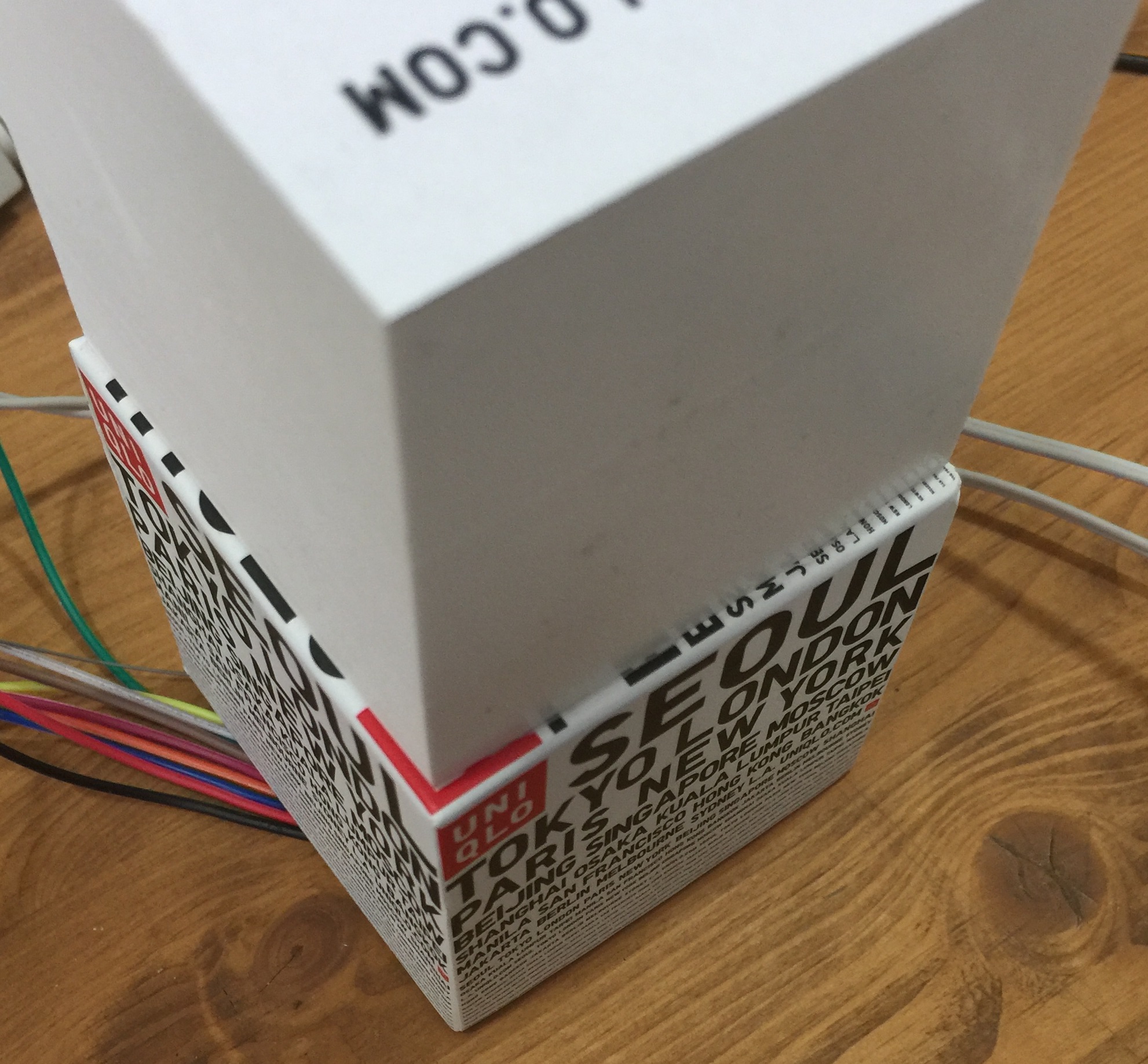

  • Hi, Prabin.
    Good point.
    I covered the custom AFE4403 module in this case. Hope this is enough to block ambient lights.
    Also, the registers are configured as
    TIA_AMB_GAIN - ambdac = 0uA
    LEDCNTRL - LED range = 00
    LEDCNTRL - LED1 = 0x00
    LEDCNTRL - LED2 = 0x00
    We expected 0 reading. However, sadly, the same thing happened.
    Then, looks like this module has some flaws, right?
    Or should I change what is covering the module,
    or change register configurations? I haven't fully understood what you've meant by "set the LED current to 0".
  • Hi David,
    Yes, looks like your module is faulty.
    Setting LED current to 0 means LEDCNTRL -LED1/LED2 = 0.
    I have following suggestions based on previous observations.
    1) Remove sensor module ( looks like you have wire connection) and check the output.
    2) If you see the same output, generate the register settings from the AFE4403EVM's GUI. You can use the default setting and try.
    Prabin
