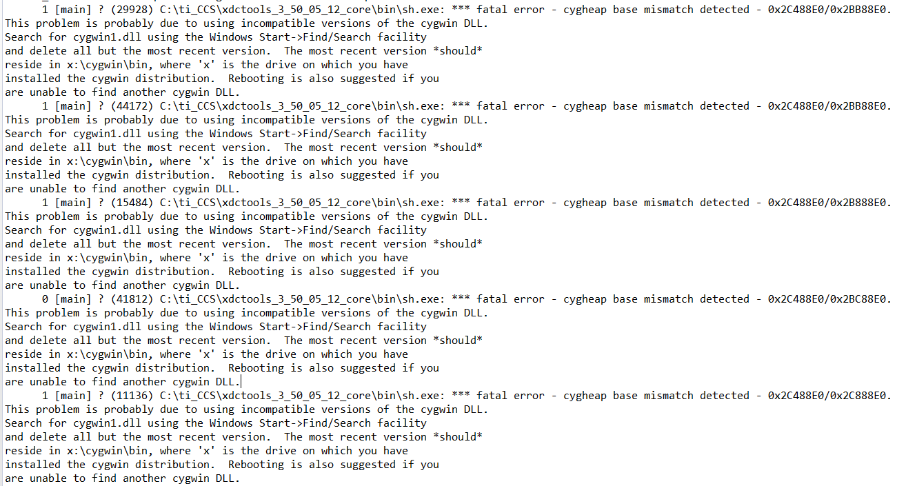

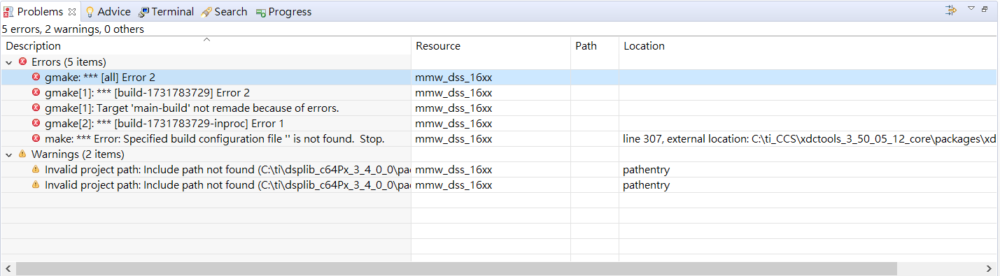

Want to build two project--mmw_dss_16xx,mmw_mss_16xx which from Millimeter Wave Demo.
However,it can't well done.Here is the Problem.
Hope someone could help me. The following is the building messages of DSS. The message also happens to MSS project.
