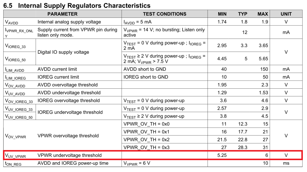

The supply input for the direct-driven topology is mentioned on page 4 of PGA460 data sheet.
Then, what are the concerns if Vvpwr_dd is less than 6V ?

Hi Kato,
You are correct that the PGA460 can detect undervoltage events if Vuv_vpwr is less than 6V. Note that if this occurs, the SRAM may still clear, and returning to a normal operating voltage from an undervoltage state may essentially reboot the PGA460.
