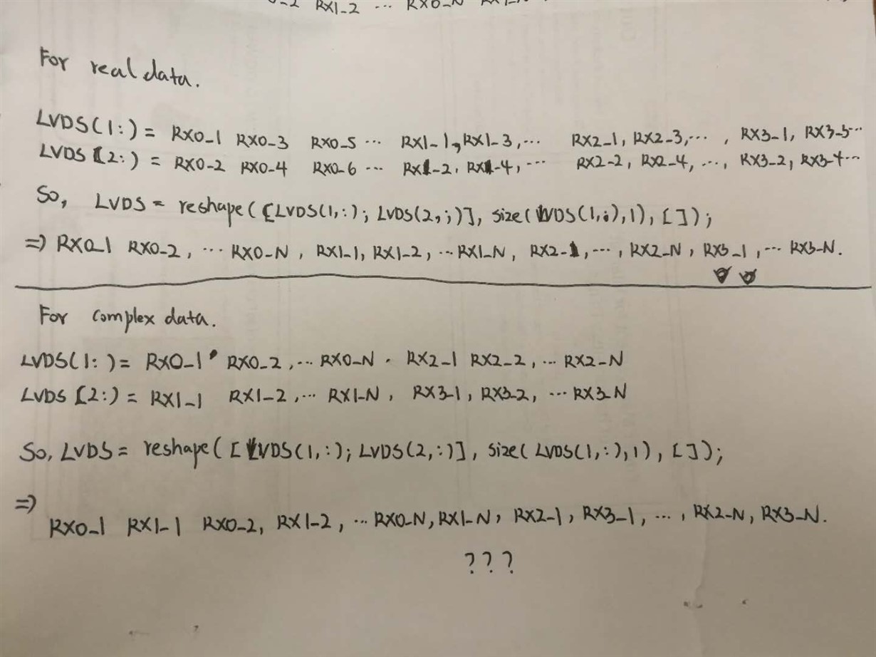

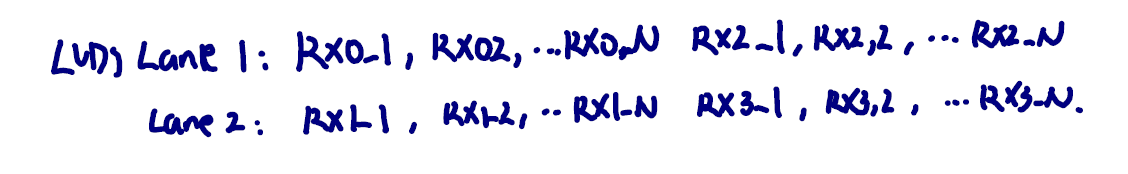

Now I am working with AWR1642 and TSW1400EVM and MMDEVpack.

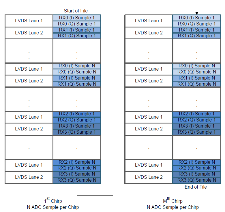

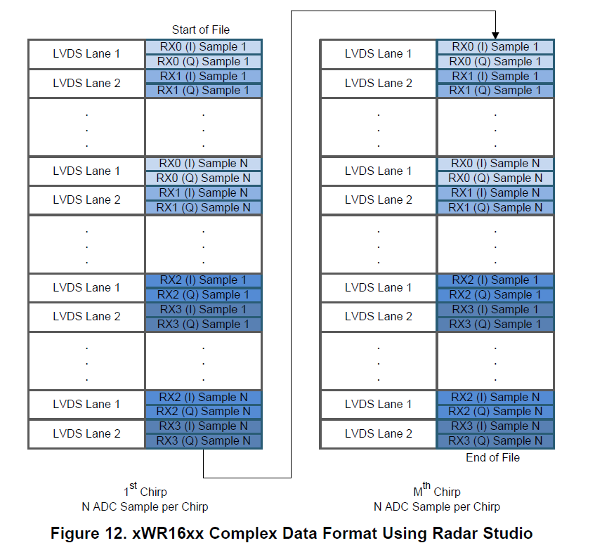

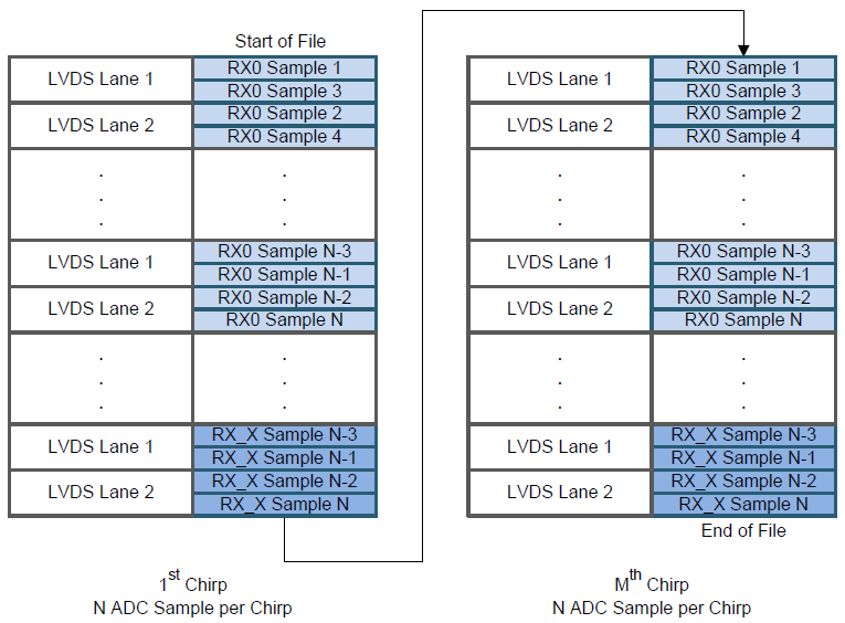

I have read the application note "xWR1xxx ADC Raw Data Capture.pdf" and analyzed matlab code. However, I have a problem about the code for AWR1642.

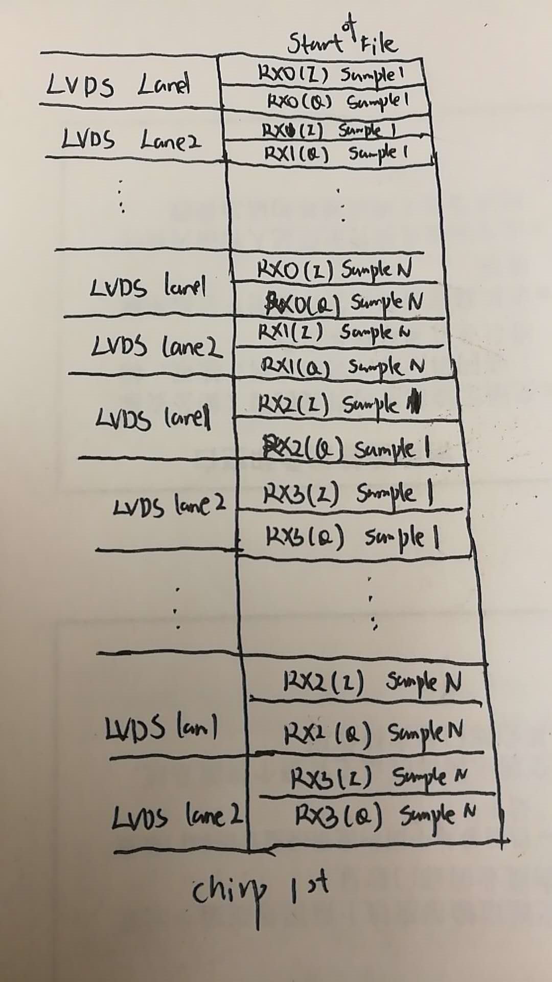

I use complex 1X mode. According to the application note, the bin format is shown,
In the code:
LVDS(1,:) = adcData(1,:) + sqrt(-1)*adcData(2,:);
    if numRX > 1
        LVDS(2,:) = adcData(3,:) + sqrt(-1)*adcData(4,:);
  temp_LVDS_data_1 =  LVDS
LVDS = reshape([LVDS(1,:); LVDS(2,:)], size(LVDS(1,:),1), []);%%% end
For example, the value of temp_LVDS_data_1 is (only for one chirp)
Each value in  temp_LVDS_data_1 is complex.
Then if we run this line:
LVDS can be described as shown:
