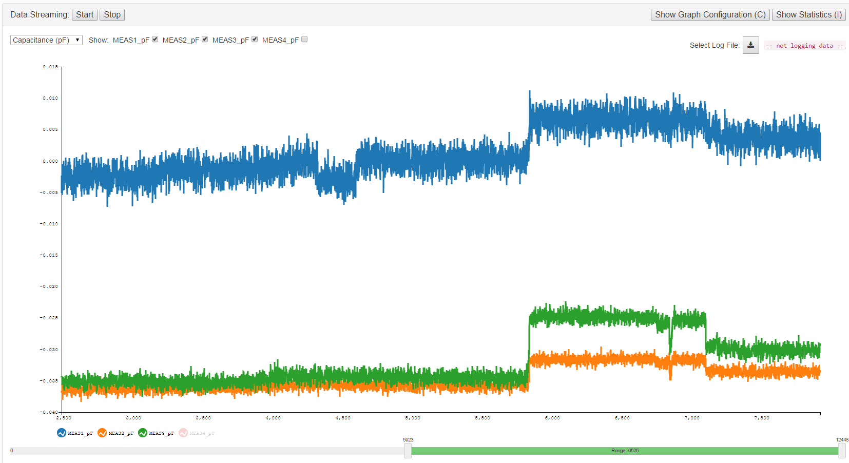

    actually I use both OoP and the conventional approch having the same issues. All measurements below were taken with Human Body more then 2m away. And the
    These samples were taken at 200ms rate with the Setup as in the App Note. CH1 for Level against CH4, CH2 for ref. in the material also against CH4 and CH3 as enviromental reference also against CH4. The chanels have been set to nearly 0 with the offset.
    For this Test i used the OoP sensor with the layout as in the AppNote:
    Inner Layer: SHD2 || CH3 on top and CH2 at the bottom || CH1 level || SHD2
    Isolation: 0.2mm nonconductive adhesive tape
    Outer Layer: SHD2 || SHD1 - SHD1 || SHD2 (the SHD1 is one big area covering all measurement electrodes.
     The Steps at around t=6000 in the graph are strange but i think one can calculate the correction with the other sensors but Equation 2 from the App Note: Level = (C_L - C_L0)/(C_RL - C_RE) is no more valid!
    But my real problem are those steps like the one at t = 4000. This one has no impact on Ch2 and CH3 at all.

    This one was rock solid in signal but every now and then the offset changes with a step like in the graph at t=4000. Ch2 stays the same.
