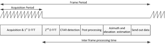

    I appreciate the details you provided and steps taken. I wanted to give you a status update so far:
    Using the chirp you attached I replicated the same issue described. (issue continued to manifest with some other chirps on both SDK1.1 or 1.2)
    Specifically, the crashing appears to be caused by the time required for the processing chain of the OOB Demo being greater than the available idle time of the chirp.
    I've attached the data path timing diagram for reference. From the figure we can see that the processing and data out via UART must finish before the next frame or an error will be thrown. At a high level we can expect that at some point if we continue to increase the FPS there will be insufficient idle time for the processing which will not scale down. The OOB demo enables chirp configurations that are valid from a radar front end configuration point of view. However, it doesn't check whether there's sufficient processing time. In this respect, this is a known issue and expected behavior.
    One of the things that can be done is to enable the Statistics options. Then in the Plots view select Profiling from the drop down so you can see some of the timing information as you make parameter changes.
    Using this strategy I looked at your chirp and have attached a configuration that appears to be stable up to the 30fps with similar scene requirements. I've attached it here for your reference. Here it has static clutter removal disabled to reduce post processing time. However, depending on your application, the number of detected objects you are observing may be much greater than my test scene. This would increase the UART time and could cause the timing deadline to be missed. Other parameters would need to be adjusted to then meet the timing requirements.
    Please let me know if this help you or if there are any follow up questions.profile_30fps.cfg

  • The quantities you are referring are mentioned in the doxygen documentation of the demo in section called "Stats Information" along with a picture. The picture Amanda quoted is in the doxygen towards the top of the document and is titled "Top Level Data Path Timing". The top level is not trying to show the detail and generally calls all of the processing involved including sending as inter frame processing and also does not show any margin left for processing. We will clean up the documentation in a future release so that there is no confusion between the top level and the stats one.
    Regarding the transmit time on UART being higher than processing time, this is not surprising depending on your configuration and visualizer settings, you can see this is mentioned in the "Limitations" section in the doxygen documentation quoted below:
