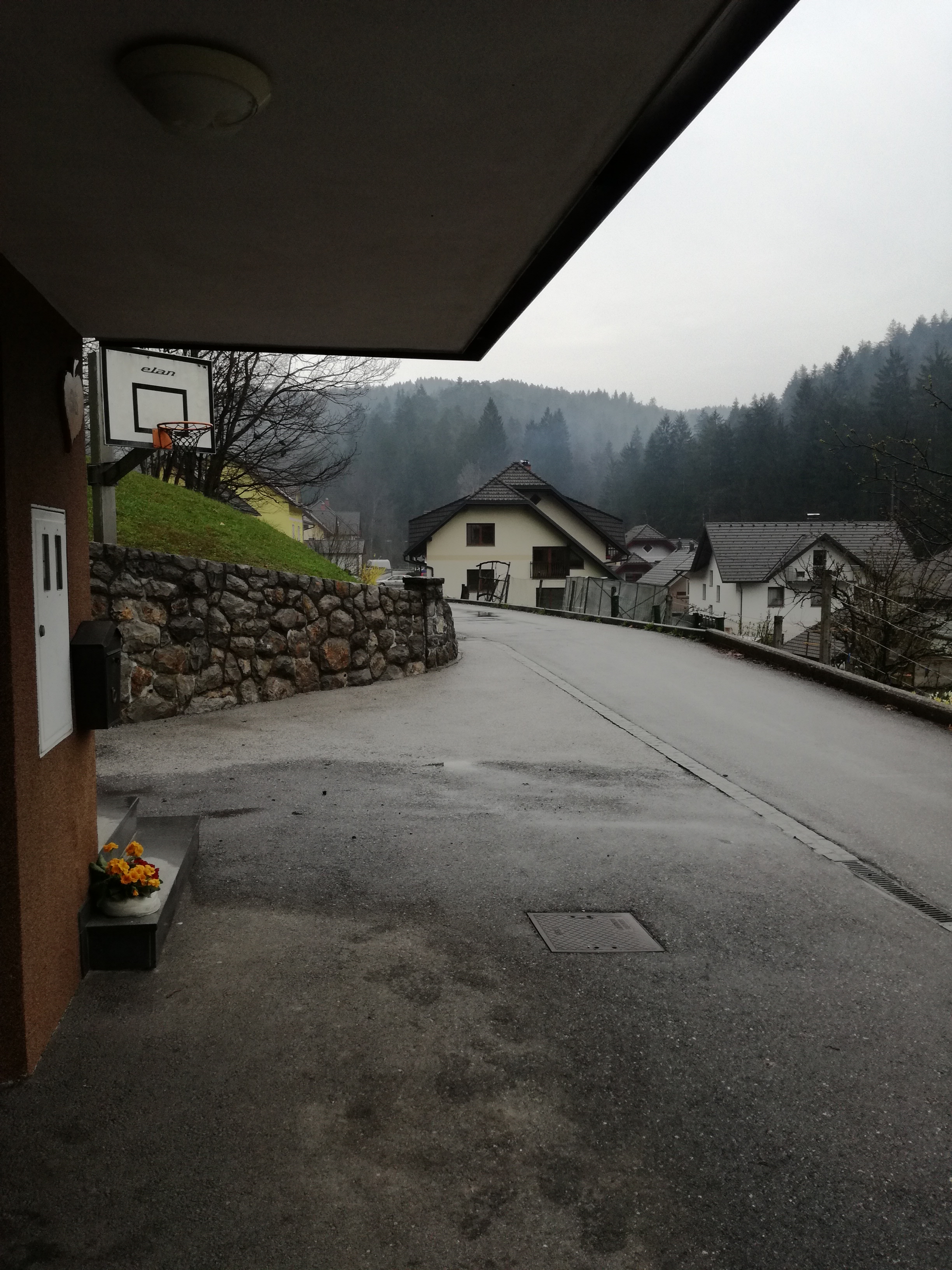

My tests were conducted with walking person holding a piece of sheet metal (74x60cm) in hands to achieve better RCS. Scenes looked like this:

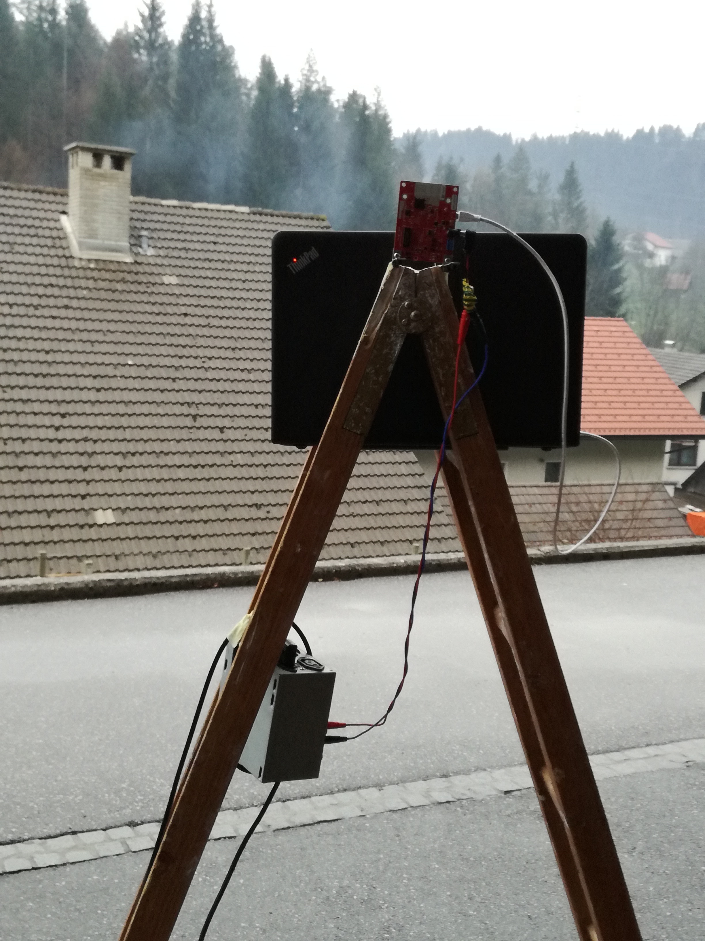

Module was mounted on a ladder (heigth ~170cm) and on a chair (heigth ~55cm) later for another test, but result was more or less the same.
I used a simple power supply made from an used PC switched-mode supply.
I tested with all three default demo configurations, but all of them failed to detect anything further than ~15m from the sensor.
Tests with demo configurations were done on an asphalt road, shown on the left picture above. I tried to tweak default configurations a little, but maximum ranges were still around 15m.

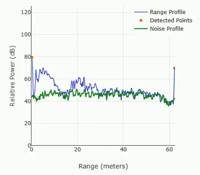

Heat maps also failed to indicate any targets moving further than 15m. I posted Range Profile below.

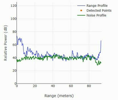

Because i thought, that i must be doing something wrong, i loaded configuration from an article http://www.ti.com/tool/TIDEP-0094 to my device. Results were a bit better, but still max range was ~20m.
Tests with a configuration from the article were done on an asphalt road, shown on the right picture above.
Heat maps also failed to indicate any targets moving further than 20m.
