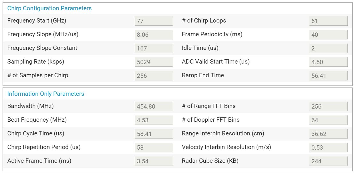

AWR1642: Modify the configurations of AWR1642 by using mmWave Sensing Estimator, but the sensor start fails !
Part Number: AWR1642
I would like to change numbers of TX from 2 to 1, and referring to the mmWave Sensing Estimator.
But sensor start fails.
My question is how to sensor start successfully by using TX=1 configuration?
Thanks.

Tx=1, sensor start fail, as follows:
sensorStop
flushCfg
dfeDataOutputMode 1
channelCfg 15 1 0
adcCfg 2 1
adcbufCfg -1 0 0 1 0
profileCfg 0 77 2 4.5 556.41 0 0  8.06 1 256 5029 0 0 30
chirpCfg 0 0 0 0 0 0 0 1
bpmCfg -1 0 0 1
frameCfg 0 1 64 0 100 1 0
lowPower 0 0
guiMonitor -1 1 0 0 0 0 0
cfarCfg -1 0 0 8 4 4 0 6000
cfarCfg -1 1 0 8 4 4 0 6000
peakGrouping -1 1 1 1 1 224
multiObjBeamForming -1 0 0.5
calibDcRangeSig -1 0 -5 8 256
extendedMaxVelocity -1 1
clutterRemoval -1 0
compRangeBiasAndRxChanPhase 0.0 1 0 1 0 1 0 1 0 1 0 1 0 1 0 1 0
measureRangeBiasAndRxChanPhase 0 1.5 0.2
nearFieldCfg -1 0 0 0
CQRxSatMonitor 0 3 5 127 0
CQSigImgMonitor 0 127 4
analogMonitor 0 0
lvdsStreamCfg -1 0 0 0
sensorStart

  • Hi Kyle,
    Thanks for your reply.
    I moified the "Ramp End Time" from 556.41 to 56.41
    The sensorStart still fails.
    Is there any detail configuration I missed ?
    Thanks.

  • Kris,
    It looks like there are a couple of issues at play here.
    The first issue relates to your chirp configuration. You need to increase the idle time to at least 3 us or higher. The current idle time does not allow enough DFE spill time. There needs to be enough time between chirps for the VCO to ramp down and settle before sending out another chirp.
    The second issue relates to your frameCfg command. The first two arguments in the frameCfg command specify the start chirp and end chirp for your frame. However, in your current configuration, you only create a single chirp designated to profile 0. Therefore, you cannot specify an end chirp of 1 as you do in your configuration as you have not defined a chirp for profile 1. Either create a second chirp for profile 1 or change the arguments so the start and end chirp are both set to 0.
    Kyle
  • Kris,
    After some further analysis, I have come up with the following set of CLI commands for the chirp and frame configuration you are going for:
    sensorStop
    flushCfg
    dfeDataOutputMode 1
    channelCfg 15 1 0
    adcCfg 2 1
    profileCfg 0 77 2 4 56.4 0 0 8.06 0 256 5029 0 0 30
    bpmCfg -1 0 0 1
    frameCfg 0 0 64 0 100 1 0
    lowPower 0 0
    clutterRemoval -1 0
    analogMonitor 0 0
    sensorStart
    Using these CLI commands, now the only issue that is raised is from the DSS. Specifically, the exception raised is "Extended maximum velocity technique is supported only in TDM MIMO." This exception is raised because only a single chirp is defined. A second chirp would need to be defined while enabling a different TX transmitter than the first chirp.
    Kyle
  • Kris,
    Here is a set of CLI commands that should work and address the TDM MIMO issue raised in my previous post. Please let me know if you have any questions. These commands have been verified on AWR1642 using SDK v1.2
    sensorStop
    flushCfg
    dfeDataOutputMode 1
    channelCfg 15 3 0
    adcCfg 2 1
    chirpCfg 1 1 0 0 0 0 0 2
    bpmCfg -1 0 0 1
    lowPower 0 0
    clutterRemoval -1 0
    analogMonitor 0 0
    sensorStart
    Kyle
  • And if you're looking to only use a single TX, then this set of CLI commands would work:
    sensorStop
    flushCfg
    dfeDataOutputMode 1
    channelCfg 15 1 0
    adcCfg 2 1
    bpmCfg -1 0 0 1
    lowPower 0 0
    extendedMaxVelocity -1 0
    clutterRemoval -1 0
    analogMonitor 0 0
    sensorStart
