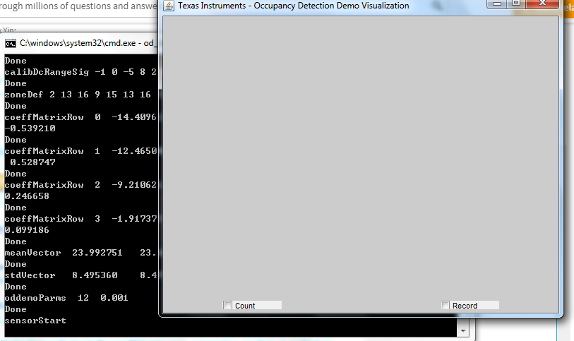

With IWR1642BOOST EVM, I am trying to run "lab0003_occupancy_detection" that is included in "mmwave_automotive_toolbox_1_2_0".
I followed the user's guide PDF document.
When running the GUI (od_demo.exe), the GUI did not run properly with below "timeout" warning messages.
(Only a blank Visualization Window GUI pop-up happened, with no heat map update..)
The same issue happened with pre-built binary image too.

So, can you check if the ODdemo can run properly on your side?
Hayden
    Have you been able to run any other demo on this EVM before?
    It seems that there is a problem with the UART communication
    thank you
    Cesar
    Yes, other demos are working well.
    Thank you.
    Hayden Kim

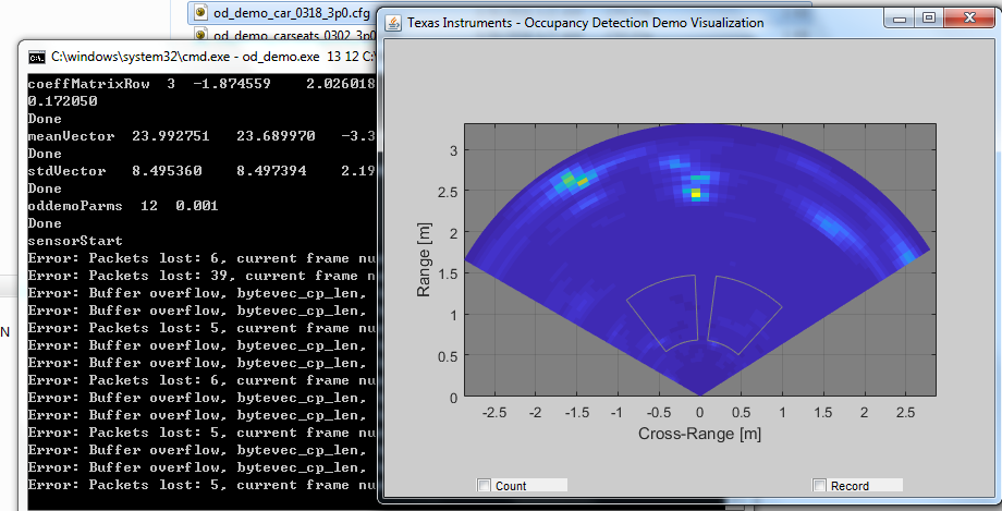

    I run the demo on my IWR1642 BOOST, faced the same issue.
    My board has run the mmw demo, people counting, SRR and vital demo successfully, double confirmed the port is correct. OS is windows 7.
    Need your help to fix the issue, thanks.
    Andy
    Actually, I still have the issue with my IWR1642 board.
    I have plan to try with AWR1642BOOST board.
    Hayden
    I tried on AR1642 BOOST, the cfg can be sent to the EVM well as below, and the LED DS3 is lighten which should indicate the application run well, but nothing display shown as below figure~. Can anyone help check why it is different for IWR and AWR1642 EVM, and how to fix the below no display issue, thanks.

  • Some update, test on AWR1642 BOOST there is result display on the visualizer only with the od_demo_car_0318_3p0.cfg, and lots of buffer overflow warning, while no result display if using the other two cfg files. Look forward to your help make the demo more robustness.
  • That's a good progress.
    Thanks for your update.
    Hayden
    I think this issue is related to the performance of the WIndows Laptop.
    The matlab GUI requires certain processing power. If the Windows Laptop is not powerful enough, frames will be dropped because the Windows Laptop Host can't keep up with the target
    thank you
    Cesar
  • With respect to IWR1642 vs. AWR1642, the only difference I'm aware of is the CAN interface. This demo does not use CAN.  An interesting experiment would be to edit the DSS and MSS projectspecs, replacing AWR with IWR (there are multiple occurances), then reimporting, rebuilding and reflashing the resulting .bin on the IWR1642.

    I agree with u about the difference between IWR AND AWR1642, and cannot understand the issue. Have u ever tried the demo on IWR1642, if not pls try and fix it as lots of customers maybe get the IWR1642 EVM.
    Another issue mentioned in my last post that only running od_demo_car_0318_3p0.cfg can get visualizer output, while no output if using other two default cfg, have u ever faced same issue and how to fix it? Is it also caused as CPU power or performance is not strong?
    Andy
  • >Another issue mentioned in my last post that only running od_demo_car_0318_3p0.cfg can get visualizer output, while no output if using other two default cfg,
    If you diff the .cfg files, you will see that the chirp parameters are identical.  The only difference is that the training coefficients are tuned a bit differently. This could not be the cause of no output.  If you haven't made any changes to the config (like changing what is output via the guiMonitor command) my guess is that maybe you aren't giving it enough time to start up.  If you have Matlab 2017a installed, you could try running the demo interactively by giving the same command in Matlab's command prompt.  It seems to startup faster in Matlab.
    If it still doesn't seem to start, you can send the config file directly to the AWR1642 via a UART terminal, and have a second terminal open to respond to the data COM port.  If you get bursts of data on the data COM port, it will confirm whether or not the AWR1642 is sending frames once started.
