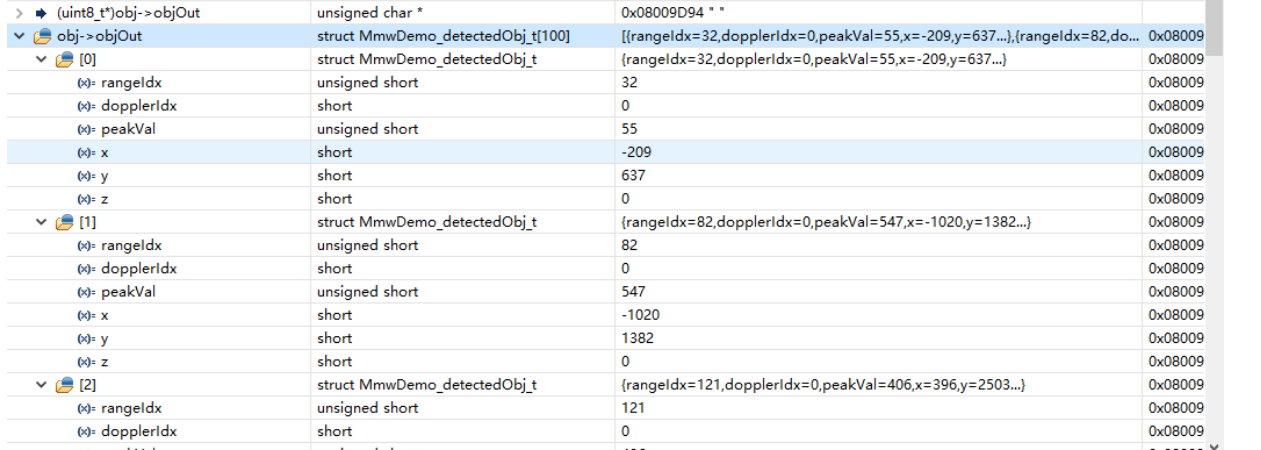

IWR1443: What is the unit of x=-209,y=637 in the picture? How to convert into meters?
Part Number: IWR1443
Hello,please,What is the unit of x=-209,y=637 in the picture? How to convert into meters?
    This is the define of the X,Y,Z.

        int16_t  x;             /*!< @brief x - coordinate in meters. Q format depends on the range resolution */
        int16_t  y;             /*!< @brief y - coordinate in meters. Q format depends on the range resolution */
        int16_t  z;             /*!< @brief z - coordinate in meters. Q format depends on the range resolution */

  • Hi Wesley,
    Q format depends on the range resolution. After the experiment, I found that when the range resolution is 0.04, X/Y/Z is expressed in Q9 format; when the range resolution is 0.3, X/Y/Z is expressed in Q7 format; when the range resolution is 0.977, X/Y/Z is expressed in Q5 format. So what is the relationship between Q format and range resolution? Is there any law?
    Thanks~
    The converting formula is as follows
    xyzOutputQFormat = (uint32_t) ceil(log10(16./fabs(rangeResolution))/log10(2));

    The formula is located in C:\ti\mmwave_sdk_01_01_00_02\packages\ti\demo\xwr14xx\mmw\main.c
                dataPathObj->xyzOutputQFormat    = (uint32_t) ceil(log10(16./fabs(dataPathObj->rangeResolution))/log10(2));
