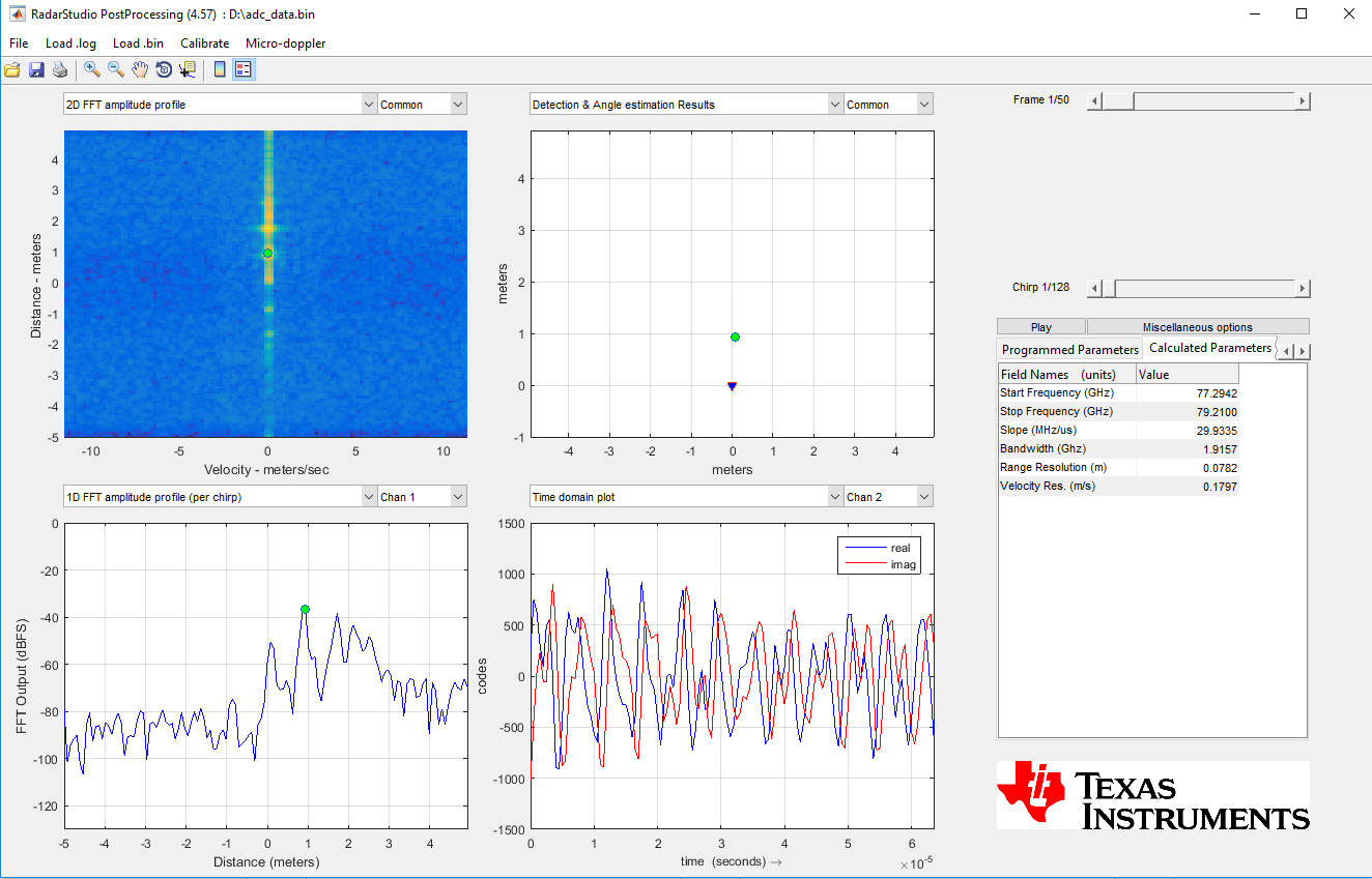

1. My configuration should be for ~10m. When I am moving an object in front of the sensor (not to fast), I see a very strange behaviour.
Event though the object is not to big (~20cm deep), there are peaks in many other range bins. The object is at ~1m and moving to and away from the radar. I see peaks from -2m to +4m. How can this be explained? What can I do against this?
Please take a look at following screenshot.
Object is not moving:

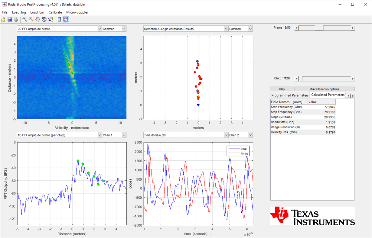

Object is moving:

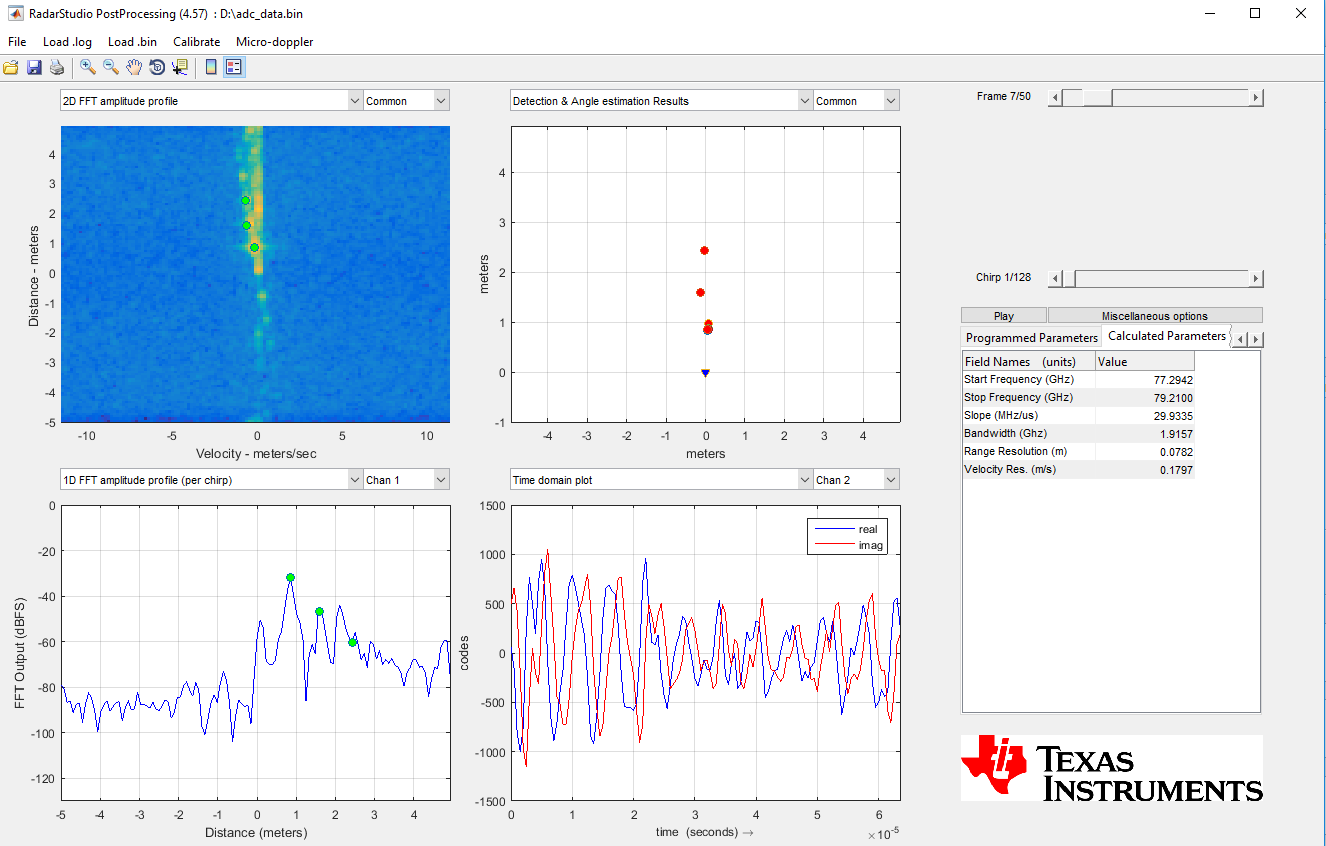

Object still moving in same direction:
Object is moving in other direction:
The "diagonal line" in 2D matrix is moving like a "windmill" from one side to the other (depending on moving direction).

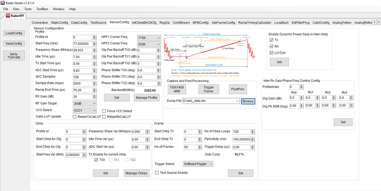

2. From my calculations, the unambiguous range should be 10m. Why is the range area from -5 to +5m ?
Equation for d_max is: d_max = (f_sampling * c) / (2*Slope) = (2000kHz * c) / (2* 29.933 MHz / us) = 10.0154 m
I attached a screenshot showing the sensor config I used:
3. Last question: I wanted to use a sampling frequency of f_s = 2000 kHz, n_samples = 128 and a Slope of 29.933 MHz.
The Ramp Timing Calculator then caluclates a idle time of 5us. When I tried this value in the RadarStudio SensorConfig, the RadarStudio gives me an error:
"MAXIMUM DFE SPILL TIME > PF_IDLE_TIME_CONS". I increased the idle time to 7us and everything worked. But I think there is a bug in the RTC. Or did i do anything wrong?
