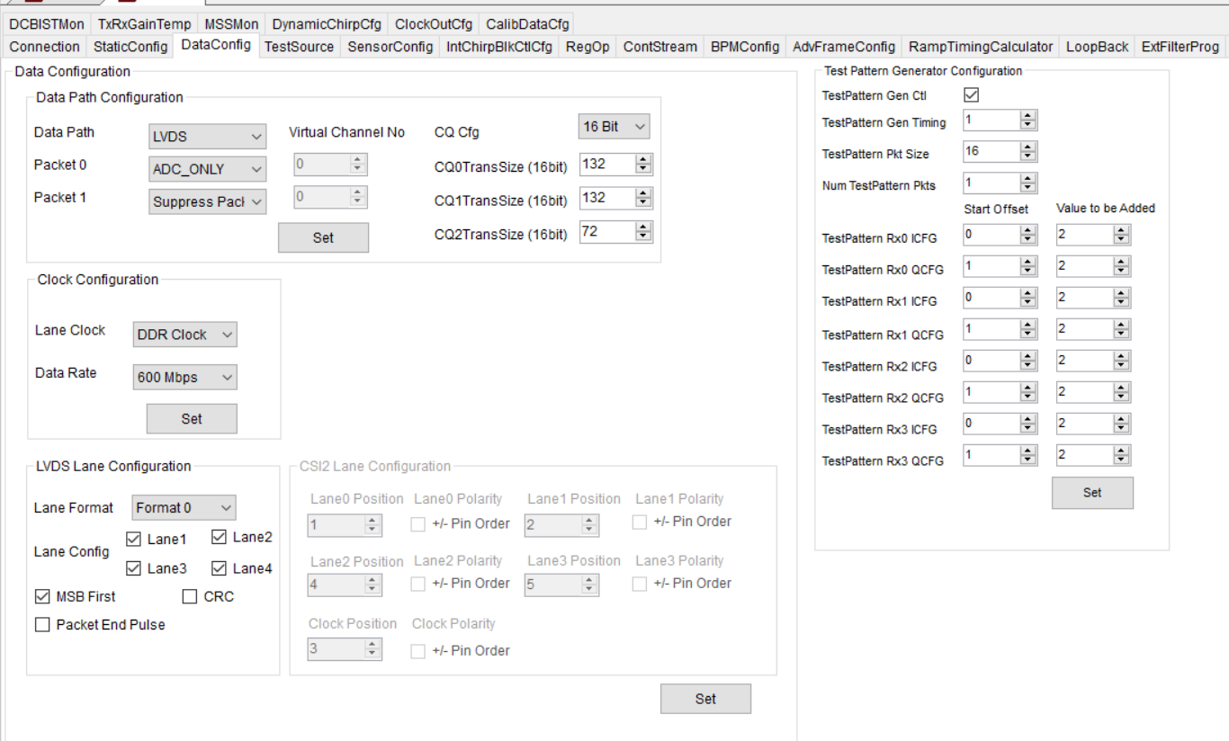

1. I tried to use the test pattern generator to generate standard data over LVDS. But the output window says "CRC FAILED". The screenshots are as below:
I would like to know why this error comes and how to rectify it.

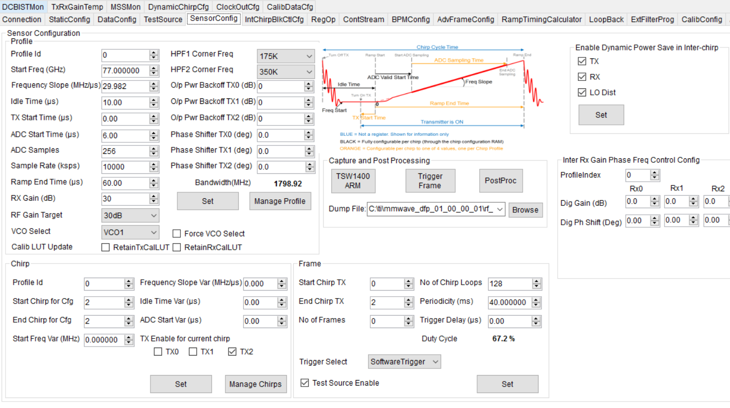

2. In the Sensor config tab,  After all the setting is done, I click on the "Set Up TSW1400" button. followed by "TSW1400 ARM", Then "Trigger Frame". No capture happens.

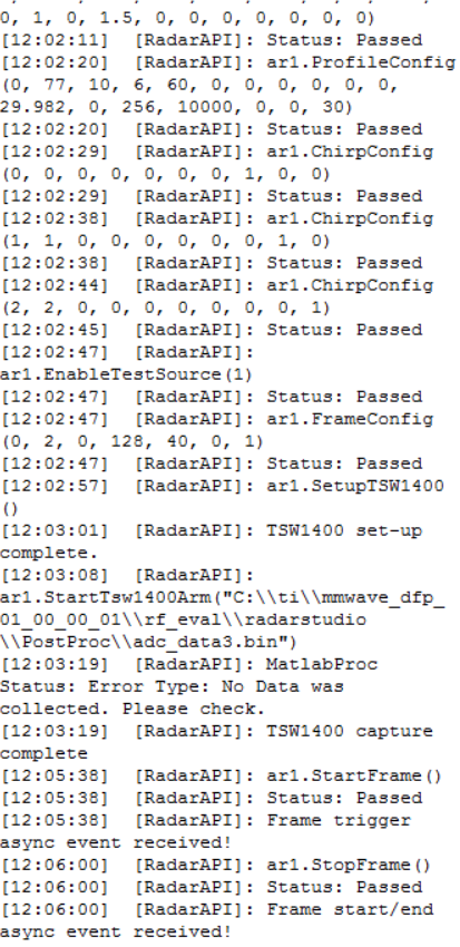

From the Output window, I see that When I press the ARM button, it looks for already captured data and says "No data collected". I have to repeat the ARM and trigger frame buttons multiple times beofre the HSDC pro starts capturing.
The next major problem is I am not able to stop the capture (No button press in radar studio helps) and the data doesn't get copied to the bin file. I have to power off the board and if I am lucky, some data(not all) gets copied to the bin file occasionally.

    Regarding the Q2, i see that there are 2 major changes. One, Number of frames is set to a finite number. and Only 1 Tx is initialized. Is that the case?? Are these 2 conditions necessary for Radar Studio to work properly??

    Let me get back to you on question 1, I will have to test this and see if I encounter the same error.
    Regarding question 2, try setting the number of frames to a finite number. The TSW1400 is not supposed to be used with an infinite number of frames. The issue where you have to press the ARM and Trigger frame buttons multiple times before it starts capturing is a known issue. Unfortunately, there is no known solution for this issue.

  • Hi Adrian,
    Thank you for your suggestion. Your solution for Q2, resolved my issue.

    Regarding Question1 , I look forward to the answer as we are looking to test LVDS interface in our custom boards.
