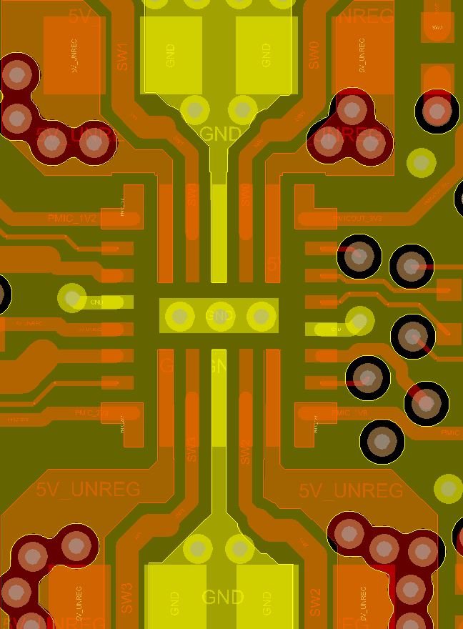

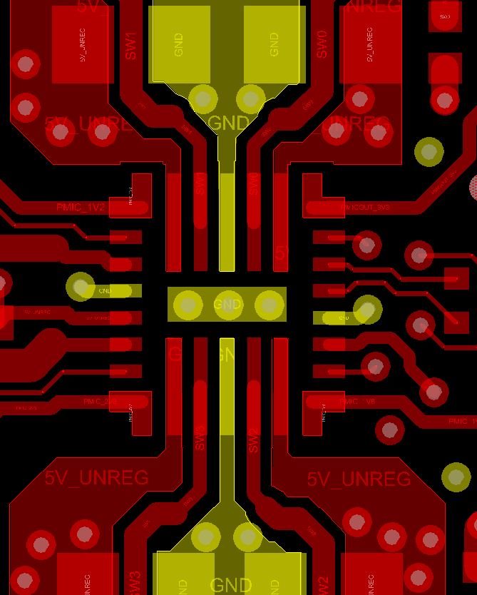

There are some rectangular cut on the layer (GND) under PMIC device, any one know the purpose of those cut? Can you give us the exact position of them?

The PMIC layout guidance is shown in the LP87524B datasheet. There are Cadence Free Viewers to measure distance on the layout.
I have attached two pictures from the bottom. L6, and bottom + GND L5, L6.
L5 holes are the vias from L6 to other areas.
L6 there are no cuts,
Please see attached JPGs.
