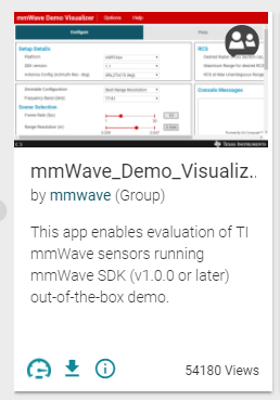

  • Kalyan,
    You can also download an offline version of the mmWave Demo Visualizer
    Selected the downward facing arrow located at the bottom of the tile will allow you to download an offline version of the visualizer. You will need to make sure you also install the GUI Composer runtime. A link for that runtime will be available when you hover over the download icon.
    Kyle

  • Kalyan,
    I was merely responding to the question you asked "Is there a possibility to download the mmwave demo visualizer offline?". That was the purpose of my response. And yes, I just included a snapshot from the website. The image does not link to our GUI Composer Gallery. You will have to go to that website to download it.
    As to the issue you are currently seeing with our dev.ti.com/gallery website, we have been experiencing issues with this site today. I will reply to this thread once it is back up and running.
