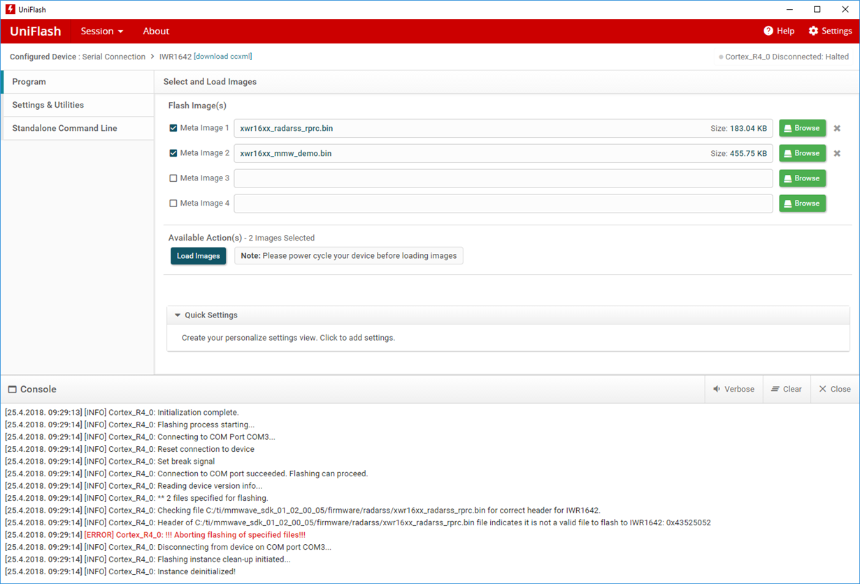

Hello.
I'm trying to run the traffic monitoring demo. I'm following the steps from traffing monitoring Setup Guide. I try to flash wih the relevant bin files. But when I start the flashing process it crashes. The bin files I try to flash and the following error are represented below
How to fix this error and launch traffic monitoring demo succesfully?
  • Hi Andris,
    For IWR1642 devices you need to have the mmw_demo.bin file in the Meta Image 1 slot and then nothing else in any of the three other slots.
    Cheers,
    Akash
