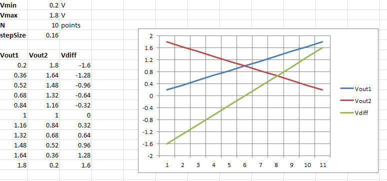

Can one increase the sensitivity by using '2' Hall-Effect sensors (DRV5053) back to back (opposing slopes of mV/mT), with '1' magnet on one side of these sensors?
    Yes. The example below shows that the differential output of two sensors with opposing slopes would give you twice the gain as the individual sensors over the same input range.

    It is my understanding that the Magnetic Flux density will be reduced (by a value equal to F = qvB.Where the Force 'F' results in a hall voltage Vh.This Force is halved due to the fact that  '2' sensors are used back to back (for a given, common magnetic field).
    Not true.The flux density at a point is independent of the number of sensors measuring it. Both sensors will experience the same force and produce output voltages determined by their respective transfer functions.
